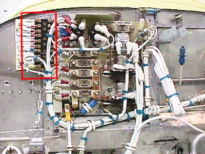

[img]cid:776342221(at)02122014-0CF9[/img]
  The last time I was able to walk down the A36
  production line (about 10 years ago) the clipped-in
  fuses for various 'minor' tasks were quite visible.
  The need to extend the bus to accommodate the only
  circuit breaker in the airplane was a special case.

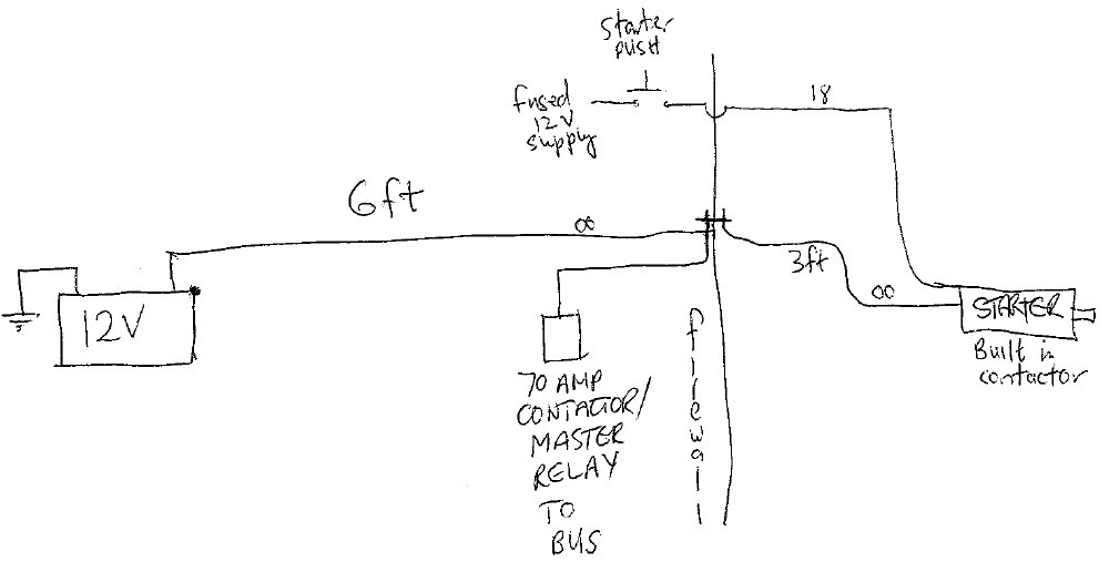

PostPosted: Mon Dec 08, 2014 3:09 am    Post subject: Fusible links NOW VARIATION ON A THEME Reply with quote
Correct Bob N, I have only a 70amp relay to feed the bus.
[img]cid:ii_14a299527e8e76da[/img]
Best...
Bob Verwey

PostPosted: Mon Dec 08, 2014 8:12 am    Post subject: Fusible links NOW VARIATION ON A THEME Reply with quote
BobV,
The rule of thumb is to keep the fat wires that are bolted directly to B+ as short as possible. My personal rule is less than 18 inches.
Is there a reason not to add a traditional start solenoid right at the battery? In your case is may be redundant but it keeps the un-protected feeder length short. You would have to move the master relay to that position also - so that's another few feet of #4. This is probably less expensive than the manual disconnect & it keeps the big starter cable inert except during cranking.
-Jeff

PostPosted: Mon Dec 08, 2014 8:56 am    Post subject: Fusible links NOW VARIATION ON A THEME Reply with quote
Oh yeah, I seem to recall this condition from an
earlier thread . . . one of the 70A rated plastic
relays with fast-on tabs?
You're probably aware of the variances in your
system when compared with the legacy design
philosophies harvested from the TC aircraft world.
One of those ideas goes toward making ship's wiring

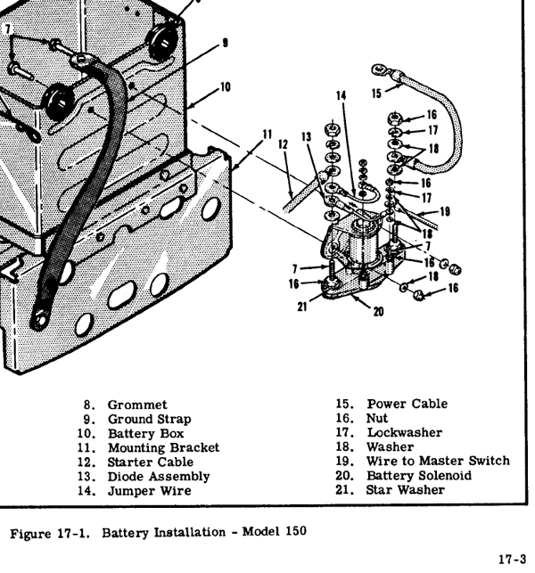

max-cold when crew operated controls are placed
at OFF. This generally calls for placing disconnects
in major conductors (meaning protected at more than 5A)
as close to the source as practical. Hence the oft repeated
picture below (Cessna 150 1962 and before) where
we see the battery contactor mounted right on the
battery box.
[img]cid:.0[/img]

So, I've been digging up service and parts catalogs
on the older Cessnas. The image above was captured
from a 1962 and prior service manual were we're
shown a Cutler-Hammer 6041 style contactor used
as a battery contactor. I'm discovering that the
wine-barrel RBM controls devices familiar to me
came along sometime in the early/mid 60's. The
oldest airplane I've flown fitted with an electrical
system was a '46 120-1/2 . . . the system was
added after it left the factory . . . I think
it had a wine-barrel battery contactor. Didn't
need a starter contactor (had cockpit pull-
handle, mechanical engagement).
