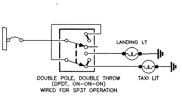

How can I wire a single dual pole switch to control 2 fuel pumps, only one of which can operate at once with the switch being off bottom, pump 1 middle, pump 2 top. I also need each pump to have an independent power source. I thought I could do it with a 2-1, but I can only get it to go on-off-on. Is there a dual pole switch that will accomplish this?

What you want to do is achievable (I believe) with a 2-10, which is an ON-ON-ON - 2 Pole - so wire as you will
see here:

   As John mentioned, you can wire a =10 style toggle
   switch to offer single pole, three position functionality
   as described in chapter 11 of the 'Connection.
   Here is one example of this technique.
[img]cid:7.1.0.9.0.20141217104722.01fca940(at)aeroelectric.com.0[/img]
   A single-pole, three position, center-off will
   work too . . . but this makes the switch different
   from all the rest in that OFF is not fully down
   but mid-position.
   Charlie's question goes to the notion that if
   you have two such pumps, then we assume that one
   must be operational at all times to keep the engine
   running . . . hence a spare pump. If this is
   true, then consider the fact that the pump
   can fail to work for a host of reasons . . .
   broken wire, bad switch, blown fuse, etc.
   If one pump circuit goes bad and pops the fuse,
   then the single failure may take down both
   pumps.
   The legacy failure mode effects analysis
   suggests that the two pumps are best installed
   as totally separate entities with dedicated
   switches and power sources.
I think he spec'd separate power sources for each pump. But a mechanical failure (cracked housing allowing the switch to fall apart, etc), while admittedly rather low risk for a quality switch, could still take out both pumps.
