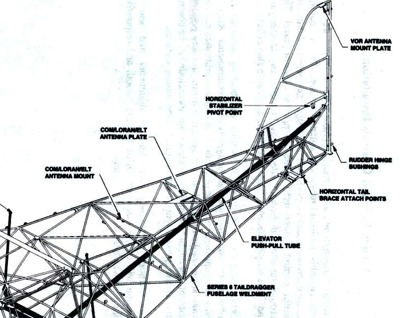

Does this installation have a service history? Are there
exemplar installations flying? The first Kitfox structure
image that popped up in a search looks like this . . .
[img]cid:.0[/img]
If this is applicable to your airplane, where is the antenna located
with respect to the metallic structure of the vertical fin? I'm
puzzled as to how an antenna 'buried' under the fabric can
enjoy the necessity for a relatively 'free' view of the
universe in all directions around the antenna. An antenna
mounted in close proximity to the metallic structure of this
fuselage would be first seriously detuned from it's design
frequency and second, suffer severe distortion of radiation
patterns. It would be interesting to see what kind of SWR
measurements you get from such an installation.
The drawing above calls out an antenna mounting feature
that would offer a best-compromise location for your Comm
antenna.

It is NOT the location or lack of ground plane causing the feedback. It
is most likely one of the coax connections.
On 2/12/2015 6:25 PM, danielj.billingsley(at)yahoo.com wrote:
Bob, Thanks for the good information. To answer a previous question
you had...The antenna IS mounted inside of the vertical stab. I did
not put a ground plane on it but rather (as mentioned earlier) took
the ground to the tube frame. The only reason I configured it this way
was because a buddy with the same Kitfox model mounted it this way and
it has performed for him very well. With my Ham background, I knew the
ideal install would be with that ground plane, however, fitting a
ground plane of any size perpendicular to the antenna is not possible
where the antenna is currently at. The antenna itself is not
accessible...only the connections to it. I have been using a headset
that has ANR capability, but I was using it without the ANR. Every
time I turned the ANR feature on, I got the same RF noise. I was
hoping that the new Bose headset would work but it is the same issue.
The ferrite bead trick has made it operational, but like you said it
is only masking the issue. I suppose I will end up mounting an antenna
behind the turtledeck with a proper ground plane for the fix. Thanks
to all who assisted with this problem.
