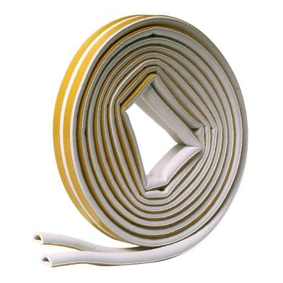

Hello Fabricio, Shop for M-D Products 02576 white P profile tape.
OC

Also comes in black which I am using.  I stuck the weather seal on the door and not the opening so it would be out of the way when entering and leaving the cockpit.
To seal the bottom edge of the doors you will need a larger type weatherstrip.

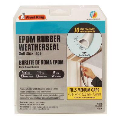

I used Frost King V25W EPDM weather stripping. It is very inexpensive, seals well and fairly long lasting.
http://www.amazon.com/Frost-King-V25W-Weather-Strip-Inch-by1/dp/B000B4N3OA
The glue they have doesn't work well so I use silicone sealer as the glue. Holds it tight but you can remove it later if needed.
