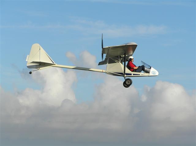

Larry:
You and I are about the same dimensions... and I have a FS II.
While I don't have a picture of my seat configuration, I'll offer this:
Refer to the attached in-flight picture.
Bill Sullivan is correct about sitting upright when the tail comes up to flying stance.
and
Assuming that you are average proportions for 6'2" (legs & torso) you may encounter a problem (minor) with your knees sticking up. I tend to fly with my legs flayed to the outside to give maximum throw of the stick for the ailerons. As you can see in the picture, I don't have/need a full enclosure.
The remedy for this situation would be to reconfigure the seat to move it back. The biggest issue in doing this would be to move the tube that runs horizontally behind the seat back. While it does serve the purpose of being a stop for the seat back, its primary purpose (according to Dennis Jackson, Kolb's master welder) is to minimize the collapsing of the cage should it opt to become a lawn dart.
One thing that helped a little was to reduce the padding in seat (both bottom and back). I replaced the foam the builder had use with the 1" memory foam. Probably only gave me an additional 1/2" to 1" in both pieces, but every little bit helps.
Also gave consideration to moving the rudder pedals forward, but with size 13 shoes, there's only so much room in that nose pod.
Bottom line, the near standard configuration has not been a problem for me and I've been flying this FS II for over 10 years. If you are planning to do a lot of cross country with 2-3 hour legs, your results may vary.
Here is the link to a YouTube video with the camera mounted under the wing. May be able to see how it is. As the Turtle Man would say..... "Live Action"
https://youtu.be/dOte07vGiEg
