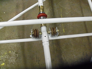

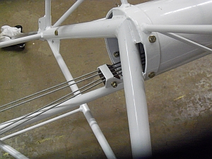

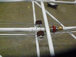

Hi KOLBERS as you may know i am building a handicap Kolb Firefly . it id the second Kolb Ivhave buit my firstwas a Fiestar fat and fast .I have a request does anybodyvhave a picture of thier Firefly cables after they leave the stick and rudder pedals they go overfour pulleys then under four pulleys then into the fusalage tube .My prblem is thwt ill
cant find a plan or an explanaton of how the first four are rigged TRAVIS has sent me plans and a new construction kanual as I.had to move my roject from Fl. To Ma. And somehow it disapeared Travis said they use washrs to pace them but the angle seems wrongvthe cables don travel strait over the pulley when you run them throughvth next set so a PIC or two would help a lot TRAVIS Said tha BRIAN changed the design since the plans were drawn?Thankq you CHRIS DAVIS

Go to page 7 of this list and open Kolbd detail photos. Pictures of stick connections, turn buckles and boom pulley.
stuart(at)harnerfarm.net
PostPosted: Sat May 16, 2015 7:09 am    Post subject: firefly cables Reply with quote
Here are some greatly reduced images. Hopefully they are what you need.
If you want to see the original files email me directly and I can send them to you. They are about 1.5 MB each.
Stuart

Stuartthank you for the pics they are very clear Ithonk that I can nloe them up on my compiter I have A wuestion the two brackets tjay hpld the pulleys Arethey parrilell. To the cross bar?Mine appear to be at about 26-30 degreeup on the outsideand that seems to be the reason that the cables dont run true to the pulleys .I will check out your picms on the big screen a.d if I cant figure it out i will write you off list and ask you to send me the full original files . Thanks again CHRIS

Chris,
Not they are not parallel to the tube, they are angled up a little.
I had some trouble getting the pulleys into the bracket. Bryan at the factory said it was fine to “bend” them a little to get things to line up. I also had to use different bolts that were called out in the plans.
A bit of a trick figuring it all out, but it worked fine in the end.
Stuart
