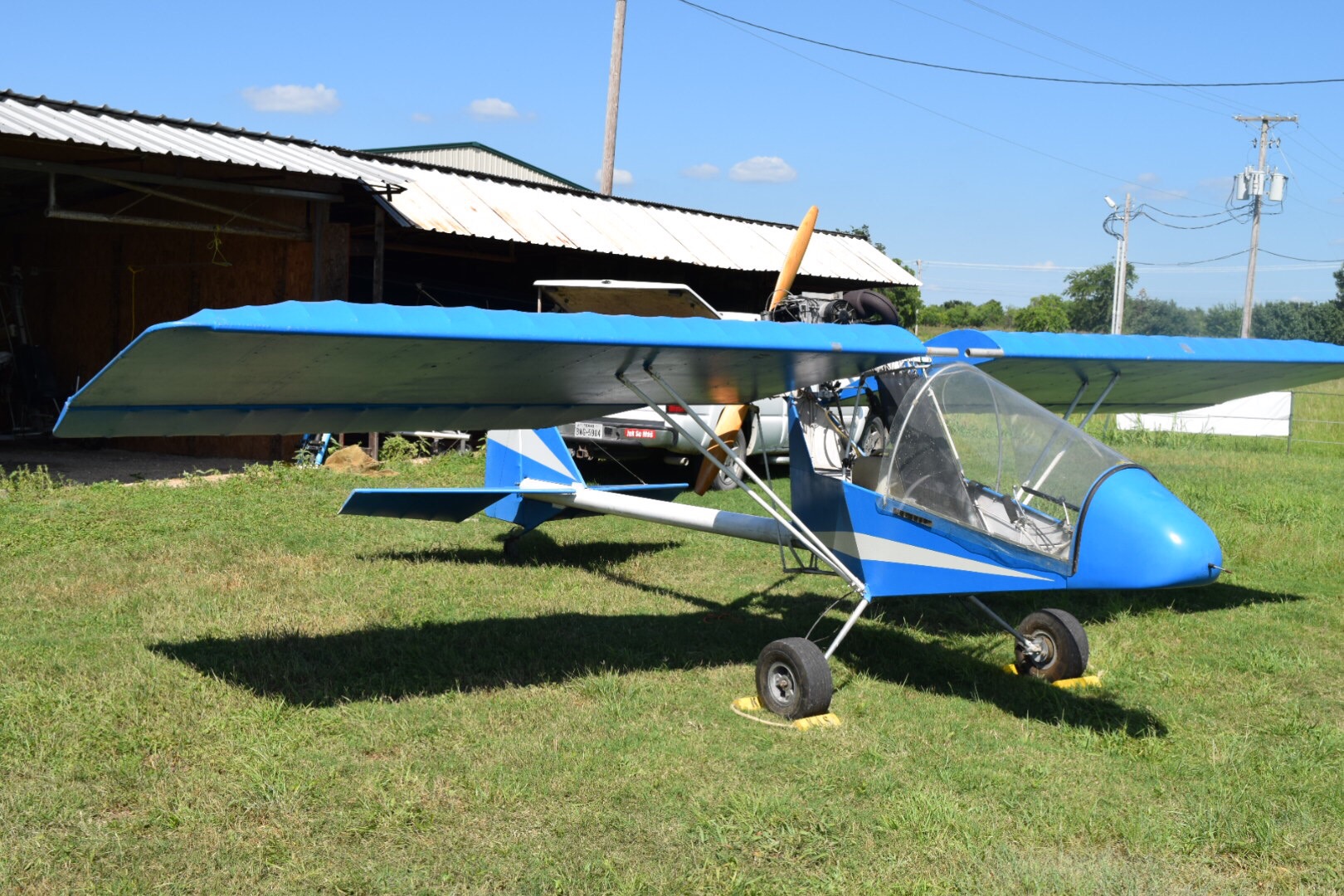

I wanted to introduce myself, name is Keith and I live in central texas. I have 40 hrs between a cessna 152&172 but lost my medical while I was preparing for PPL oral and check ride. Well that was a year ago, a couple weeks ago I bought a part103 legal firefily! So far it seems to run pretty well, i have only done a few high speed taxis but it seems to get squirly rather fast. I have been pretty hesitant to fly it honestly, every time i go to the grass strip its based at I am determined to crow hop it. Then once i try i get nervous at how squirly it is. The tail wheel configuration is pretty foriegn to me! I suppose their is no reason to rush! If you guys have any tips I would love to hear them!

Different topic: I assume you have a gap seal for the area between the wings but simply took the picture without it? And that you had it installed when you did your high speed taxis? Because a Kolb with no gap seal is not a happy experience. Just checking.
Now go find some taildragger dual and everything will be lovely.

Nice looking bird, Fireflys are great flying craft.
Easy on the controls, they are very responsive. Remember you will be using left rudder on takeoff and climb, not right like GA aircraft.
Fly it right down to the grass before you flair as these baby's slow down super fast when you flair. Don't want to drop it in.

That full shield is nice. I put one on mine and cruise speed is up 5.

I've got to second the lack of the gap seal in the center section of the wing. It may not affect the ground handling much but would certainly not help in the air. I've read a couple of posts which indicated that performance was very noticeably degraded without it. I also did not see the rudder trim tab that is in the build plans. Maybe the camera angle? I tried my firefly with and without. Ground handling was terrible without it especially on takeoff. Once I installed it (stock size and deflection as indicated on the plans), my ground handling problems went away. She tracks straight as an arrow now.

I do have a gap seal that is not pictured. My plane does not have a rudder trim tab. It didnt come with a manual or full set of planes either. A trim tab sure woud be nice! I still havent taken it up yet, tonight i am going to check the camber and try to give it a go. I will probably skip all the high speed taxi's and and attempt a simple 3 point landing Confused

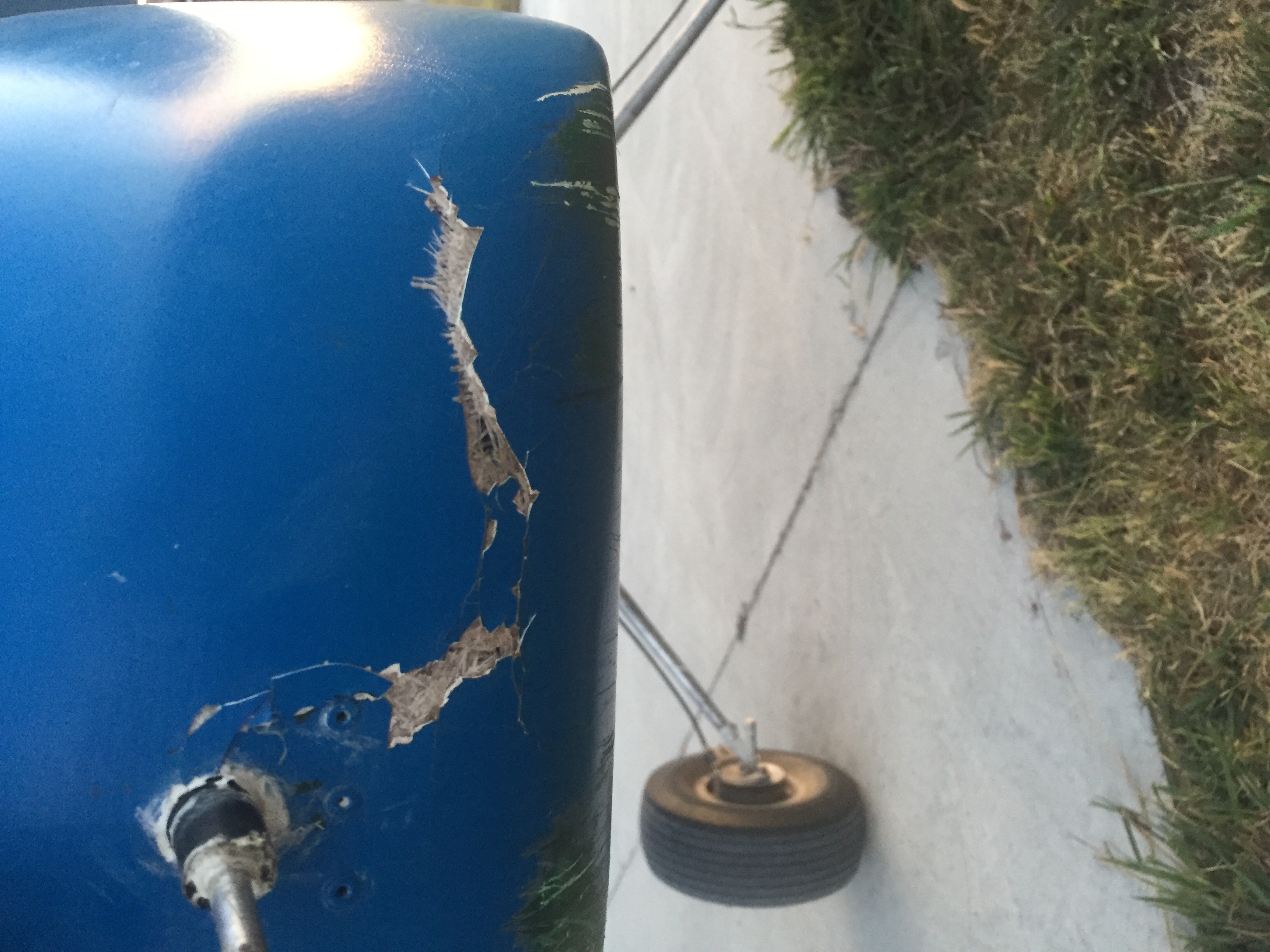

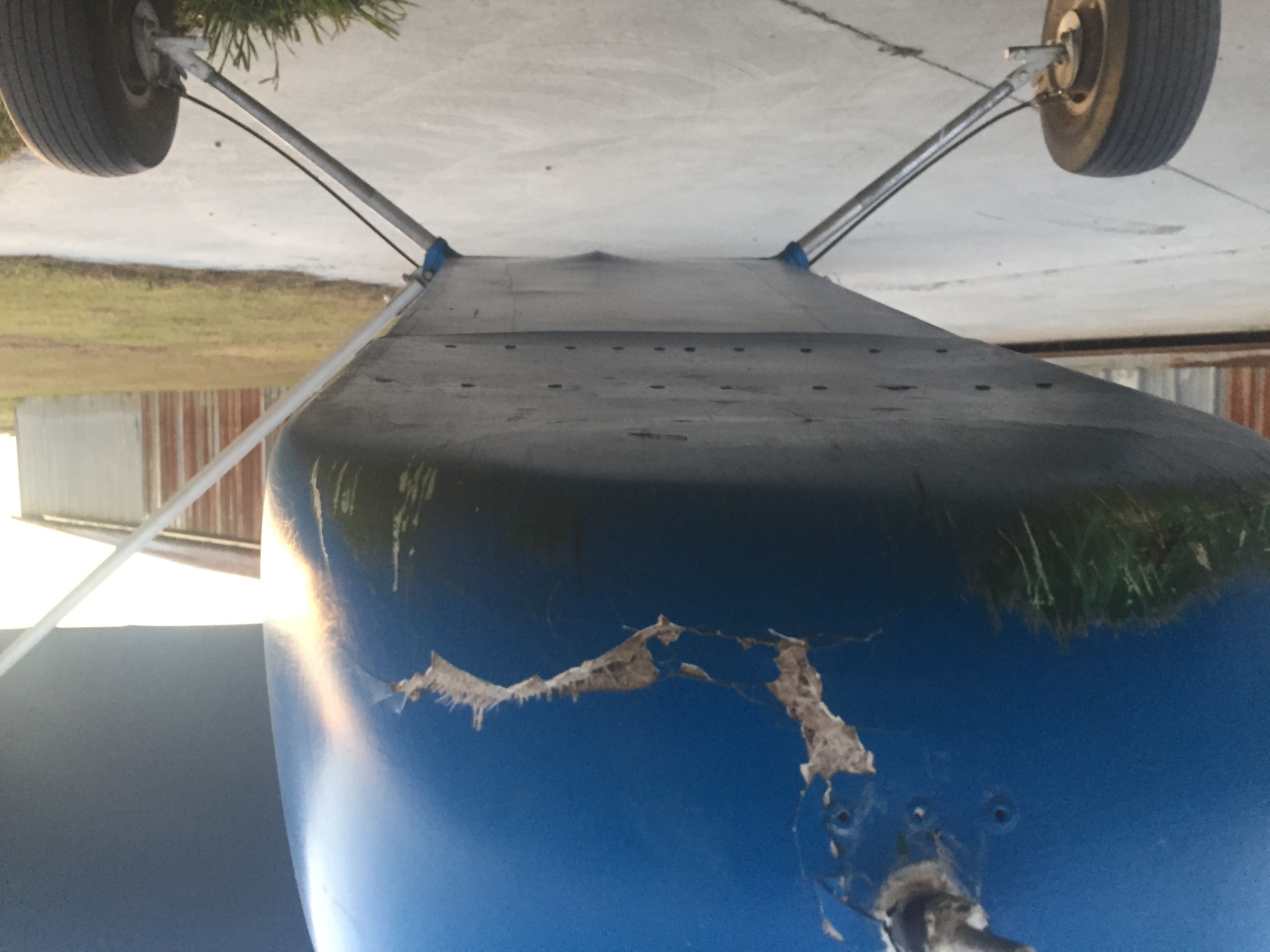

Well my first attempt at flying did not go so well! At least I now know what it feels like to nose over. Its not as scary as I thought. While I repair the nose cone i think I will install a temporary skid 😎

What were you trying to do? Not snarky, just wondering the mode of attempted flight...... Jim Baker [url=tel:4054265377]405 426 5377[/url]--

First two flights on Firefly #1 ended with landing on my nose, in quick
succession...I might add...Smile Took a real divit on the second
landing...Removed the Heel brakes and all was fine after that...bought
a used nose cone from Travis .
Well i found my old tail wheel assembly had a broken weld. So i put a new one on and was doing a bunch lf taxing back and forth. I haven't flown it so I do not have any muscle memory as to how the plane handles. I also dont really look at the gauges since I have my eyes glued to the field. I believe i got her up to 40-50mph and didnt realize it. I was holding the stick in the neutral position since i really didnt intend to fly her. Then i felt the nose going. I dont know if sticked back or not i just know that i ended up skidding about 50 feet.
