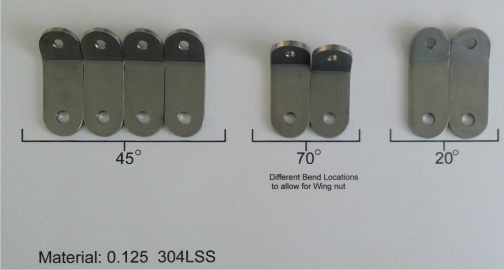

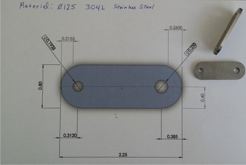

I just remade my Cable Tabs for the Horizontal Stab. I considered a few option as I don't need to fold my tail, but in the end I figured Mr. Kolb had a reason for the cables so I stayed with them. I did change the cable tabs due to the failures that have occurred. Attached is the print I made and a picture of the finished tabs.
 Filesize:  56.03 KB
 Viewed:  14373 Time(s)
 Filesize:  58 KB

Looking at the picture...what kind of bends did you make...The look
rather sharp ? Herb

"Looking at the picture...what kind of bends did you make...The look
rather sharp ? Herb "
Herb,
Thank you for pointing that out. I too was somewhat concerned when I made these.
The bends were made in a Mill by bringing the Z axis Knee up into a pseudo forming die. There is a substantial radius on the far side surface. I was somewhat concerned about the 70 degree bend and the effect it would have on the overall strength, so I made an extra tab. I then made a test fixture cable using (7/7) 3/32" galvanized cable. I secured a thimble in place and clamped the assembly together using my Nico press and two copper sleeves.
I placed this system in tension until failure occurred. The cable broke and the steel remained unchanged. I then used a hardened steel bolt through the .193 and the .250 holes and placed this in tension until it failed using a 20 ton hydraulic press. The .193 hole failed not the bend.
I did not perform any test on the 20 or 45 degree tabs.
I realize these test are not completely scientific, but I do feel comfortable knowing the cable failed long before the tab.
A rough conservative guesstimate since I do not have a strain gauge at my disposal is the tab failed around 4000 Lbs of force
Leland

Too...your stainless brackets are much thicker than normal for these
attach points..
Herb

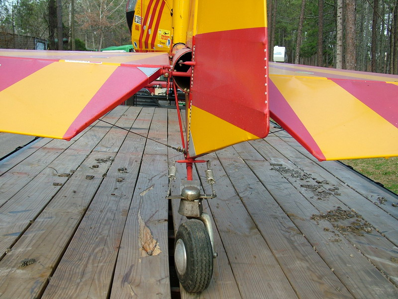

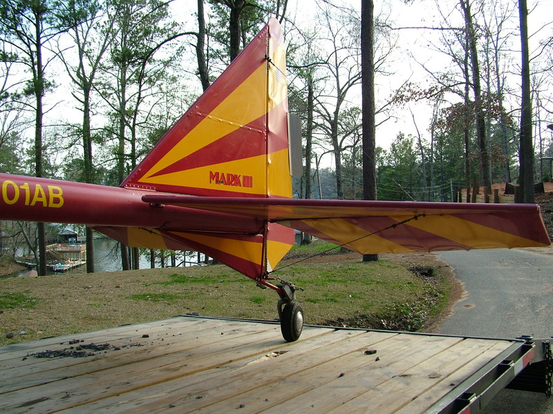

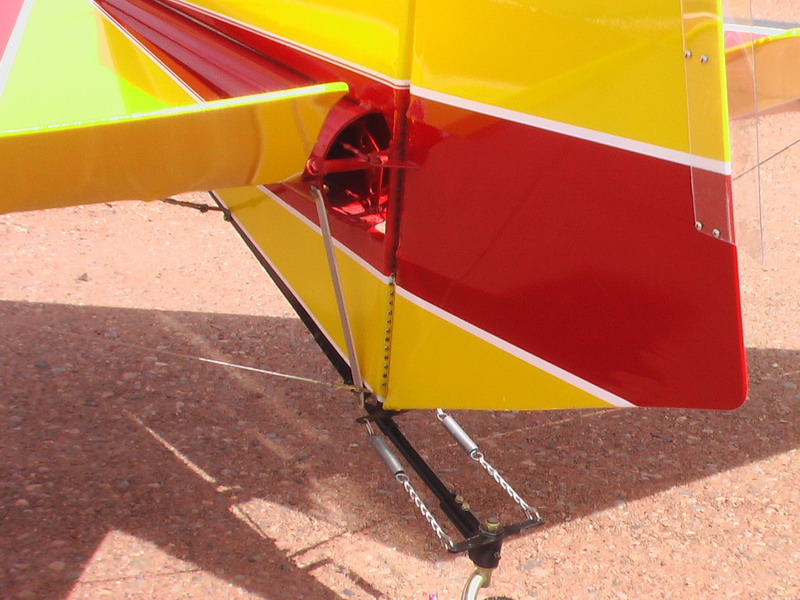

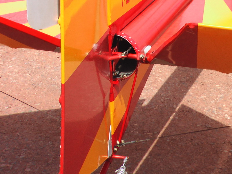

PostPosted: Tue Jul 07, 2015 1:38 pm    Post subject: horiz stab cables Reply with quote
I probably see things a little different than most folks. I
apologize for that.
Never had a problem with tail wires and tail post on the
Ultrastar or Firestar, but the MKIII configured the way mine
is is a different story. During the last 3,000+ hours I've
had the tail post fail 4 or 5 times, usually at the welds on
the lower tail boom ring or the tube separate just below
those welds. The reason it failed was all the side loads
from the tail wheel during taxi are concentrated at this
point.
Most folks refer to the tail wires at "tail wire bracing".
To me they are actually spacers that keep the vertical and
horizontal stabilizers located where they belong. Not much
bracing power to them, except for those welds at the tail
post ring that harden the tube and assist in failure.
We experimented many times with welded gussets, splices,
etc., to find a remedy for my tail post failures, but it was
Dan Horton, a local builder, that came up with the idea of
an external tail post brace that we welded from the tail
boom ring to the bottom of the tail post. Amazing how much
this stiffened the lateral movement of the tail post. I can
grab the top of the upper vertical stabilizer, shake it
laterally, and there is no give. Try that with your Kolb
and see the results. Since this fix, no more tail post
failures.
Several others have borrowed our fix. Most use aluminum
strap, bolting to the tail boom ring and the attachment bolt
for the tail wheel strut. No welding and fabric replacement
required.
I remember one year, back in the early 1990's at Oshkosh
while flying passengers in the Kolb Aircraft Company MKIII,
breaking the tail post as I turned onto the ultralight strip
to take off. This MKIII had very low hours, not nearly what
my MKIII has.
Another time my tail post broke within an hour of returning
from my last flight to Alaska in 2004. That would have
certainly put me in a bind had it happened a week or so
earlier.
I would not modify and fly with rigid braces on the tail
section on a Kolb.
I found some photos of my tail post and one of Gary Haley's
fix with aluminum strip and a couple bolts. It works.
Rock House, OR
 Filesize:  145.54 KB
 Viewed:  14346 Time(s)
 Filesize:  179.04 KB
 Filesize:  234.6 KB
 Filesize:  134.82 KB
failures.
required.
my MKIII has.
earlier.
section on a Kolb.
Rock House, OR
