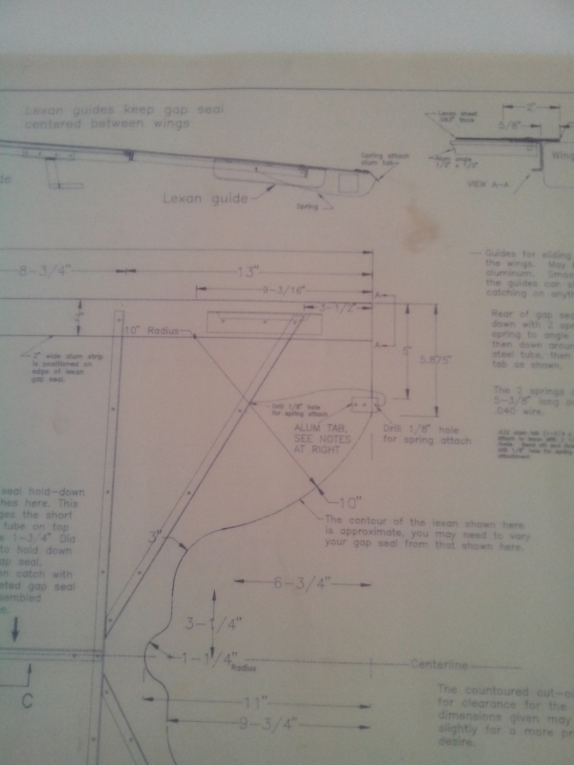

At the top of this picture is a side view at the right side there is a spring attach tab.   The spring goes under the 1 inch square tube to hold the gap seal down and back.    Lower in the picture is a top view that shows lateral position.

Thanks Boyd, is there any way I could get a reprint of your plans or copy them and send them back to you. I would make it worth your while.
I talked with the factory and they say they don't have any plans for the 2004 mk3x.
