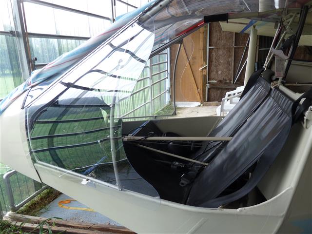

Tried it once, no change in flying characteristics, but the amount of wind drawn through by the shape of the cockpit was incredible. I suggest half doors, which is what I use in the summer. Open cockpit without the wind. It is easy enough to have 2 sets of doors; one set for the winter, one for the summer.

Dee One
Joined: 29 Jun 2015
Posts: 48
PostPosted: Mon Aug 24, 2015 5:39 pm    Post subject: Flying Mark III with no doors. Reply with quote
Is this half door of your own design? Do you have a photo? Sounds like a good compromise. Dee LeBlanc

They are identical to stock MKIII doors with that back half cut off and the curved back vertical moved forward and reattached with some of the curve taken out. I started with the Lexan extending back further, a straight edge, and kept cutting it away until I could see past it and still not have a lot of wind.
Anyway, the top hinged piece extends up 29" from the edge of the fiberglass fairing, the rest of it is just eyeballed to suit, I doubt it is at all critical. I have used these since 1998, replaced the Lexan a couple times as it gets scratched.

Thanks Richard, I plan to give it a try. Maybe I’ll start with old Lexan and trim to my liking for a pattern. Dee LeBlanc
