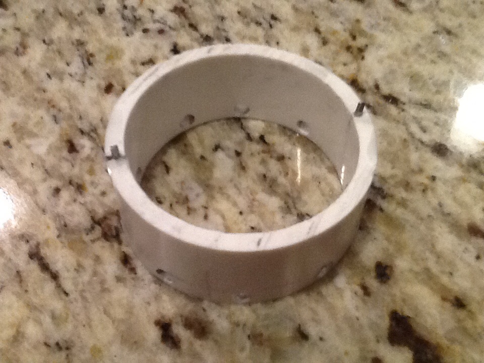

I installed the SteinAir vents after the overhead console was bonded to the canopy and clear coated. Of course, the openings were cut to size beforehand.
I made a tool to tighten the nuts inside the console. I cut a 7/8" long piece of 2" PVC pipe, then drilled 2 small holes in the end of the PVC pipe that align with the spanner wrench slots in the air vent nut. Insert small finish nails in those hole in the pipe and you have a much better way to tight the nut. I also have a series of small holes around the perimeter of the PVC pipe so that I could insert a drift punch and use it as a lever to rotate and get the nut even tighter. I have installed and removed the air vents a couple times without a problem. Attached is a photo of the "tool".
 Filesize:  207.8 KB

PostPosted: Sun Aug 30, 2015 12:54 am    Post subject: Vent Install Aerosport OH Console Reply with quote
Great tool! I think I will make a copy of it. I have a loose light the is forward of the air vent that I can't get to with the vent in the way.

I have cut the holes and fit vents...was just trying to decide if to install now before I bond or not. I tried to install with OH console clecoed in placed and seemed difficult which is why I posed question, but I think this tool is a great way to go. Thanks

Looks just like the tool I made/used!
http://i.imgur.com/0jZOHvV.jpg
I also installed the vents after the cabin top was installed.
