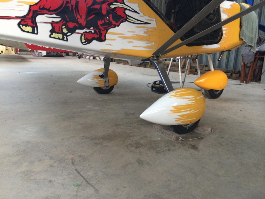

We did our previous aircraft a Skyranger Nynja very successfully and our Europa will soon be getting a similar treatment. I have attached a photo for you to drool over....
 Filesize:  251.51 KB
 Viewed:  8899 Time(s)
Aircraft Kit Builder and Passionate about Flying

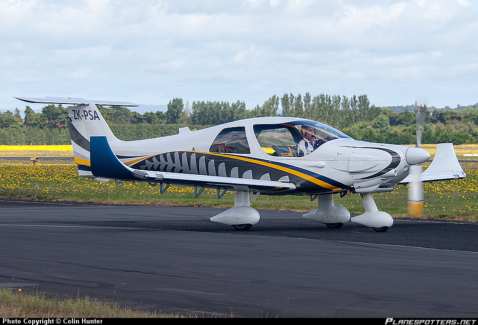

PostPosted: Fri Sep 18, 2015 1:16 pm    Post subject: Re: Wrapping composite aircraft Reply with quote
On my DynAero MCR-4S, all the graphics are vinyl not painted. Where the there was a major colour ie white, light blue (underneath wings) - this was painted.
While computer cut graphics give great flexibility in your design I caution you, it is not how it looks after completion but how it looks in 4 years time. Looking after vinyl graphics on a plane is a lot more difficult than looking after paint, vinyl can get tatty, do not like being exposed to 120 knot winds and do not have the same lustre finish as paint.
Knowing what I know now I would probably have done my design in paint rather than vinyl.
Trust this helps
Cheers Peter
 Filesize:  654.42 KB
 Viewed:  8829 Time(s)
Peter Armstrong
Auckland, New Zealand
DynAero MCR-4S (Do not shoot me Smile ).
