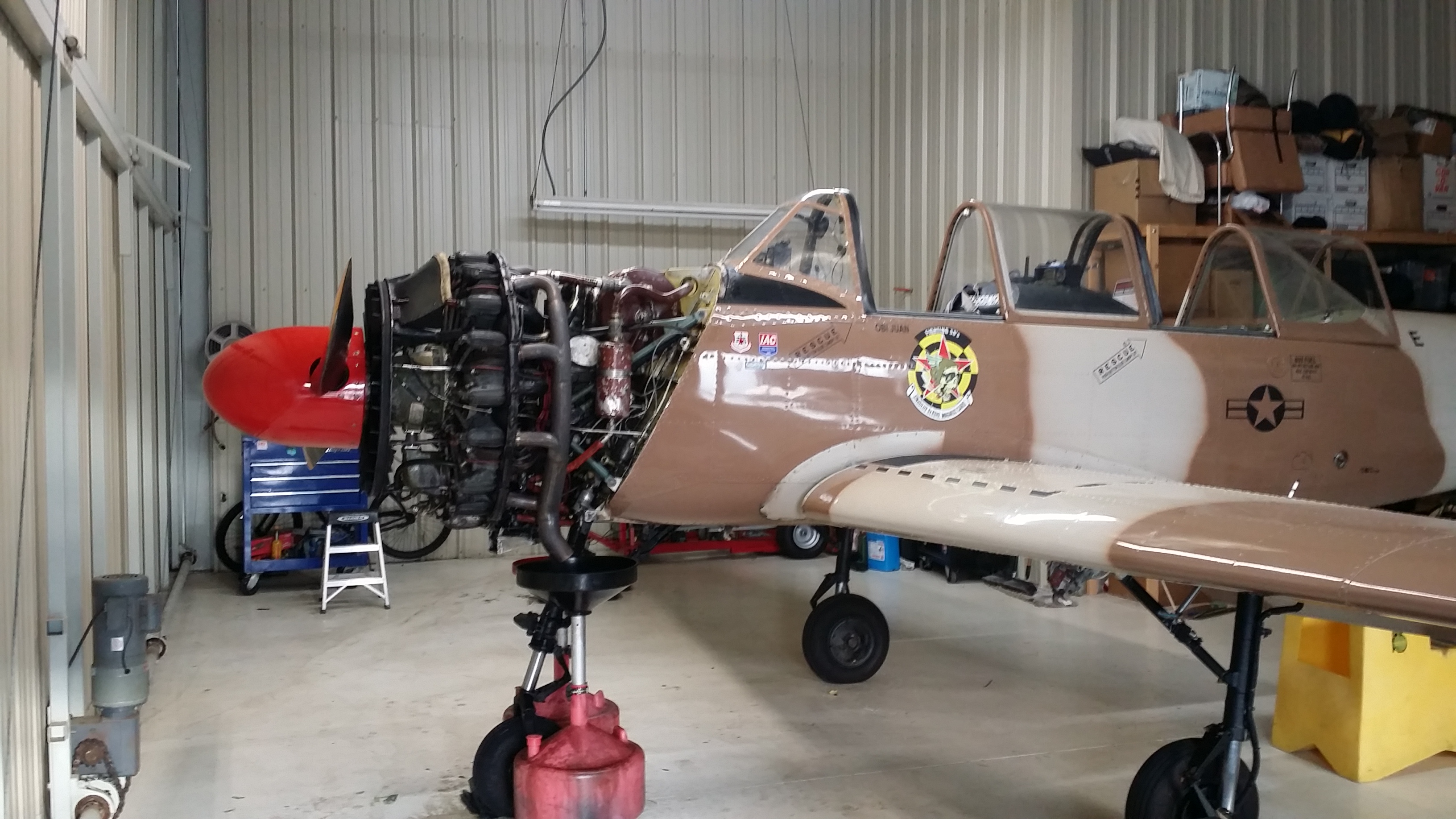

Mechanic asked for some help, installing a new-to-me spinner (Yak-18T style), and we are having trouble getting the nuts on the back side. Removed the beauty ring that sat over the inner gill frame on the nose case but looks like more of that might need to come out.
Does anything more in the attached photo need to be removed for spinner install?
Thanks in advance

So I went into the parts catalog because it appeared there was another ring to be removed, and I was right. It is called 'removable ring' in some illustrations and is the ring the bolts that serve as the eccentric pivot for the gill go into.
Removed it and was able to get the first half installed yesterday.
Previous owner had modified the backplate to be installable with the nuts installed by filing down the inner lip and slotting the holes - takes some manipulation but was able to get the first half on yesterday.
Will take some patience but should be able to wrap it up now.

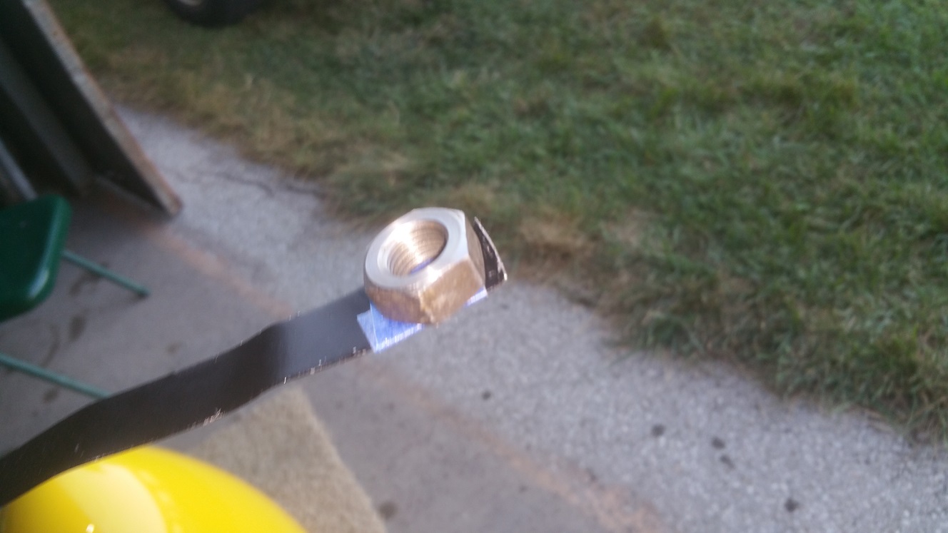

I just finished installing a Whirlwind spinner and this is the tool I finally made that helped immensely - similar to Mark's post. Dennis Savarese suggested this to me and it worked great. Of course I did drop the nut several times before getting to thread.

The image did not post because too big. Here it is now.
