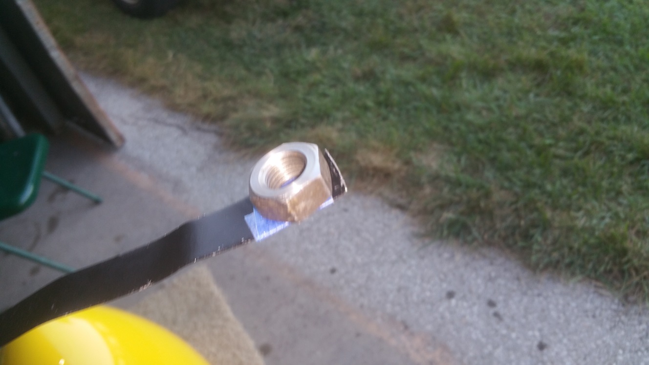

I figured I would post this so anyone else looking will see similar but slightly different solution. I found the very thin (1/32) aluminum worked very well for me.
