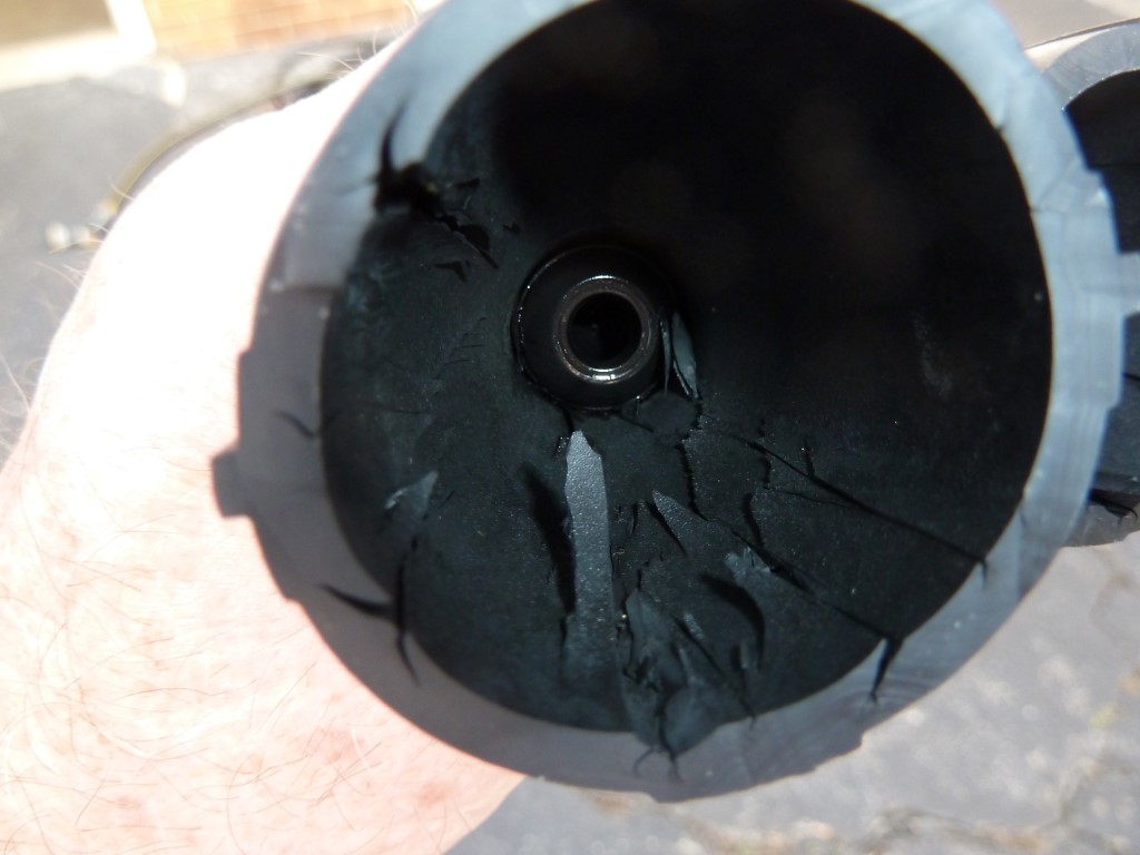

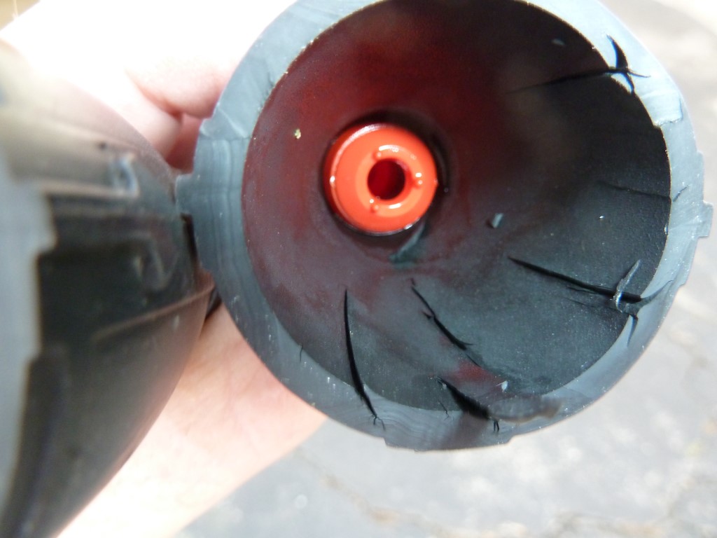

Tried to start the FSII last week, the priming system was not priming, you can get an idea of how it is plumbed on this page: http://oh2fly.net/oldpoops/Fuel_tanks_storage.html
Primer bulb was not working, put in a new one and cut the old one in half with an X-acto knife. Very interesting: the inside was coming apart in strange ways. Note a couple little fragments of rubber right next to the ends where the check valves are. They are not a result of cutting the bulb apart, they were there and got discovered. Guaranteed to make the bulb not work right.
Don't remember how old this bulb is, but they obviously have a fairly short service life, probably ought to replace at annual.

Alcohol doing something to it? Mine got really hard, and has to be replaced.

Most bulbs are, as you describe, crap. I've had several that had to be taken apart from new in order to modify the check cage to secure the ball from falling out. And the bulb material will often disintegrate.
I look up these the same way I do toothbrushes. You know damned well there is a plastic bristle formulation that won't deform for years but the manufacturer prefers built-in obsolescence.
