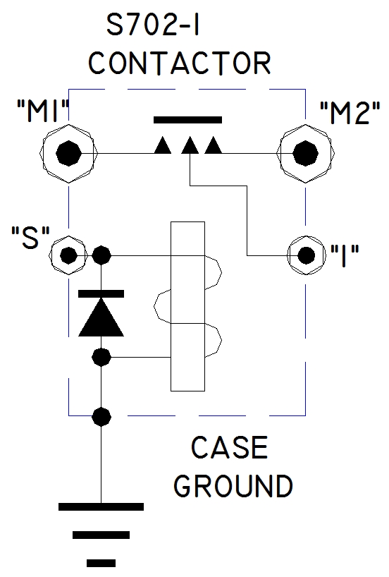

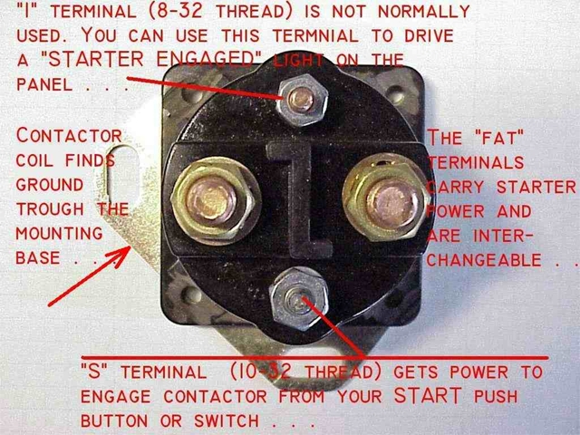

Yes, I have seen the PDF. And yes, you would think you could ohm out the terminals. And yes again, I agree, it does not look like a very complicated device. However, there is no continuity between the "I" terminal and any other terminal. Hence my inquiry to them. I am still wiring so I have not energized the contactor and checked it in real world operation yet. My questioning to them was whether the "I" terminal is suppose to go positive (+12vdc) on contact closure and have continuity with the "M" terminal or, have continuity through the mounting base and thus go negative (-12vdc) on closure. It would make a difference on the annunciator wiring. My assumption tells me it would go positive but I didn't want to assume anything. I called and talked to both of them and neither could tell me how it worked nor could they provide a schematic.
Here is the schematic for that part . . .
[img]cid:7.1.0.9.0.20160215230451.060d5330(at)aeroelectric.com.0[/img]
This is the wiring data
[img]cid:7.1.0.9.0.20160215230451.060d5330(at)aeroelectric.com.1[/img]

Thank you for the schematic, I had not seen that before. It did not occur to me to search your site.  I just expected that B&C would have had the relevant schematic for an item they sold or would have been able to tell me how it worked. They were not able to do either.
Thanks again.
