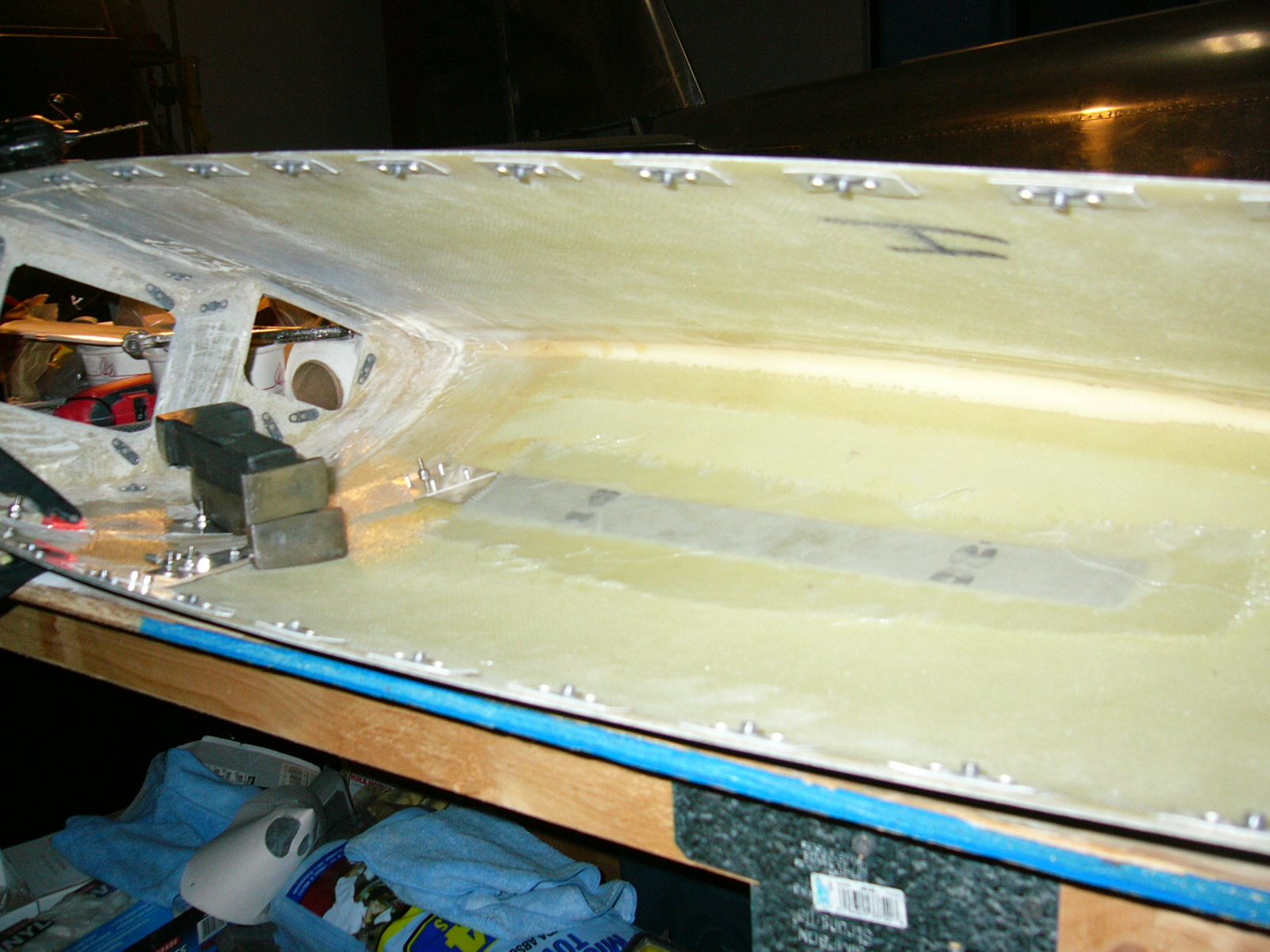

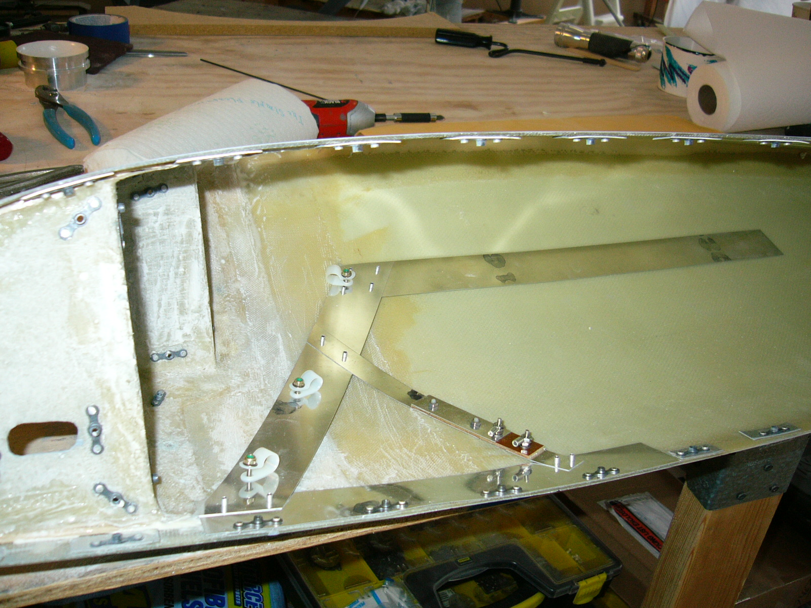

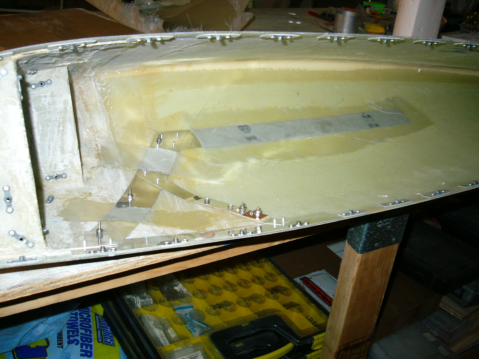

Pictures are good to have. See attached.
Agree with Carl's remarks.
I installed the Archer in case I decided to use it. Have never used it.
