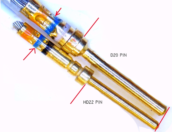

Will the tool you linked above also do machined high density D Sub pins?
PostPosted: Fri Apr 01, 2016 4:16 pm    Post subject: D Sub Crimper Recommendation? Reply with quote
Bob,
This is problematic . . . if the pin
positioner indexes off the END of the pin,
then the quad-crimp will be in about the
right place.
[img]cid:.0[/img]
However, the fussier tools (read $high$) will index
of the largest leading shoulder. In that case, a
positioner set up for D20 might not even 'catch'
an HD22 . . . and the pin falls through.
Then there is the matter of crush depth for the
wire grip. The Eclipse tools I used to sell did put
an adequate crush on an HD22 pin . . . I could not
pull it off with ~5 pounds of force. The pins you
see above were applied with a tip-indexing positioner
in a Buchanan tool. Wire grip position is good . . .
but the HD22 pin is loose on the strands.
The short answer is try it. Look at were the crush
hits the wire barrel . . . it should be centered on
the paint stripes. Then hang a gallon milk
jug about 2/3 full of water on the wire and lift
ot with a pair of pliers on the pin. If the wire doesn't
move, you're good to go.
