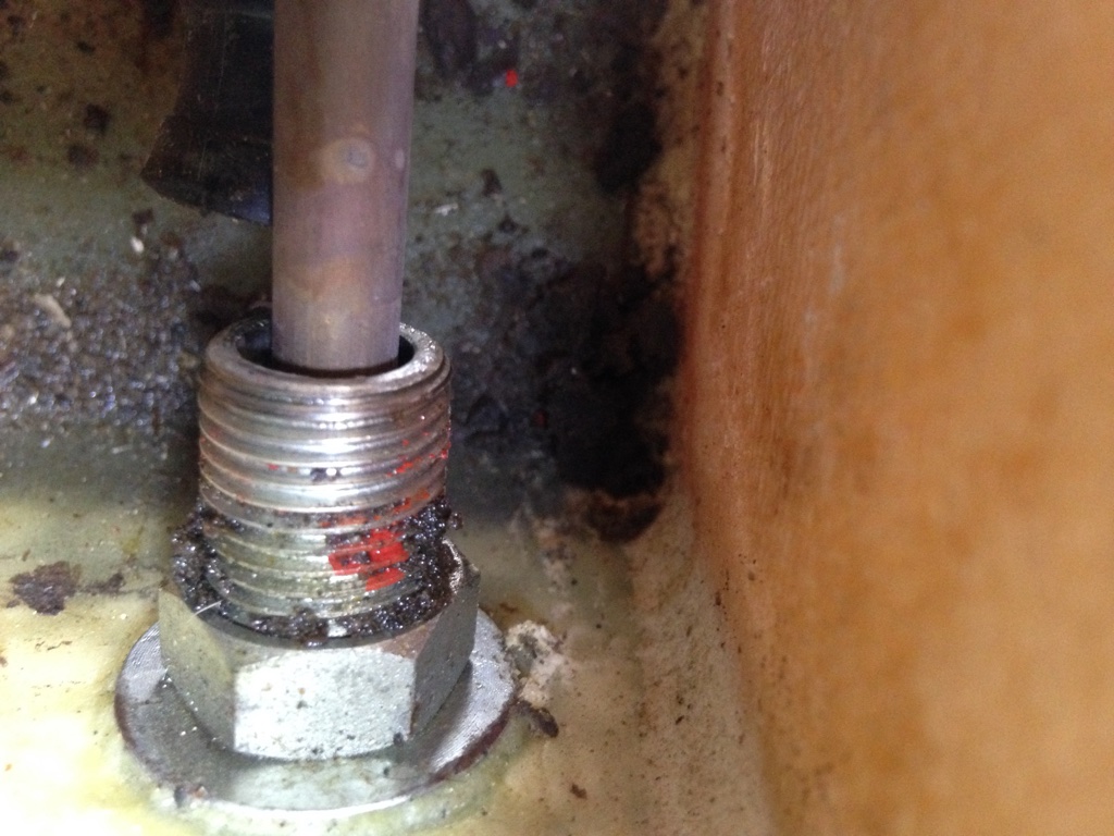

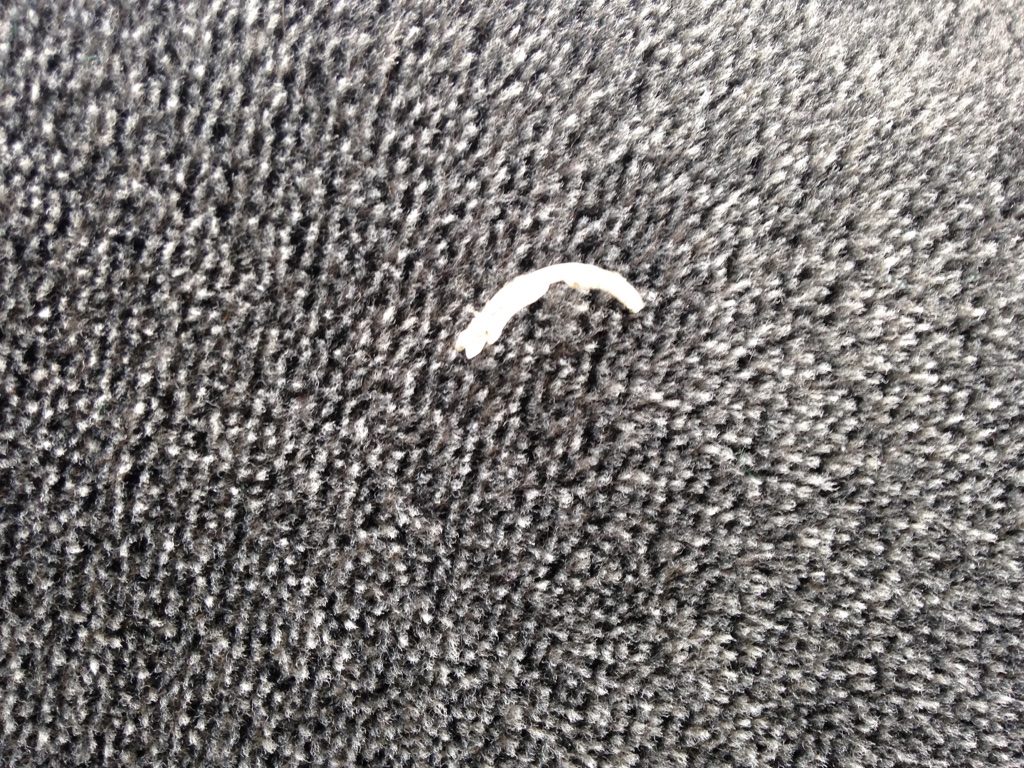

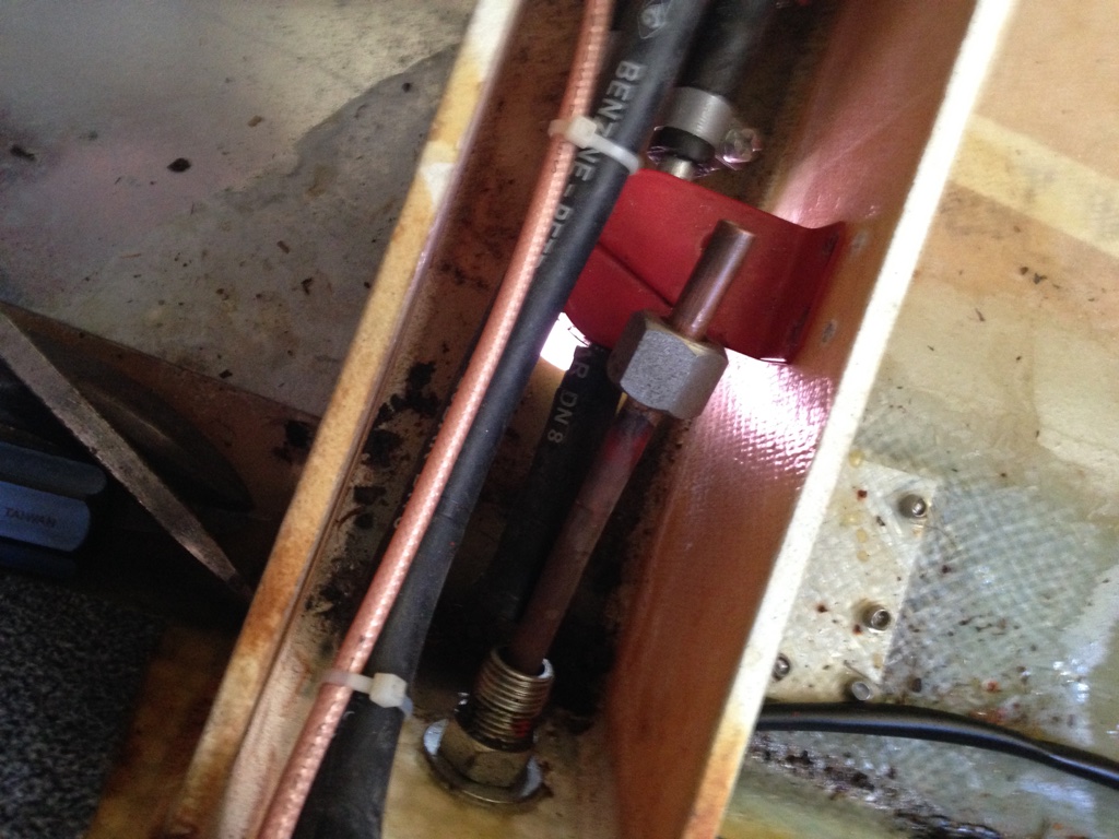

2) My CFI and I smelled fuel in the cockpit at slow flight. After further investigation I found a puddle under the floor board originating from the fuel tank outlet connection assembly. Attached below are photos of the assembly and a piece of what looks like the remnant of a nylon compression gasket. Of course I have no drawings of how this assembly goes together and no list of parts. This fuel leak may have simply come from a deteriorated compression gasket. The gascolator and filter in the gascolator are in good condition and very clean. Please let me know if there is a nylon compression gasket that should fit up against the screwed fitting coming out of the fuel tank. Also, in retracting the fuel pick up tube from the tank, I'm not able to get it completely out. I assume there is a filter of some sort at the end of the pick up tube which locates at the low point in the fuselage tank. This will have to be disassembled to install a new nylon gasket if that is in fact the arrangement that is needed. Please advise me on how to correct this serious fuel in the cockpit issue.

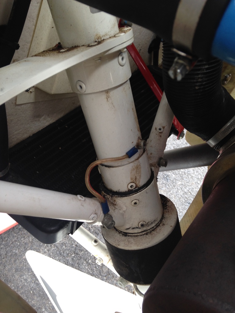

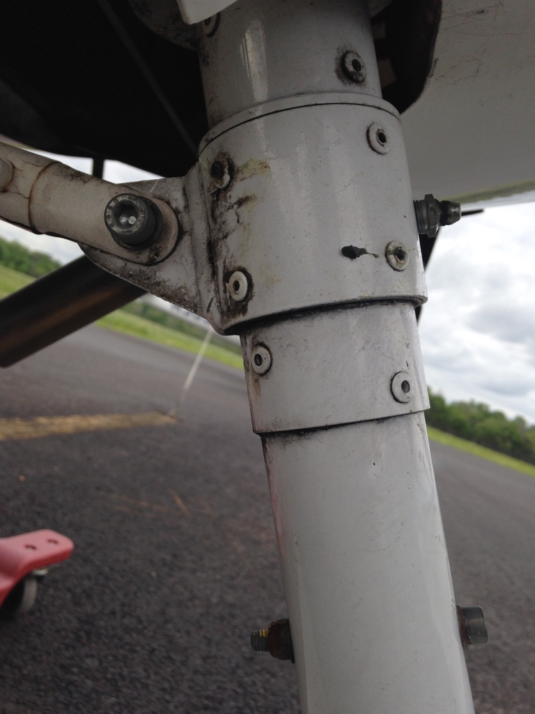

3) The aileron and elevator controls are very smooth and light. However the rudder is extremely stiff. I disconnected the linkage between the rudder pedals and the nose gear lever; at this point it was very clear that the far majority (95% plus) of the rudder force is due to nosewheel pivot resistance. An individual on Matronics indicated that he had the same problem which he solved by machining a part. Please see here the text of his post on Matronics’s.
"When our Allegro 2000 was delivered the rudders were stiff.
We found the problem to be the sleeve (the piece with the lubricating nipple in
enclosed photo) jamming against the collar above. We machined it down a few thou
and the rudders are smooth and light.
Paul”
I’ve attached a few photos of the sleeve and collar that I believe he’s referring to. Please let me know what's your recommendation is to resolve this issue. Any assembly drawing would be helpful. At this point very aggressive rudder forces are needed for ground control and in the air.

I'm pretty sure it was the collar above the compression block which we machined down (in your second photo which corresponds to my original photo)
Are you certain the nosegear tube is not bent ?
