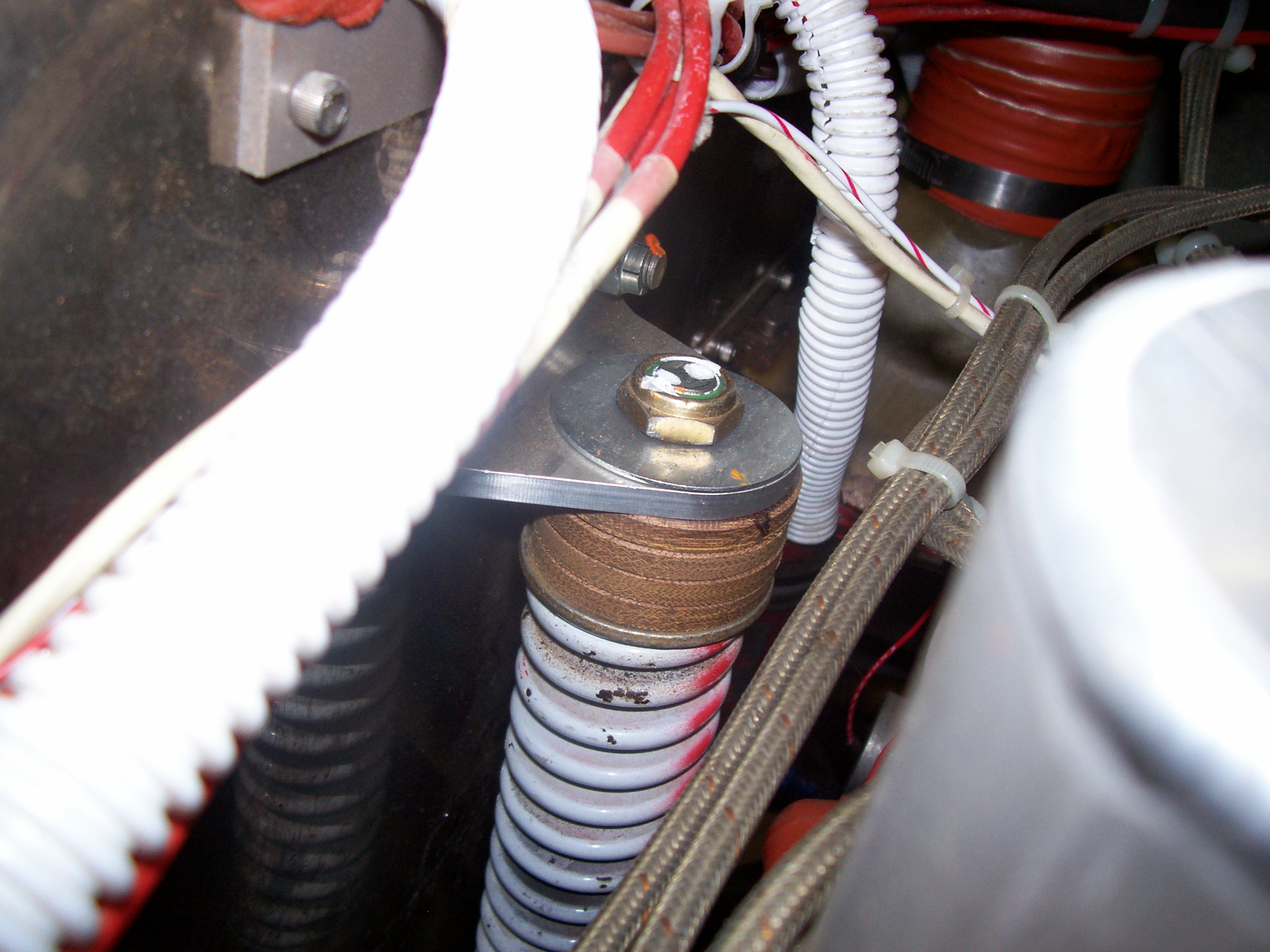

Hello Mark, Thanks for weighing in on this subject. You wrote:
1) “I am sorry to say the secrets of the nose gear spring were only known by Vance.”
The KIS family lost a true friend when he passed. I wonder if any one in his family could help. I’ll try an email address from his web site. http://www.oocities.org/vjaqua/
2) “I do have an engineer who has access to test equipment that can determine the parameters of the spring.”
That is one approach. Another is to assume that: a) the spring was a standard catalog item (maybe from McMaster Carr?); b) that same catalog item is still available; and c) by just using the spring dimensions Lyle would be able to identify and order a duplicate spring. A picture of the top of the spring which is installed in my plane is attached.
3) “If I can get somebody to take their TR-1 nose gear apart and send me the spring I can send it to the engineer and he will test it.”
Or, if somebody could just remove their KIS TR-1 nose gear coil spring (hopefully from a non flying airplane) and provide some accurate dimensions we could identify it that way. See my related and redacted April 09, 2016 9:55 AM email copied below.

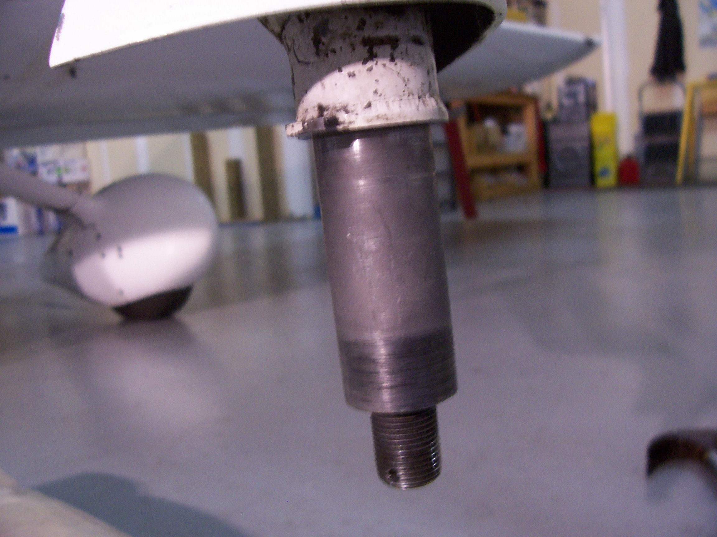

Hello Lyle, I went out to the hangar yesterday, partially disassembled my
airplane and took some
nose gear related photos and measurements. I'd like to take another stab at
answering your original
April 06, 2016 12:49 PM email (copied below). You wrote:
1) "My question to you is re: the upper spring."
Selecting the McMaster Carr coil spring that matches the one in my airplane
is not as explicit as I would like.
First off, my previous estimate of the uncompressed spring length of 12
inches, based on appearance in the
attached 429 KB photo, was wrong. The measured length on my nose gear coil
spring (as installed) is
very near 8 inches.
The measured outside diameter of my coil spring (using a C clamp as a
micrometer) is very close to 2 inches. There
are two 8 inch long coil springs in the McM C catalog that nearly fit that 2
inch OD dimension: 96485K164 at 2.187 inches OD
and 96485K386 at 1.917 inches OD. So I can not discriminate between those
two P/N solely on OD. See here:
http://www.mcmaster.com/#compression-springs/=11wlo5u
Wire diameter does not appear to be a good discriminator for two reasons: a)
the wire in my spring is not round, but
is flattened on the top and bottom; and b) accurate wire diameter
measurement access to my spring is difficult. For both of those
reasons an accurate wire diameter measurement is difficult. In the catalog
P/N 164 has a wire diameter of 0.25 and P/N 386 has
a wire diameter of 0.312. My estimate favors P/N 164.
Regarding max load: P/N 164 has a max load of 274 pounds and P/N 386 has a
max load of 597 pounds. My plane has an
empty weight of 242 pounds on the nose gear so a max load rating of 274
seems a bit marginal to me, but then I don't know
what the criteria for max load is (fully compress the spring or ???). 597
pounds seems very stiff to me.
Maybe you can discriminate between the two P/N's by which spring will best
fit over the compression rod. P/N 164 should have a
calculated inner diameter of 1.687 inches and P/N 386 should have an inner
diameter of 1.293 inches.
My choice between the two McM C springs would be P/N 164.

These are standard die springs from McMaster and follow the Raymond die springs color code.
http://www.mcmaster.com/#standard-die-springs/=11zcvvg but check the size!
top of the spring
very near 8 inches.

From my old calculations for the TR-1 nose gear it looks like the desired spring rate is 329.7 lbs/in. The McMaster part number 9584K99,
http://www.mcmaster.com/#9584k99/=11zi7a8 looks like it meets this number nicely, the size OC provided and the color in the picture OC provided. It also meets the color and size on my TR-1 nose gear.
Mark K
top of the spring

bakerocb
Joined: 15 Jan 2006
Posts: 727
Location: FAIRFAX VA
PostPosted: Thu Apr 14, 2016 7:06 pm    Post subject: TR-1 Nose Gear Reply with quote
4/14/2016
Hello Graham, Thanks for the quick response. A picture or two would be great also.
OC
PS: We are also very curious as to how long the threaded portion at the bottom of the lower vertical stub is and how the threaded portion is attached to the larger diameter stub material immediately above the threaded portion. Please see the attached picture.
bakerocb at cox.net
