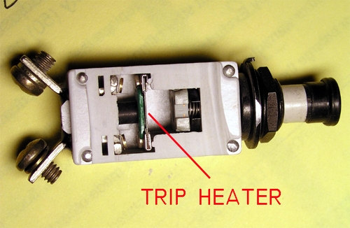

The breakers we use are actuated by
a temperature rise in a heater . . .
[img]cid:.0[/img]

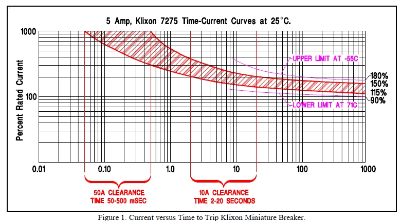

This event takes TIME . . . here's the typical
trip resonse for a 5A breaker . . .
[img]cid:.1[/img]
15A would be a 3x overload on the breaker. The
data above suggests that it would take 0.5 to
3.0 seconds for a 15A stress to open the breaker
at room temperature.
I would bet that you could 'protect' your system
with a 5A breaker. Give it a try and report back
to us. The worst case scenario says you'll need
to upsize to a 7A breaker but certainly no larger.

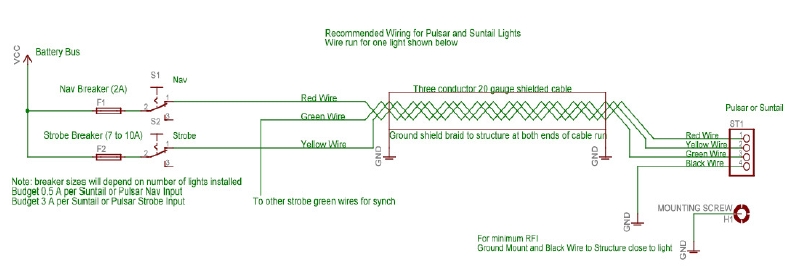

Okay, found the wiring . . .
[img]cid:.0[/img]
This configuration doesn't pay homage to the physics
that describes effects of electron flow in wires.
It appears the product has 4 connections for functionality,
two power lines for strobe and nav, one sync wire and one ground
wire. The use of a shielded, twisted trio ADDS NOTHING to
EMC compatibility of this product when wired as shown.
There are two propagation modes for interference to get
out of the system wires . . . electrostatic coupling which
is very weak and couples fast-rising voltage excursions
from one conductor to another by means of capacitive
coupling. The antagonist and victim wires as capacitor
'plates' must share dielectric separation consisting of
air -and- insulation of the two wires.
This coupling is tiny . . . measured in tens of picofarads
per foot. It takes a strong voltage rise (like those found
on magneto p-leads and xenon strobe wires) laying in close
proximity to sensitive victims like audio and data wires
over pretty long distances before electrostatic (capacitive)
coupling becomes a significant risk.
The other mode is electromagnetic coupling . . . also weak
but significant when electron flow in a wire passed within
inches of a device like a compass that is attempting to
resolve milligauss vectors (earth magnetic field).
The wiring shown above shows shielding which is useful ONLY
for disrupting a non-existent antagonist->propagation->victim
configuration.
At the same time, power ground for the system is illustrated
as happening locally. This means that electrons flowing one
direction in the twisted trio DO NOT FLOW in the opposite
direction in the same bundle of wires. This totally negates
the de-coupling capabilities of the twisted trio.
To correct this mis-understanding of the physics, I would
USE THE SHIELD as the ground return for all wires within
the shield. This will cause the shield to offer concentric
equal amplitude, opposite polarity return cancellation for
magnetic fields generated by outbound current flows. Having a
TWISTED QUAD of wires and no shielding would be just as effective.
But using the shield for the 4th wire is a perfectly acceptable
practice. Wiring the shield as shown produces no demonstrable
benefit.
It's completely understandable why someone experienced a magnetometer
interference experience using the factory wiring as depicted . . .
but its all about concentric current flows and has nothing to
do with 'shielding'.
<2a35c5db.jpg>
<2a35c639.jpg>
