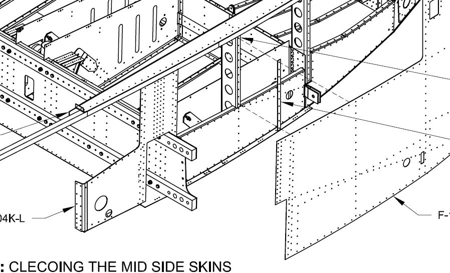

I have a question about the fuselage mid side skin dimpling. The instructions say to dimple all of the 3/32" holes that were drilled to the understructure. However, the corresponding holes in the F-1015A outboard seat ribs were not dimpled. They weren't specifically excluded from dimpling, but there was no step where they were dimpled so I didn't do it. This is the outboard rib immediately aft of the spar carry through. I have attached a clip of from the construction manual of this area. The holes in the F-1018 rear seat ribs (the next rib aft of the problem ribs) WERE dimpled as per the instructions.
It's going to be a pain to try and dimple those holes now. It looks like many of them will be hidden in the wing root area so I was thinking of using AN470 rivets in those holes instead of AN426. It looks like some of the holes will be above the wing though, so I will have to figure out a way to dimple those holes or countersink them. I do have a tight fit dimpling set that uses a rivet puller, but the performance is barely acceptable on thinner material. I will probably call Vans on this but I was wondering if others have dealt with this issue and what the resolution was.

Hi Kent,
I don't remember the specific rib part numbers or anything, so this is
sort of off the cuff, but...
For the rivets that will be hidden in the wing root area, I don't see why
AN470's wouldn't be fine. I think the RV-14 kit used a lot of AN470's there.
And, if you have an area where you have a handful of rivets that are
visible and you want flush rivets, I don't think I'd worry too much about
countersinking a few of them if necessary. I too don't have great luck
with the pop-rivet dimple die set. I did just tonight pull out a vice-grips
dimple die to get some real tight ones...it's a vice grips with dimple dies
welded to them. If you have one of those maybe pull it out.
It's a handy tool when you need it.
At any rate, I wouldn't stress out too much if you're only looking to
countersink a handful
Tim

Hi Kent,
I’m at this stage myself. I thought about using AN470s but the skin has already been dimpled. I used the pop rivet dimpler where I could, and when I couldn’t I used a machine countersink – it’s been a couple of weeks since I did this and now the skins have been riveted on, but as I recall there were only 4 holes where the substructure was too thick to use the pop rivet dimpling tool. I countersunk those 4 holes and the countersink did not penetrate too far in the inside-most piece of structure to prevent forming a good shop head on the rivet.
The pop-rivet dimpler works ok on the rest of the holes.
Jack Phillips
