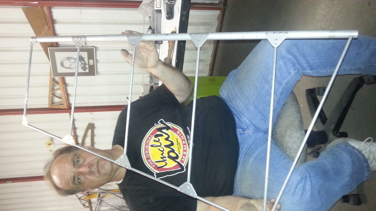

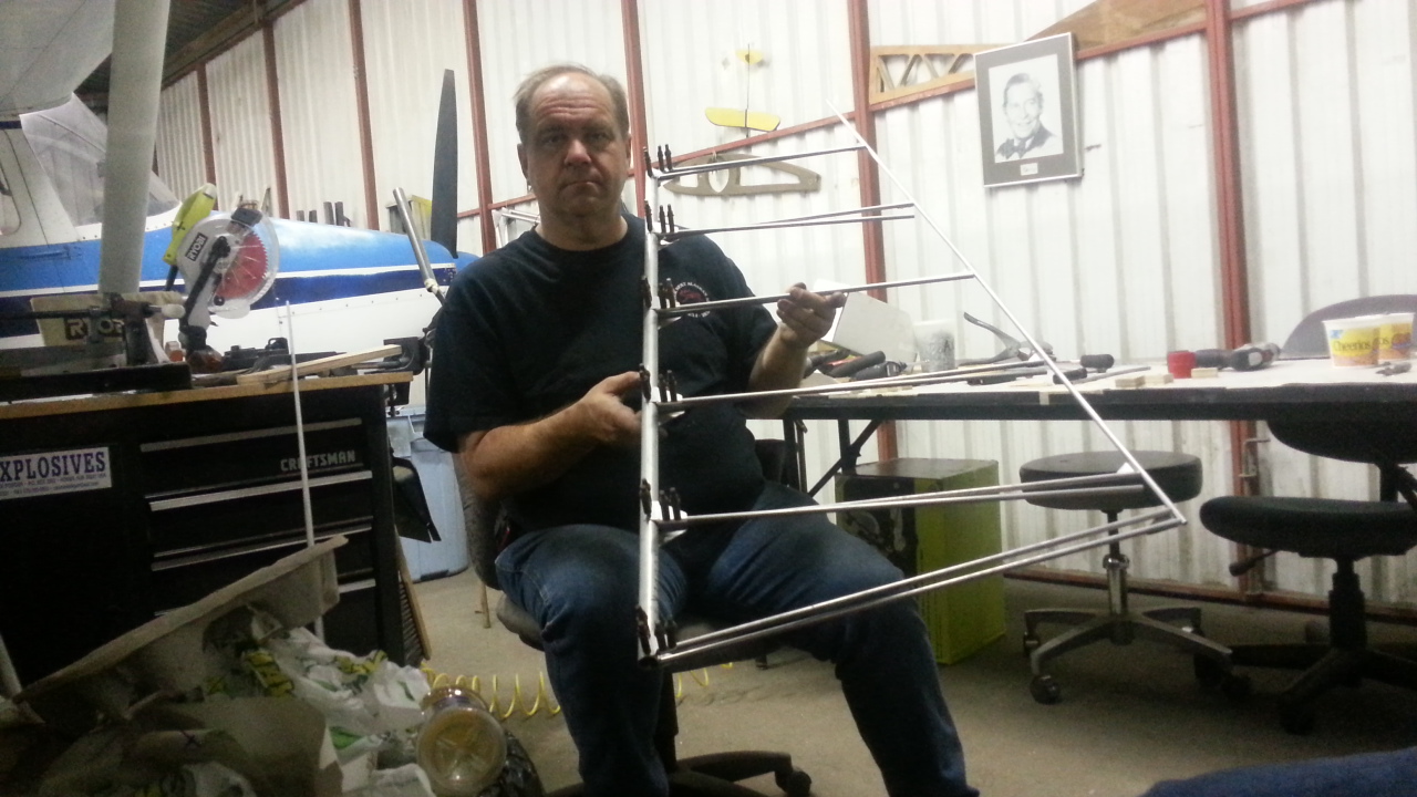

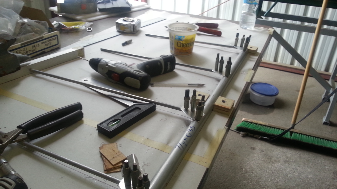

I was out last night working on the Firestar project, and wanted to report my progress.
As of this writing, I have completed two horizontal stabilizers, and have completed just about everything on the vertical fin assembly. The only thing left on that is to drill the hole for the lower tail brace wire bolt, but I'm sure this can wait until I have the tail installed on the fuselage tube and can line everything up better.
I started to lay out the rudder last night, cut the main upright tube, and started laying out the gussets. After looking closely at the standard rudder and elevator, I decided to make a slight change in the method of attaching the parts together. To make a slightly more robust and more rigid set of controls I will be using the same style of thin "tube and gusset" construction as the stabilizer. This will allow two rivets at each intersection instead of one, and provide a small triangular gusset to stiffen and brace the intersection. The extra weight and "control surface balance" will very likely be negligible.
I had made a decision to not attempt to build a showplane, and not attempt to make everything perfect. An engineer friend of mine has a saying... "perfection is the enemy of completion" Smile So my efforts will be used to build a safe, solid, but not show quality aircraft. Since this one will be used as a dirt and sand airplane fairly often, any extra effort on a shiny finish will have been wasted. This whole thing may be left Stits silver anyway, to make dings, repairs and bullhead thorn repairs easier.
As an esoteric note, I just realized that the serial number on my fuselage (F-1203) is different than the number in the instruction manual I got (690-something). Can anyone tell me if there were any changes to the manual that would affect this? How can I verify that I have the latest and most applicable instruction manual and/or plans?

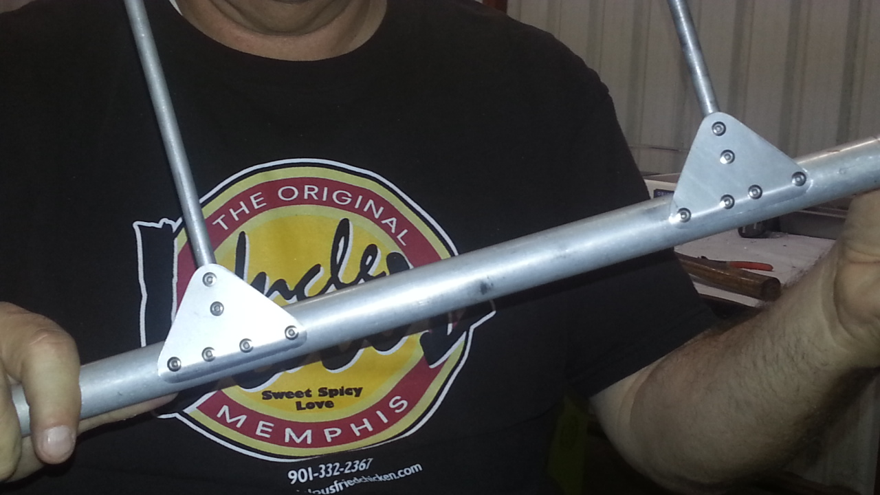

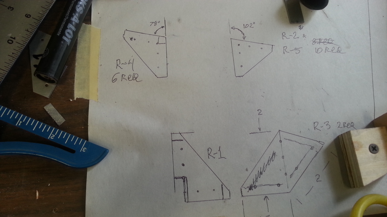

PostPosted: Sun May 08, 2016 12:11 am    Post subject: Kolb Firestar Progress report Reply with quote
Just came back from building 80% of the rudder.
Thank you Richard, I do understand that flutter can happen on control surfaces. If it becomes necessary I will put a balance weight on but hopefully that will not be necessary. The Cub, Taylorcraft, Champ, etc. have welded steel rudders and elevators that are much more "out of balance", and their flutter speeds are higher. My goal was to make the controls stiffer and more robust, which also helps prevent flutter.
I will make a better analysis of how much weight gain there actually was; I believe it will be very little. But the short version is that I used .032 triangular gussets, about 1.5 inches long and wide at the leading and trailing edge intersections, rather than riveting the "rib" tube directly to the leading and trailing edge with one rivet. Using the gussets allowed me to use two rivets, and not have to squash the small tube. Using the gussets at the trailing edge also allowed me to have a far better attachment where the ribs go all the way to the trailing edge, instead of joining the two rib tubes with only one rivet.
I also "curled" the gussets around the tubes to create less protrusion into the fabric. This was more than cosmetic... it allows you to have the full, correct, safe "edge distance" between the hole and the edge of the part. The stock Kolb drawings have you building parts that simply do not meet the time-honored "2D" minimum edge distance (AC 43-13 and many other references). I know that the Kolb factory did not do this by mistake, they were trying to prevent the edges of the gussets from protruding as much. But the price for this is that they gave up a very long-standing safety margin that has been built into sheet metal and rivet structures since the 1920's.
I believe that there will be something like 3-4 inches of etra 5/16 x .035 tube for each "rib" station. There will also be the extra weight of the gussets, and a handful of additional rivets. Definitely more material, but hopefully still down in the "negligible" range.
I also made a cosmetic, strutcural and serodynamic improvement at the trailing edge. To keep the trailing edge of the rudder as thin as possible, I flightly offset the two "rib" tubes at the trailing edge so the ribs would be flush with the trailing edge tube.

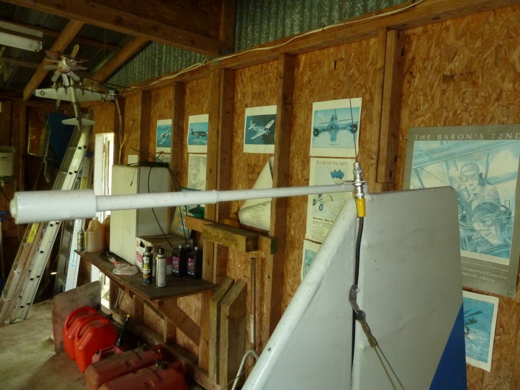

Clueless does not suit you well John, you are not that sort of guy - so here's a picture:
Several of us spent an afternoon a couple years ago testing various places on a Kolb for optimum antenna response. This works good on mine, ATC gives me a "5X5" from many miles away, with me using an ancient hand held. I suppose the counterbalance and top of the rudder is acting as a ground plane ahead and behind, and the brace wires on either side must do a better job than I would have expected.

PostPosted: Mon May 09, 2016 12:00 pm    Post subject: Kolb Firestar Progress report Reply with quote
Now I remember your post. zzzzzzzzzzzzzzzzzz
Can't keep my eyes open.
I have had good luck with my ICOM A6 and 21" ss whip antenna mounted under
the nose cone. On departure from the Rock House, south of Burns Junction,
Oregon, I was sending and receiving 5X5, 85 sm east, almost to the Snake
River.
I wouldn't know what to do with a real radio. Wink
Richard Pike

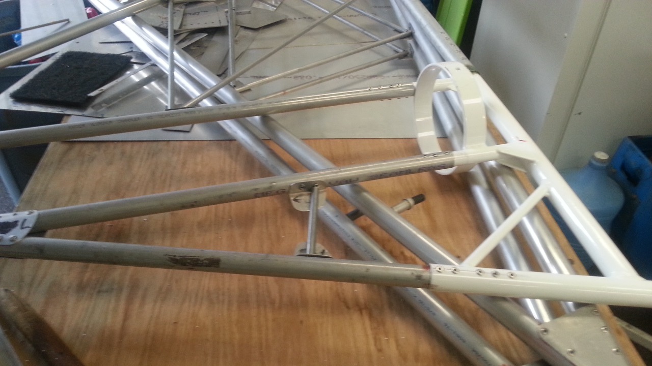

These are a few photos from the early
construction phase of the Firestar
If there is any forum rule that I am breaking or bending by
attaching these photos, please let me know. I have seen
photos attached to forum posts, but this is the first time I
have done so, so I would want to know if it is unwanted, or
problematic.
The airport bum holding the half built rudder is me. The
ribs have not all been attached to the trailing edge in this
photo, so it looks like some of them are hanging out in
space (which they are).
The other photos show the gusset method of attaching the
ribs to the leading and trailing edges.
One photo shows the fin assembly and the two stabilizers
under it. The red paint you can see at the gussets in that
photo is corrosion resistant paint that I applied, because I
used 2024 alloy instead of 6061 (had some 2024 on hand,
makes it stiffer and stronger at a critical area). I had run
out of Zinc Chromate, and had some corrosion resistant
enamel of a different color. Very hard to get Zinc Chromate
in California... the EPA guys are not happy with it !
Bill Berle

Finished the rudder and started on
the elevators.
The rudder was built using two equal length 5/16" tubes at
each rib location, serving as upper and lower "structural
rib cap" members, as opposed to the half-length tubes on
the
bottom as shown on the plans. The aft (trailing edge) of
these rib tube pairs were installed "side by side", in
order
for the thickness of the trailing edge to remain
unchanged.  Triangular sheet metal gussets were used to
attach these ribs to the leading and trailing edge tubes.
The small tubes were attached to the leading edge using
triangular gussets as well, providing four rivets (two in
the large tube, two in the small tube) and a structural
brace (the gusset) at this critical location.
The first elevator was started last night. In an attempt
to
improve the accuracy and quality of the rivet layout
WITHOUT
spending a large amount of time, I sketched out an
alignment
tool on the commuter train. This tool was fabricated from
aluminum angle in two sizes. The angle is laid down on top
of the sheet metal gusset and underlying aluminum tube
blank. Keeping the angle in contact with the (exposed) end
of the tube keeps the guide holes centered over the
part of the tube that you cannot see. It also holds the
drill bit from wandering off the apex of the round tubes,
which I'm sure everyone already knows is a very
frustrating
problem. Even the "snap punch" marking points do not
always
hold the drill from wandering.
Another helpful tip I found was to use the hand de-burring
tool (the one with a pointed sharp countersink bit mounted
on a weird shaped long screwdriver handle) to make the
snap
punch mark larger before drilling. This helped quite a
bit,
at the expense of a bit of time and changing tools back
and
forth between hands.
As mentioned previously, the very slight weight increase
by
using the gussets was accepted in return for a far more
robust attachment. This particular Firestar will never be
flown as a Part 103 ultralight.
I will try to attach some photos of a few of these details
to another post..... gotta find the photos taken by my
wife's cell phone....
Bill Berle

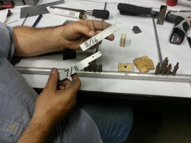

PostPosted: Fri May 20, 2016 2:00 pm    Post subject: Kolb Firestar Progress report Reply with quote
Here is a picture of the two little
tube drill jigs I designed. They allow drilling through the

PostPosted: Fri May 20, 2016 2:01 pm    Post subject: Kolb Firestar Progress report Reply with quote
Made progress on the first elevator
half tonight. Similar to rudder, triangular sheet metal
gussets at the intersections. Home-made quickie rivet
locator tool works well. I will probably make a better steel
one when I get to the ailerons because the ones I made from
aluminum are starting to wear after about 50 holes.
Bill Berle

PostPosted: Mon May 30, 2016 3:24 pm    Post subject: Kolb Firestar Progress report Reply with quote
Bill, Your photos show single tubes from leading edge to trailing edge. Is this according to your Kolb plans or your own modification? Every Kolb flight surface I’ve ever built required a second tube for triangulation in order to transfer the input torque to the control surface.Here is a graphic that will hopefully show what I’m concerned about.

PostPosted: Mon May 30, 2016 10:04 pm    Post subject: Kolb Firestar Progress report Reply with quote
Hi Gene, thank you for the inquiry. I probably attached a photo to the original e-mail that showed the elevator under construction, not completed.
My control surfaces do indeed have "triangulation". There is an upper and lower structural rib "cap" at each rib location. The "Caps" are standard Kolb 5/16" tubes just like the plans show.
BUT... instead of the standard Kolb design of riveting the tubes directly to the leading edge and trailing edge, I attached them using .032" aluminum gusset plates. This is actually permitted and shown on the Kolb plans near the back of the plan set as an alternate method of attaching the (upper) rib tubes to the trailing edge tube.
What I did that was completely different than the plans is this:
1) The front of the upper and lower rib tube attach is done using a gusset at the top and another gusset at the bottom, with the rib tubes approximately FLUSH with the top and bottom of the leading edge tube. This is somewhat like the method used in the Graham Lee and Robert Baslee Nieuport replicas

Eugene Zimmerman
Posts: 392
PostPosted: Tue May 31, 2016 3:04 am    Post subject: Kolb Firestar Progress report Reply with quote
On May 31, 2016, at 2:01 AM, Bill Berle <victorbravo(at)sbcglobal.net (victorbravo(at)sbcglobal.net)> wrote:
Bill.
My concern is satisfied. The photo of completed elevator looks very good.
Gene

Thank you all for the replies. I enjoy this discussion, and I enjoy having people call my ideas into question, which keeps me sharp and makes me defend my decisions. As such, PLEASE do not take any offense at me for going through my "defense" below, as an exercise to quantify and qualify the reasonableness of the decision.
As far as the weight gain by doing the control surfaces slightly different than the plans, I was well aware that there was going to be a weight gain but I believe it is very small. At each individual rib station, the difference would be as follows:
1) Bottom rib tube (5/16") will be about 4 inches longer (heavier) at the rear, because it reaches all the way to the trailing edge.
2) Top and bottom rib will each be about 3/8 inches shorter (lighter), because they no longer overlap the leading edge tube.
3) Addition of two gussets at top/bottom of the leading edge, approx. .032 x 6 square inches total.
4) Addition of one gusset at the top of the trailing edge, approx. .032 x 3 square inches.
5) Eight additional 1/8" steel pop rivets (12 instead of 4)
From Aircraft spruce website:
.032" aluminum sheet weighs .45 pounds per square foot. That is .0031 pounds per square inch. 9 square inches is .0282 pounds, or .45 ounces for all three gussets.
5/16" x .049 wall tube (slightly heavier than .035 wall) is .0423 pounds per foot, and 4 inches is a third of a foot, so that extra piece of tube is .0141 pounds, or .2256 ounces (slightly less than a quarter of an ounce).
The rivets weigh something, but Aircraft Spruce doesn't list the weight. I will GUESS that 8 rivets weigh about a quarter of an ounce. Now remember, 80% of the rivet mandrel is broken off and goes into the garbage can, so we only count the weight of the rivet parts left int he airplane.
So as a rough approximate, it appears that my modified rib assemblies will weigh about an ounce more than the stock rib. So what did I get in return for the extra time and effort and weight?
Although the rib tubes do not sit on top of the leading edge tube any more, and as John H points out they are indeed closer to the center of the leading edge tube, the "shear plane", or the actual contact point between the two parts is in the same place... at the top and bottom tangent point of the leading edge tube. So if the loads on the rib tubes were critical (the structure is "maxed out" and on the verge of collapse), the rib tubes could buckle in compression a little sooner on my design than on the original Kolb design. BUT, the Kolb design holds the entire rib tube / leading edge tube joint together with one rivet, it is very likely that the rib tube is on the verge of a compression failure.
But on my version, there are six rivets and a reinforcement gusset, which spreads that shear load (the rib moving fore-aft or side-side relative to the leading edge tube) across six rivets, and prevents any rotation (rib tube swinging around the original single rivet). So it seems to me that there is not only a greater amount of strength (resistance to pulling the joint apart) but also a large improvement in stiffness (movement before it pulls apart).
Near the trailing edge of the rib, the original Kolb rib "ends the triangulation" several inches forward of the trailing edge. This means that the last few inches of the entire control surface is simply one thickness of 5/16" rib tube and a trailing edge tube. Considering that the Kolb instruction manual tells you that this 5/16" tube is easy enough to bend by hand, it certainly seems to me that there is a very small amount of stiffness or bend resistance anywhere aft of the triangulation joint. On my modified design, the lower rib tube goes all the way to the back, and so the "triangle" is rigid all the way to the trailing edge. This results in a stiffer and stronger control surface.
For FLIGHT loads, the trailing edge itself does not do very much... it's only there to wrap the fabric around. This can be proven out by looking at hundreds of WW1 airplanes that used only a thin wire as the trailing edge of the control surfaces. But the loads put on this area during off-airport operations, rolling through brush, and ground handling, folding the tails, trailering, and brushing past the controls... those are probably far more of a damage risk than anything that you will get in the air. That may be why Kolb originally accepted the weight and left the trailing edge tube on instead of using a string or wire like an old WW! plane??
One person was kind enough to post that they had tried sheet metal ribs instead of the tubes, but it was too heavy. My Cessna 172 might not even use .032" sheet metal in the control surface ribs, I'm guessing it's .025 or perhaps even .020. Certainly for a very light aircraft like a Kolb, .016 or .020 would be plenty of thickness for the aileron ribs.
Another possible justification for my "stronger" control surfaces is that I will be using the 60HP HKS engine, and this will probably create a little more thrust than the 447/503 engines. A little extra thrust will create a bit more air loads on the control surfaces. Since this will primarily be an off-road machine, I will probably wind up whacking a few more bushes and ground shrubs than some other types of flying.
BUT... the fact remains that if for any reason I'm unhappy with the control surface weight, I have the options to rebuild these back to stock, or to build new stock controls.
Anyway, thanks to everyone again for participating in this, and keeping me on my toes. I appreciate it.
