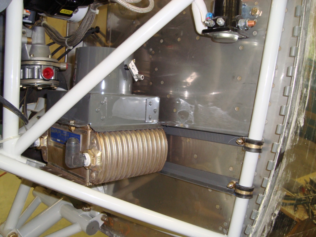

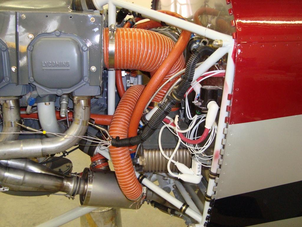

Perhaps you need to gather more data and decide if you have a problem or not. Assuming you started off well heat soaked and that you are climbing with both high temperature and humidity, these numbers are not that far out. Your 300 fpm climb however is way low - perhaps that was an anomaly in data collection.
I climb at 130 kts IAS after the initial takeoff to promote cooling (using a James cowl and plenum that I am very happy to have). At gross this provides perhaps 800 fpm on a hot day. I'm typically watching CHT as I've never had oil temps above 220 or so. After 6000' or so I'll start leaning to keep EGTs up at about what they started with. After 6000' CHTs start to come down as engine power is going down with altitude.
In cruise on a hot day I have the oil cooler door half shut to keep oil temp above 180. CHTs are in the 340 to 360 range.
If after you do your flight data analysis you still think you have an oil cooling problem, you can look at what others have done. I'm using the Airflow System 2006X cooler (same dimensions as the Van's 20006A cooler). http://www.aircraftspruce.com/catalog/eppages/xseriesOilCooler.php
The attached photos show how I mounted the cooler. Not shown is a bracket on the forward end of the cooler attaching it to the engine mount with an Adel clamp.
Carl
 Filesize:  340.29 KB
 Viewed:  16653 Time(s)
 Filesize:  137.88 KB
flying-nut(at)cfl.rr.com
PostPosted: Fri May 27, 2016 2:41 pm    Post subject: Oil capacity Reply with quote
Thanks for the pics. The original cooler mounting spot just dumps the
hot air into a really dead air spot which makes me wonder just how much
differential air pressure is across the cooler. I hope to find out if I
have a problem early next year.
Linn
On 5/27/2016 5:04 PM, Carl Froehlich wrote:
[quote] Perhaps you need to gather more data and decide if you have a problem or not. Assuming you started off well heat soaked and that you are climbing with both high temperature and humidity, these numbers are not that far out. Your 300 fpm climb however is way low - perhaps that was an anomaly in data collection.
Carl
