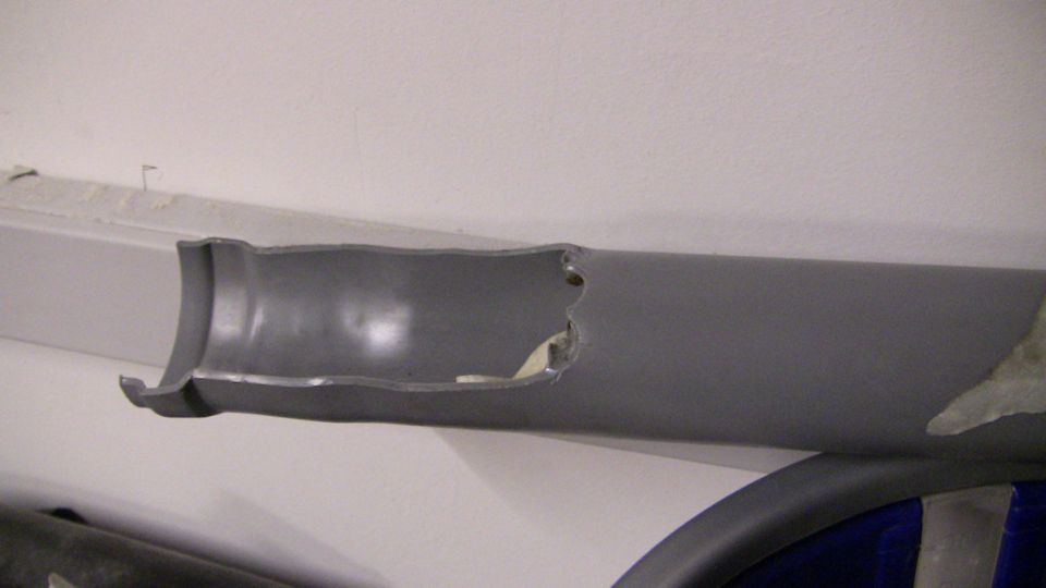

PostPosted: Thu Jun 09, 2016 1:06 am    Post subject: Tools for Oil Change Reply with quote
I did my own funnel from a 2" plastic tube a bit of cutting and heating.
Works as expected and a clean engine compartment!
