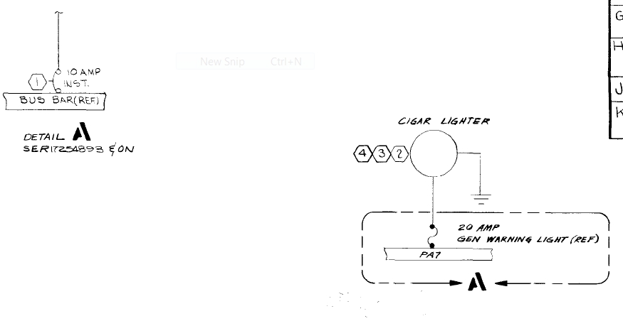

How much stuff do you plug into the cigar
lighter? On many Cessnas of the 1970 time frame
the cigar lighter was powered through a 20A fuse
and later a 10A breaker. 10A is a LOT of 'stuff'
to run from such a connector
[img]cid:.1[/img]
 Filesize:  40.34 KB
 Viewed:  2262 Time(s)
 Filesize:  58.96 KB
<6bca066.jpg>
