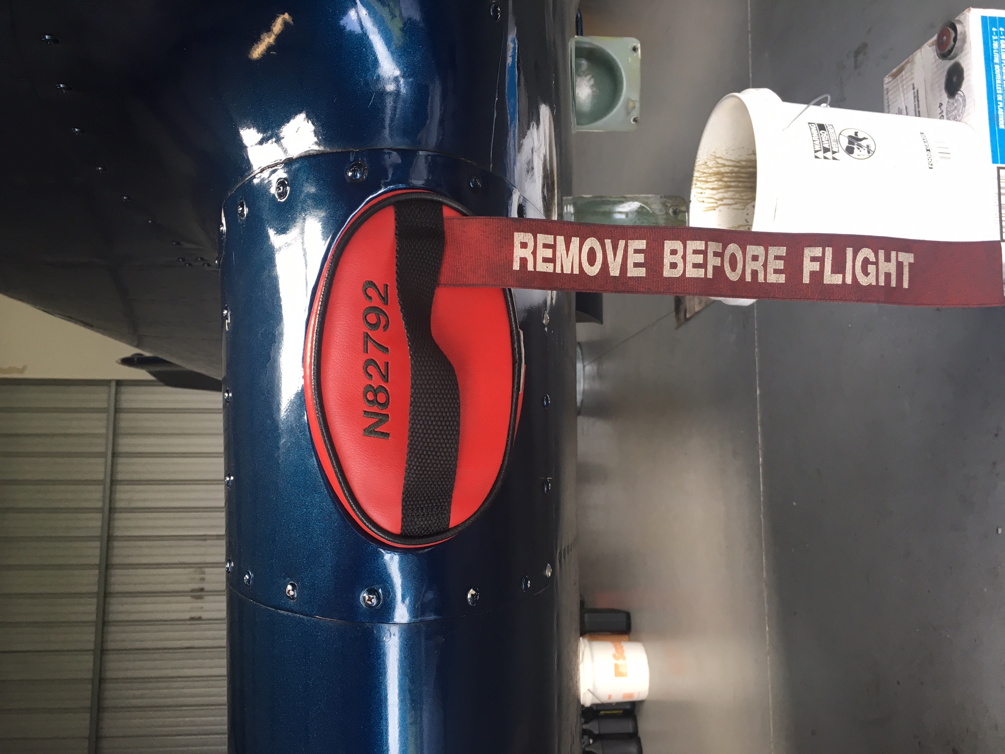

Bruce's covers sells them and will put your reg number on them ; $40 usd a few years ago. www.aircraftcovers.com , 408-738-3959.
[img]cid:6DA873D2-5CB4-4E71-917C-EEA9B6107BF0[/img]

Bruces covers
On Jun 29, 2016, at 09:15, Hank Gibson <hkgibby(at)yahoo.com (hkgibby(at)yahoo.com)> wrote:
Bruce's covers sells them and will put your reg number on them ; $40 usd a few years ago. www.aircraftcovers.com , 408-738-3959.<image1.JPG>Sent from my iPhone
