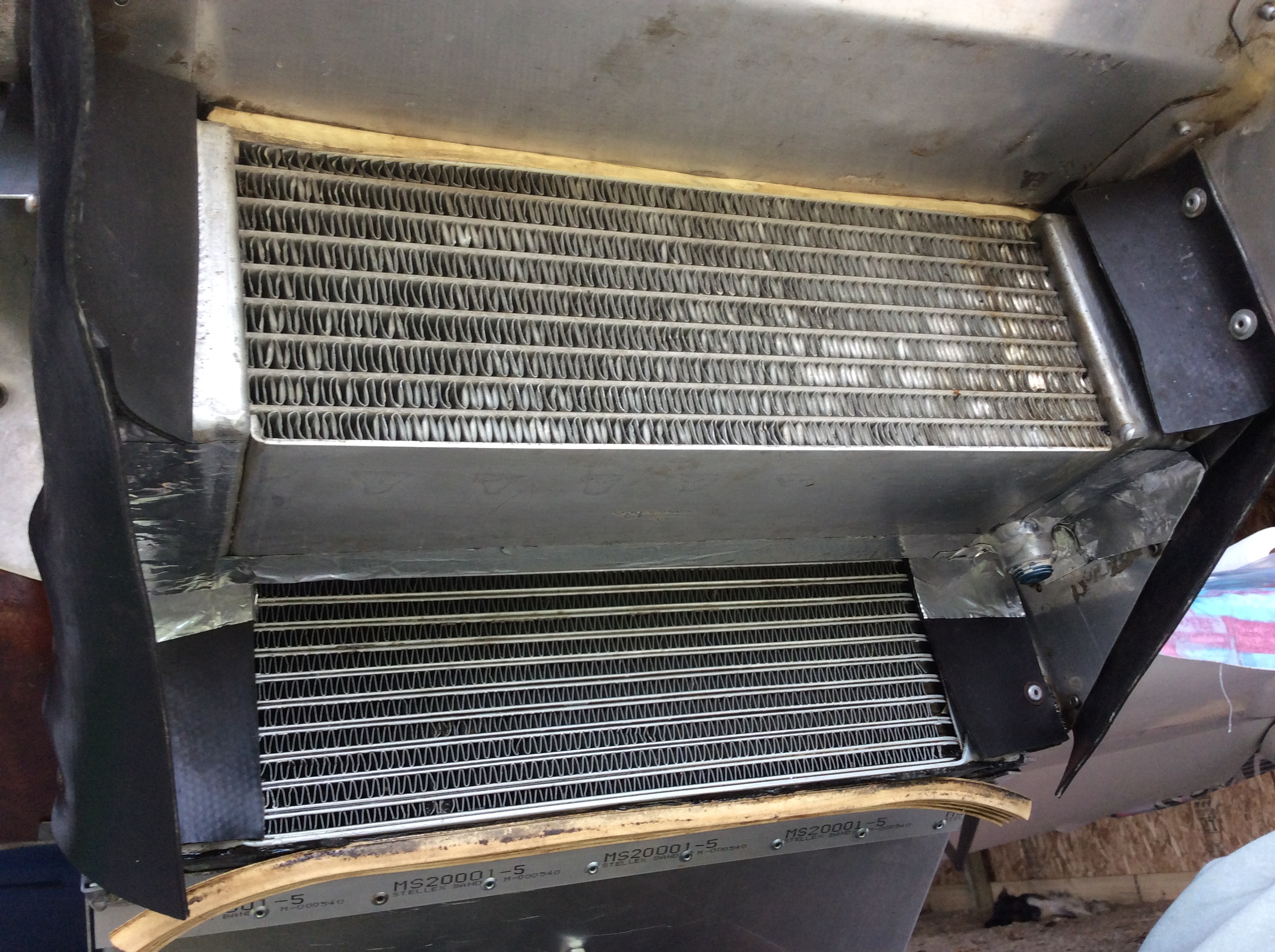

It looks like the air can go around the coolers. Here is a photo of how we use aluminum tape, rubber and weatherstripping to seal the gaps so the air has to go through the radiators. That might be your first step. It does not require fiberglass work and is easy to do.
It is hard to tell from your photo, but if the builder did not smooth the cowl entrance to the coolers, the air coming in will be disturbed, so that is another item to check.
We also recently added a cowl flap, copied from Erich Trombley, which has reduced cooling drag.

PostPosted: Tue Oct 04, 2016 11:26 am    Post subject: Re: Cooling issues on the ground XS 914UL Reply with quote
Dear all,
Thank you very much for your help.
I'll start to close all gaps around the radiators and then check out the improvement, before doing some more improvements.
Probably I'll come later back to you, especially to Gilles, Jim & Heather for some detail questions.
