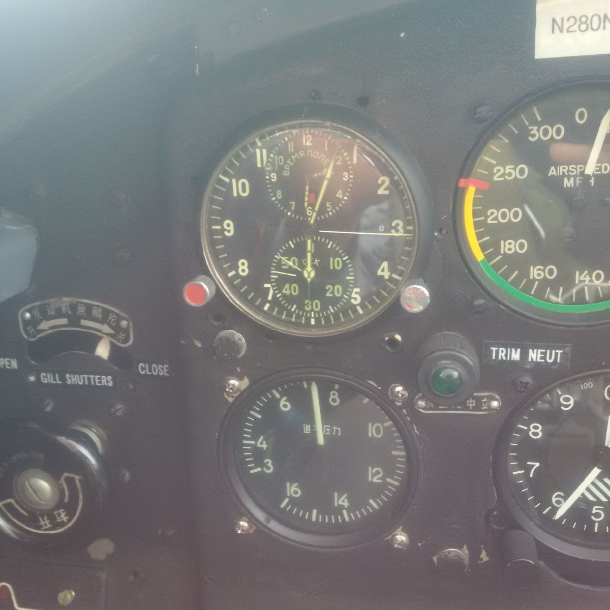

[quote] Gents, while we're on the topic, I've never used my CJ6's Soviet clock all
that much. I'm wondering what the red button/knob on the left does? Photo
attached. (I see that depressing it flips a red flag to white in the top
dial...) The silver knob on right is for on/off, but needed for winding by
any chance? Or draws its power from the main a/c bus?
Can anyone give me a quick tutorial on the clock's functions?

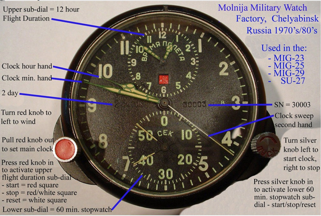

This might help you….
Cheers
Chris

Yes thanks gents, all VERY helpful info -
Justin

I am glad to be able to assist.
I wish I could claim credit for the picture, but I got it off the internet somewhere.
I have one of these clocks sitting on my desk and while I am a typical male who can usually stuff it up without printed help, I had to hunt down some instructions on how to drive the thing.
If the clock is inaccurate, you can also adjust the ‘speed’ by twiddling a screw on the rear.
Chris
Chris

Gents, while we're on the topic, I've never used my CJ6's Soviet clock all that much. I'm wondering what the red button/knob on the left does? Photo attached. (I see that depressing it flips a red flag to white in the top dial...) The silver knob on right is for on/off, but needed for winding by any chance? Or draws its power from the main a/c bus?Can anyone give me a quick tutorial on the clock's functions?
Thanks-  Justin/N280NC

Had my -52 on static display at the Royal Navy Yeovilton Airday this year parked up near a Polish Navy PZL M28 Skytruck and a MIG 15 ... despite a 40+ year range of production the one instrument we all had in common was the АЧС-1 clock!
For a regime that specialises in one-size-fits-all there are surprisingly two variants (usually marked on the dial);
АЧС-1 = second hand operates with clock, stopwatch sub-dial 60 minutes
АЧС-1M = second hand operates with stopwatch, stopwatch sub-dial 30 minutes
And for those interested here's the bullet form of the clock instructions;
- performs a conventional Clock function as well as a Stopwatch and an Hour Recorder
- outer scale is the main Clock & single sweep second hand
- upper sub-dial is the Hour Recorder (HR) and the lower sub-dial is the Stopwatch function
- two knobs are mounted to the outer bezel;
Left function knob
- normal position (IN) winds the mechanism
- pull OUT & rotate hands to set time on Clock
- push IN to change the ‘setting selection’ – interlink between Clock & Hour Recorder
- each push moves a flag in the Hour Recorder dial - alternates Red, Red / White and White
- corresponds to ‘Set Clock & HR’, ‘Set Clock, Stop HR’ & ‘Set Clock, Reset HR’
Right function knob
- turn counter-clockwise to run mechanism, clockwise to stop
- push knob to cycle Stopwatch function: Start – Stop – Reset
Using the Chronograph
- Right knob turn clockwise - ensure mechanism stopped
- Left knob - wind mechanism spring until it begins to tighten
- Left knob: push knob IN until White flag shows, pull OUT to set the correct time & push IN
Red Flag : the White flag is replaced with a Red flag indicating system fully engaged
- turn Right knob counter-clockwise to run the Clock and the Hour Recorder
- Stopwatch functions (push right knob IN) available
Red / White Flag : appears on second push IN of Left knob
- Hour Recorder stopped, main clock continues
- Stopwatch functions still available
White Flag : appears on third push IN of Left knob
- Hour Recorder reset, main clock continues
Rob R.
