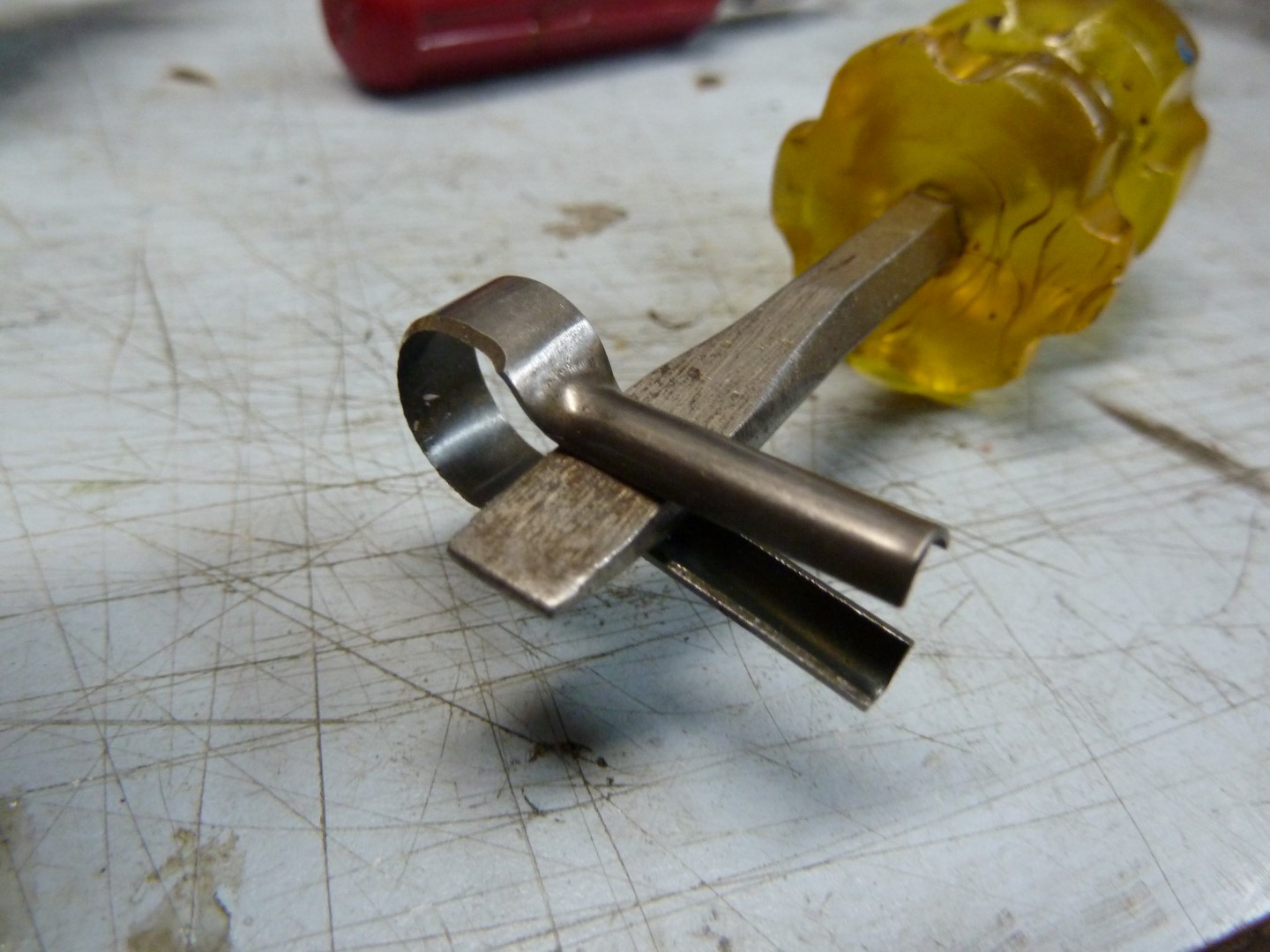

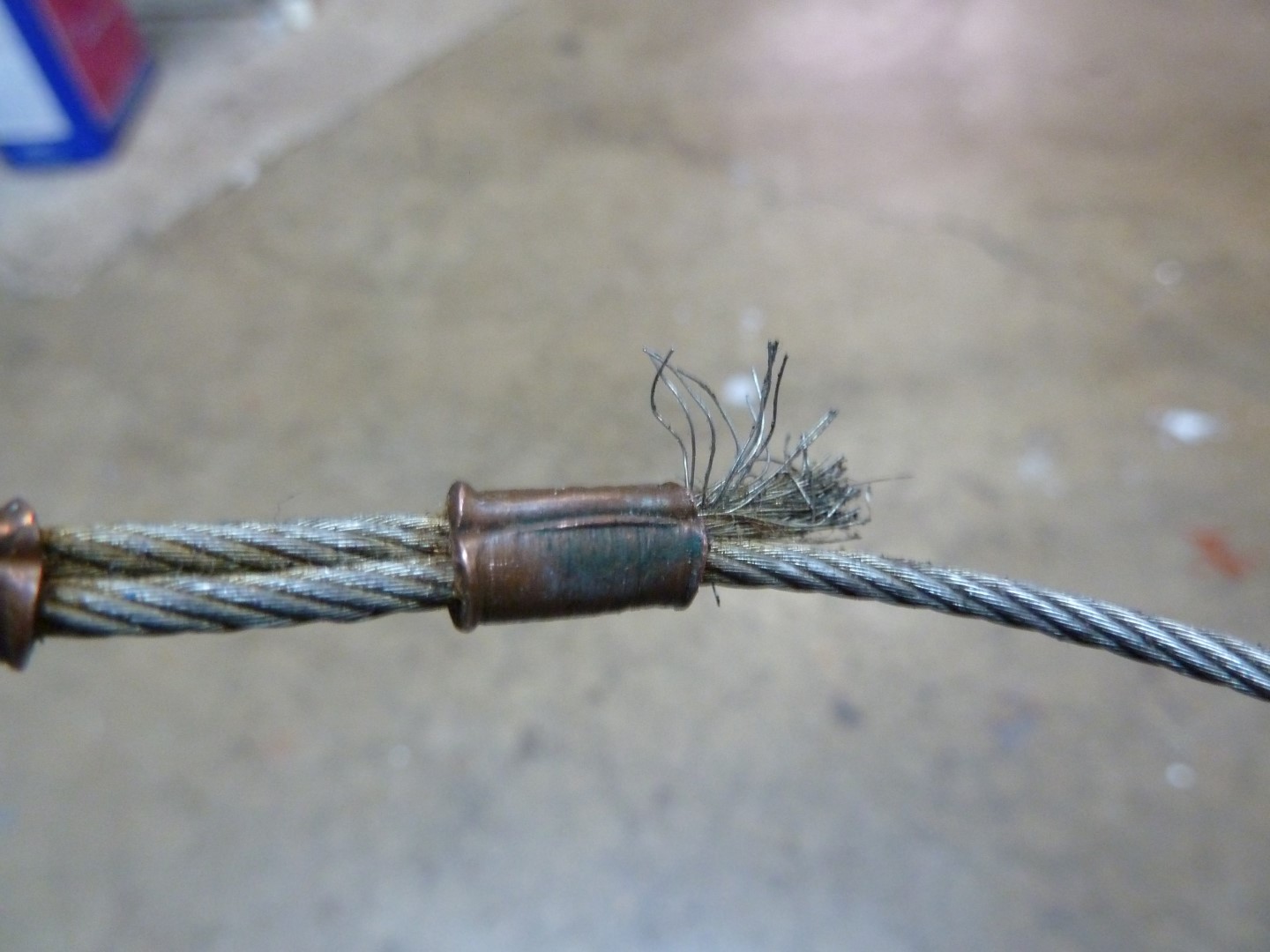

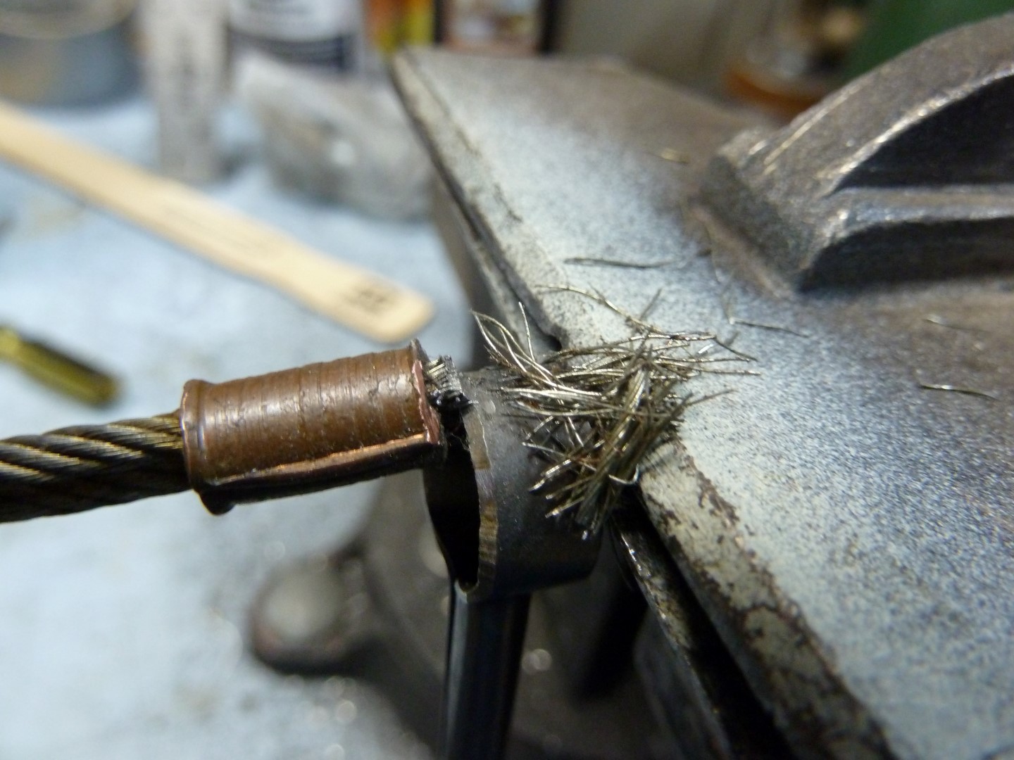

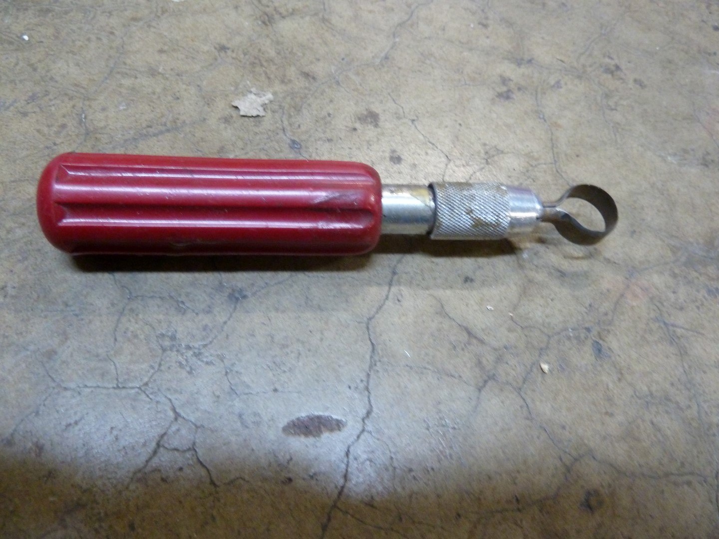

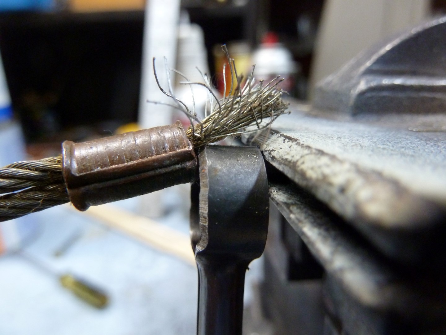

Spent a few minutes in the garage this afternoon, and this worked so well it needed sharing.
Had a set of used rudder & elevator cables that we are going to be using in the Firefly, they are in good shape except that the ends are pretty ratty. How to trim them off without taking a chance on nicking them?
Use a round x-acto knife blade. Used a screwdriver to spread the blade tang so it would slip over the cable. Work the tapered edge up against the swedge. Clamp the sheet metal vise grips in the vise, used them to hold the cable, and hold the blade tight against the swedge. Used the cut-off wheel on the Dremel and buzzed off the raggedy wires.
Easier to do than tell about. Did all four wires in about ten minutes.
