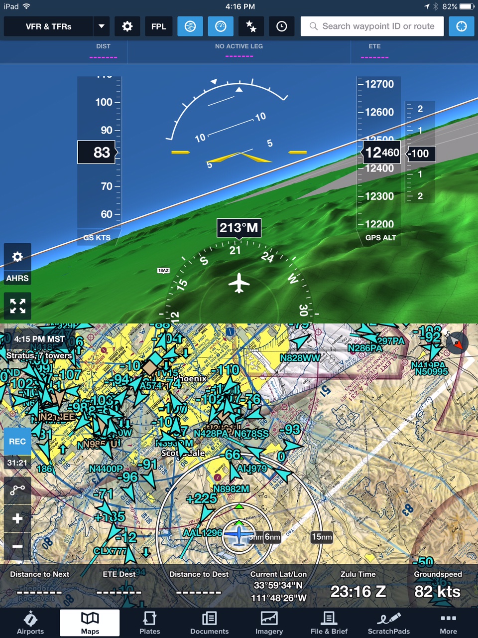

The best part is the ADS-B IN component, which provides traffic and weather on the iPad. The Stratus 2i (basically the same as the 2S but without a battery since it gets power from the transponder) also has an AHRS in it so the iPad can show a Primary Flight Display with synthetic vision. The Kitfox now has fancier instruments than the Turbo Arrow!

I went with the Appareo because it is the least expensive one I could find, it's on the FAA's approved list for the incentive program, and I have experience with the Stratus portable ADS-B IN units which work very well with ForeFlight Mobile on the iPad. The Stratus ESG (a mode S transponder that does the "out" part) is $2,995 and the Stratus 2i (the AHRS unit does the "in" part) is an additional $500. The Stratus 2i is basically the same unit as the Stratus 2s portable but does not have an internal battery because it draws power from the transponder.

The older I get the more I shy away from the bleeding edge but the technology is way past the "up in the air" stage (I assume no pun was intended Smile. The FAA is heavily invested in the technology and the ground infrastructure is completely built-out.
I suspect if the President is looking to save $$$ on airspace he'll move forward with ADS-B since it transfers a big hunk of the cost to users rather than ground-based RADAR that the FAA has to pay to maintain.
For those of us that live in congested airspace, the benefits of ADS-B IN are dramatic.

I envy your AHRS. They're working on it for the Stratux, but it hasn't
worked out yet. I'm sure it will in time.

I've installed the Appareo ESG ADS-B transponder and 2Si because I did not like having the traffic "sometimes". Still not perfect, it does not show non-transponder equipped aircraft, sometimes planes drop out for no reason and sometimes they all drop out when the radio station gets blanked by terrain.  But still worth having and has been great when flying with friends, able to track them from any distance.
