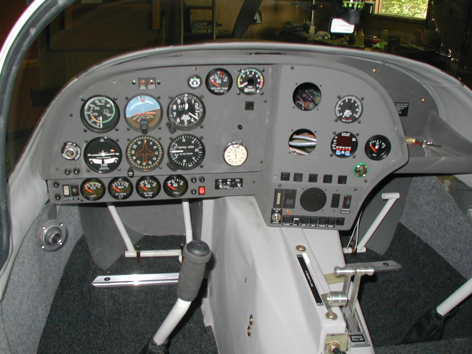

Hi I endorse what David says. I had my panel nexteled in 2006. still looks good. I attached a pic.
Danny. G-C.E.RI.
