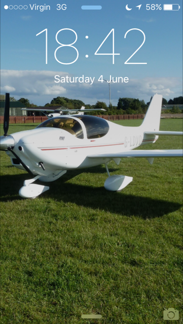

Hi Graham,
I built the Mono G-LDVO as i was looking for efficiency and speed for touring which is what the Mono excels at.
I converted my Mono to Trike after a near crosswind event which almost took my prop - Airmaster!!
I compromised on the speed, only a few Knots and efficiency, a little more significant as weight now 906lbs.
Ground handling is simple, crosswinds can be handled with a confidence i didn't have with the Mono. Doing longer touring trips its nice to know i can handle crosswinds safely wherever i end up without getting stranded with a bent prop or worse.
Maintenance is easier as removing wings leaves the fuselage standing without extra support.
The conversion is straight forward. The nose wheel leg is easily done, i used springs instead of bungee.
The main legs need careful jigging on a secured fuselage. This is the biggest job and needs two people peeping fibreglass and resin and applying. I had the help of Neville Eyre who did most of the install of the main legs. I would recommend you get someone with similar experience to help.
Upside--- A novice could fly the Trike with confidence. Resale value!!
Easy the maintain.
I still cruise at 120kts at 24" one up.
Downside--- Weight - load carrying capacity.
If i was building another it would be a Mono to retain efficiency. But that is a personal choice.

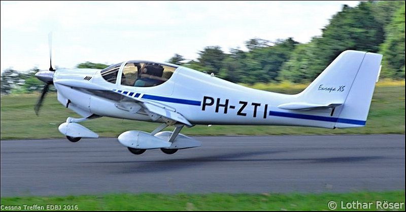

With my average flying skills I didn't even consider to buy a Monowheel after Andy Draper took me up for a ride in the factory demonstrator G-GBXS.
However I also didn't even consider building one either with my less than average mechanical skills.
I just enjoy flying my Trigear and can well live with the little shortcomings in weight and speed Smile
Roland
PH-ZTI
XS TG 914 (which started its life as a Mono in Perranporth)
