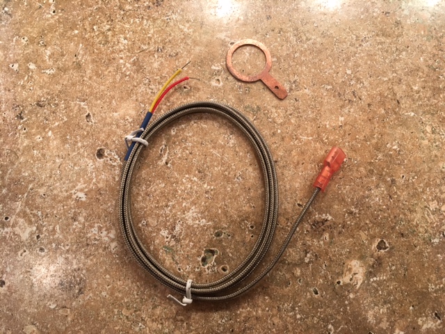

I recently purchased the MGL 18mm spark plug CHT probes from Aircraft Spruce.  The photo on both their website and MGL's shows a copper ring soldered to a K-type thermocouple wire, a pretty standard setup.  What they sent me is pictured below.  Since the bare wire ends connect directly to the RDAC brain box, I deduced that the other end- a 1/4 PIDG fast-on, crimped to the thermocouple wires- must just attach to the copper ring.  The tab end of the copper ring is exactly 1/4 inch, so this makes sense.
This seems like a pretty cheeseball setup.  From what I know of K-type thermocouples (mostly from reading the 'Connection) that wires must be silver soldered to the probe and to each other.  Or, am I mistaken and is this a reasonable setup?
I am also reaching out to MGL about this, but I thought I'd ping this group for your thoughts as well.
