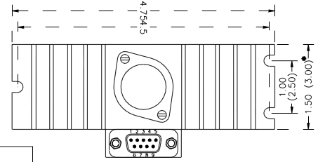

PostPosted: Tue Apr 25, 2017 4:11 pm    Post subject: TSU'd Usb charger?? Reply with quote
At 11:30 AM 4/25/2017, you wrote:
Bob
Could you right up the details on building our own Quiet USB charger?
The task is four-fold.
(1) You need a quiet 5v source.
Easy to get with an number of linear regulator
devices. Assuming you want to craft a "high power"
source (2A) you'll need a device rated for that
kind of current or more. There are dozens of
suitable candidates. Here is but one
http://tinyurl.com/l227b8c
http://tinyurl.com/k37l6kz
(2) Then you need to mount it to a heatsink that will
keep it operably cool while dissipating (14-5)x2
or 14 watts. This will look something like this:
[img]cid:.0[/img]
(3) Then you need to wire a USB connector with the
appropriate resistor network that tells your
portable appliance that this is a high current
USB power source and it's okay to load it
accordingly. I'm not cognizant of the details
for selecting these 'configuration telltale'
resistors . . . perhaps someone on the List has
researched this.
(4) then you need to package all this stuff
in a manner that offers some aviation grade
robustness.
