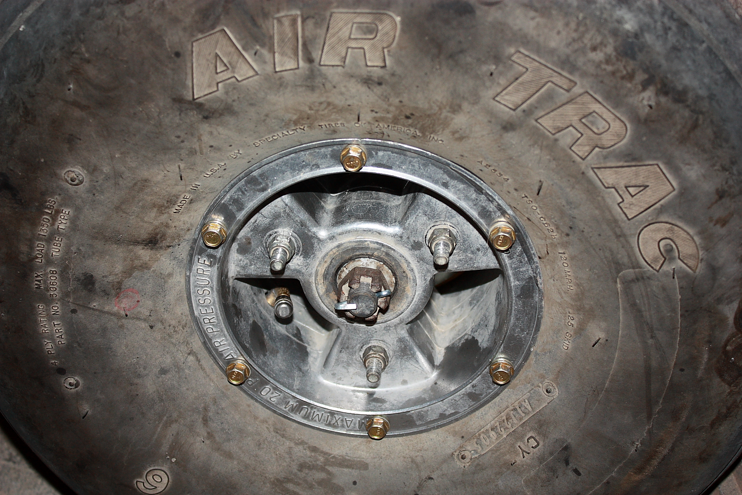

I tried to run the 800x6 tires with fairly low air pressure - 6-8 lbs,
and spun a tire, shearing off the air nipple. So I got some tire
screws and drilled 6 holes in the rims both sides and screwed the rims
to the tire. 6 per side. It worked fine.

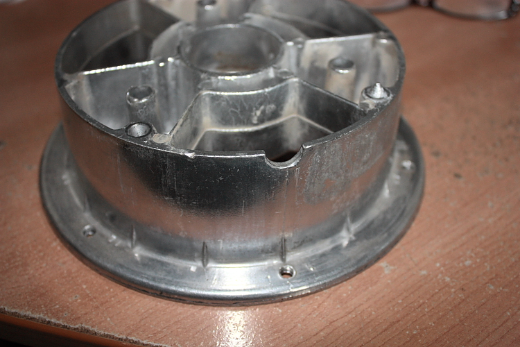

I just went out and took an Azuza rim apart and stuck it in the Tundra
850x6 tire. If you push it so that the ribs that you can see on the
rim engage, it does snap in and you cannot "easily" turn it. I do not
trust it to not spin however, so if I use these rims again, I will
screw them to the tire. If I do decide to wait for Matco to finally
produce the rims that I have already paid for, I will also screw them
to the rim as well rather than take a chance on spinning them.
The attachments are of the 800x6 air tracks with 6 lbs of air and screws.
The other is of the "ribs" in an Azuza rim that is apparently designed
to keep the tire from spinning.
The screws are from JEGs and are designated for the purpose of
screwing the tire to the rim. Therefore they cost a lot more than a
regular sheet metal 3/4 in screw. The holes in the rim are small
enough for the screw to cut threads. Just in case you decide to go
with the regular screws.
You get to make your own decision.
Larry
