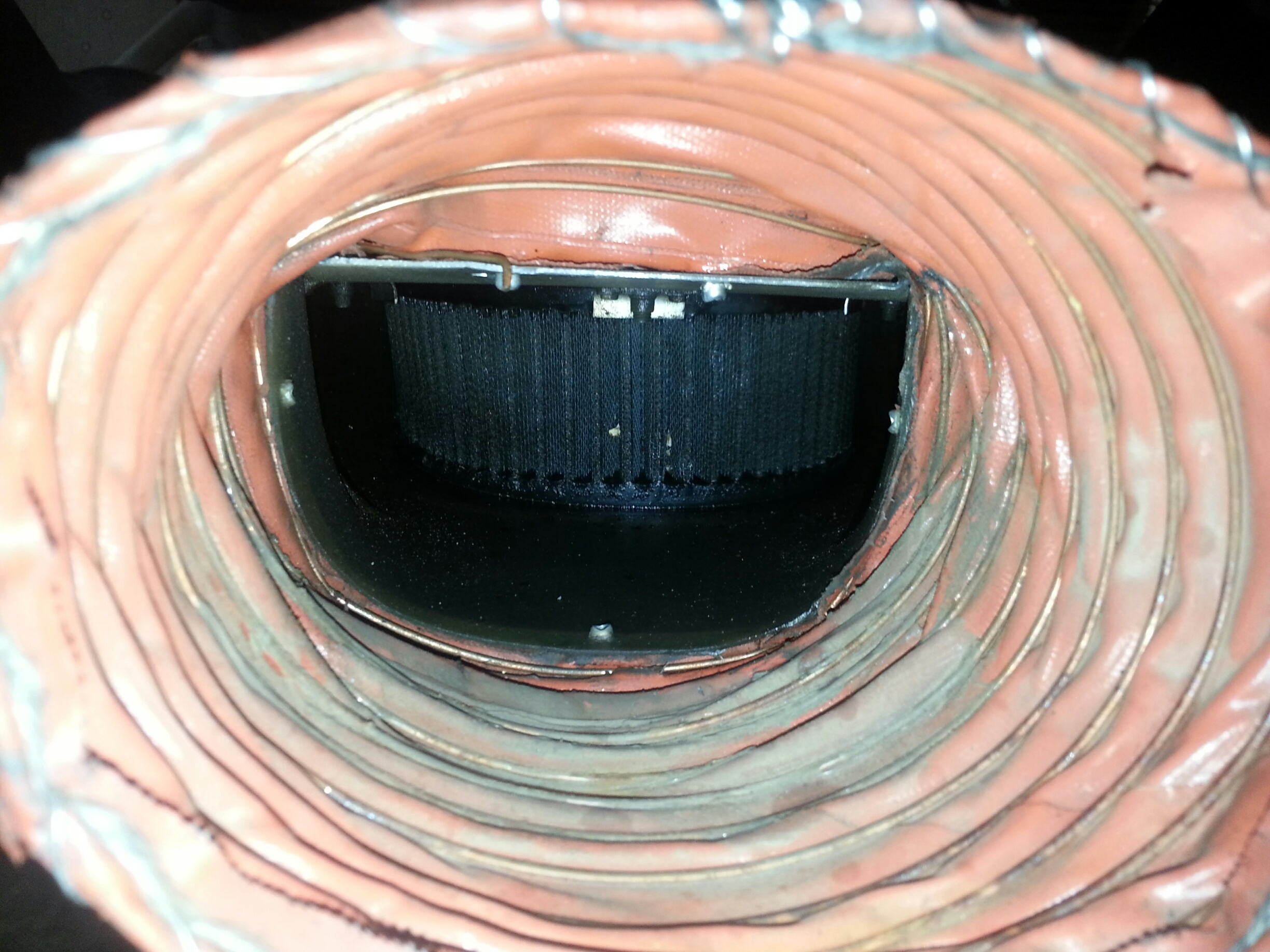

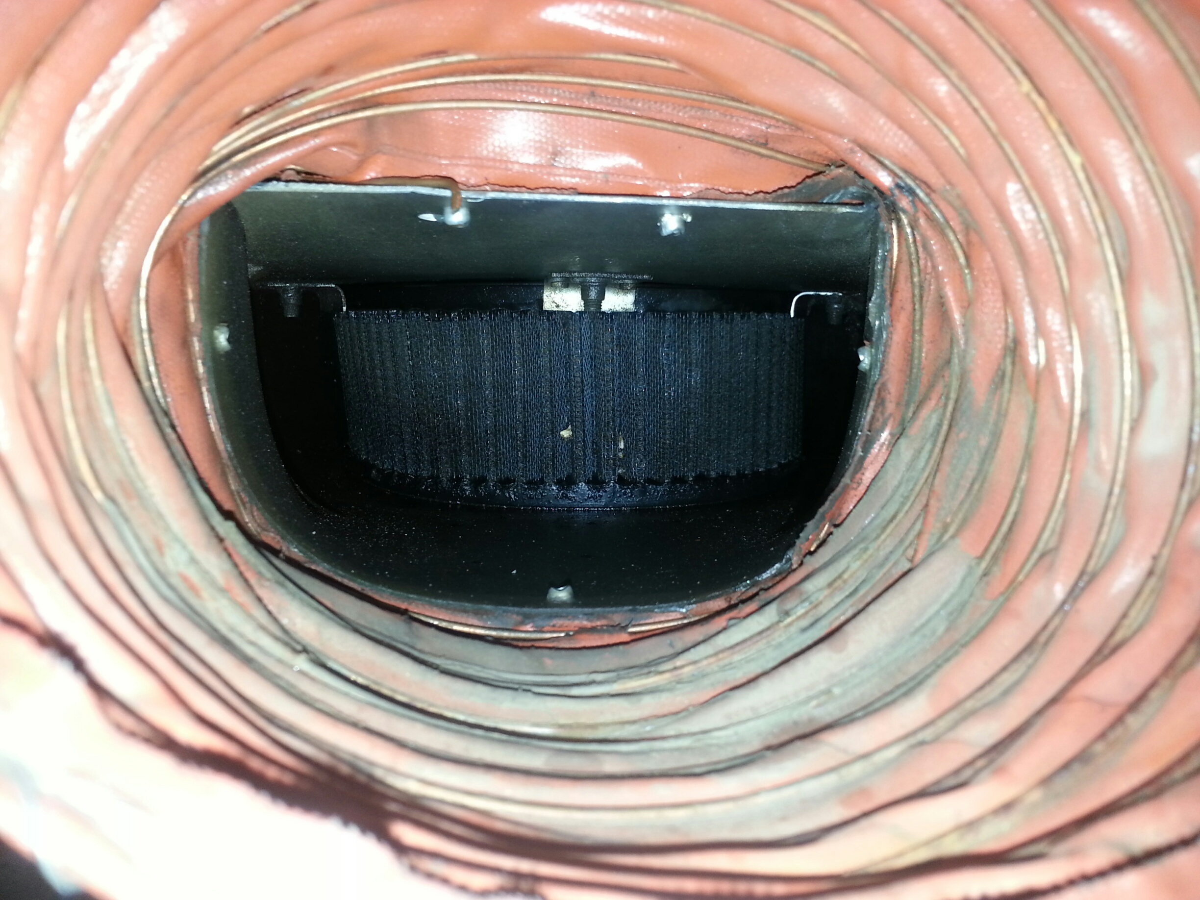

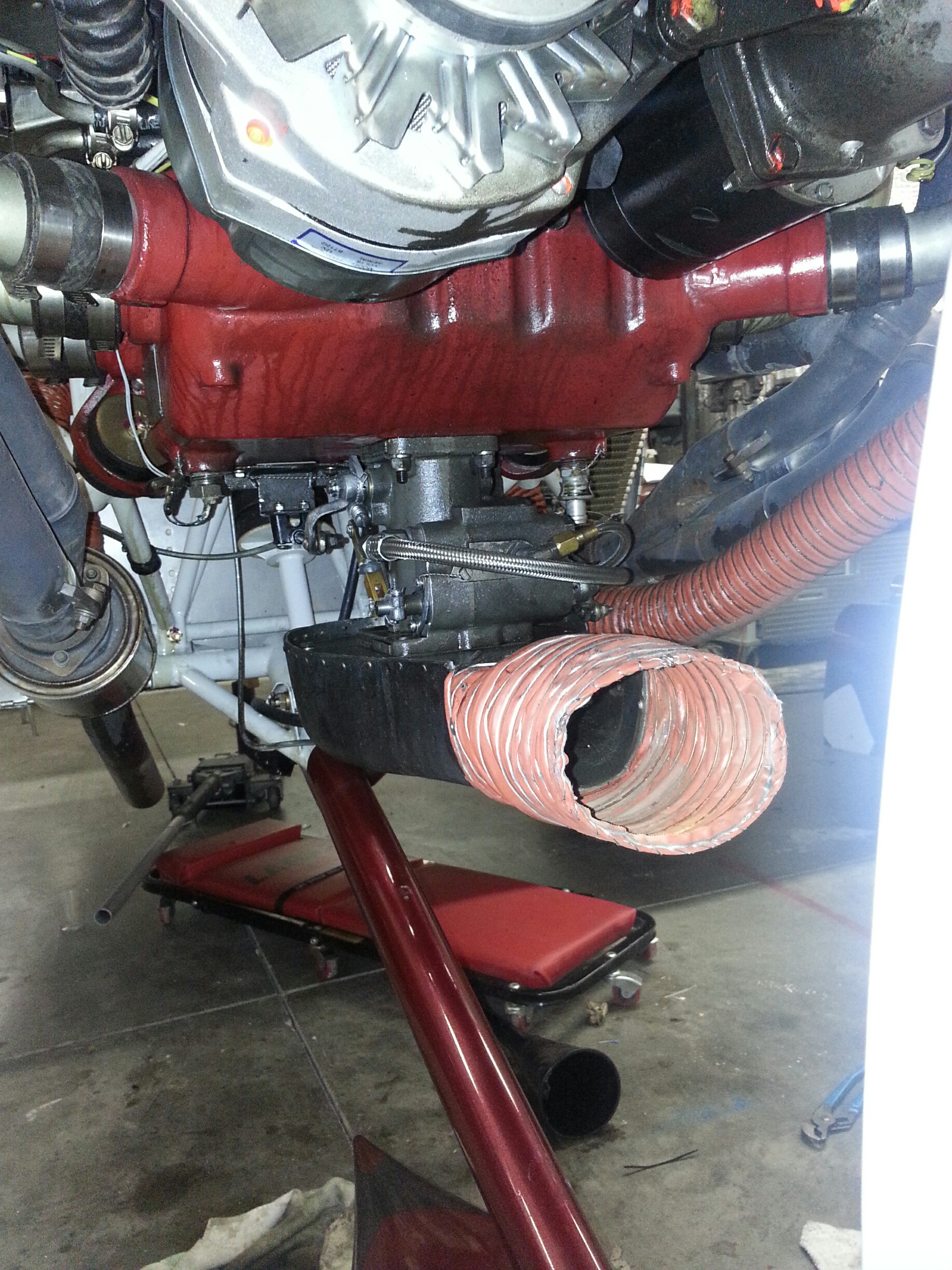

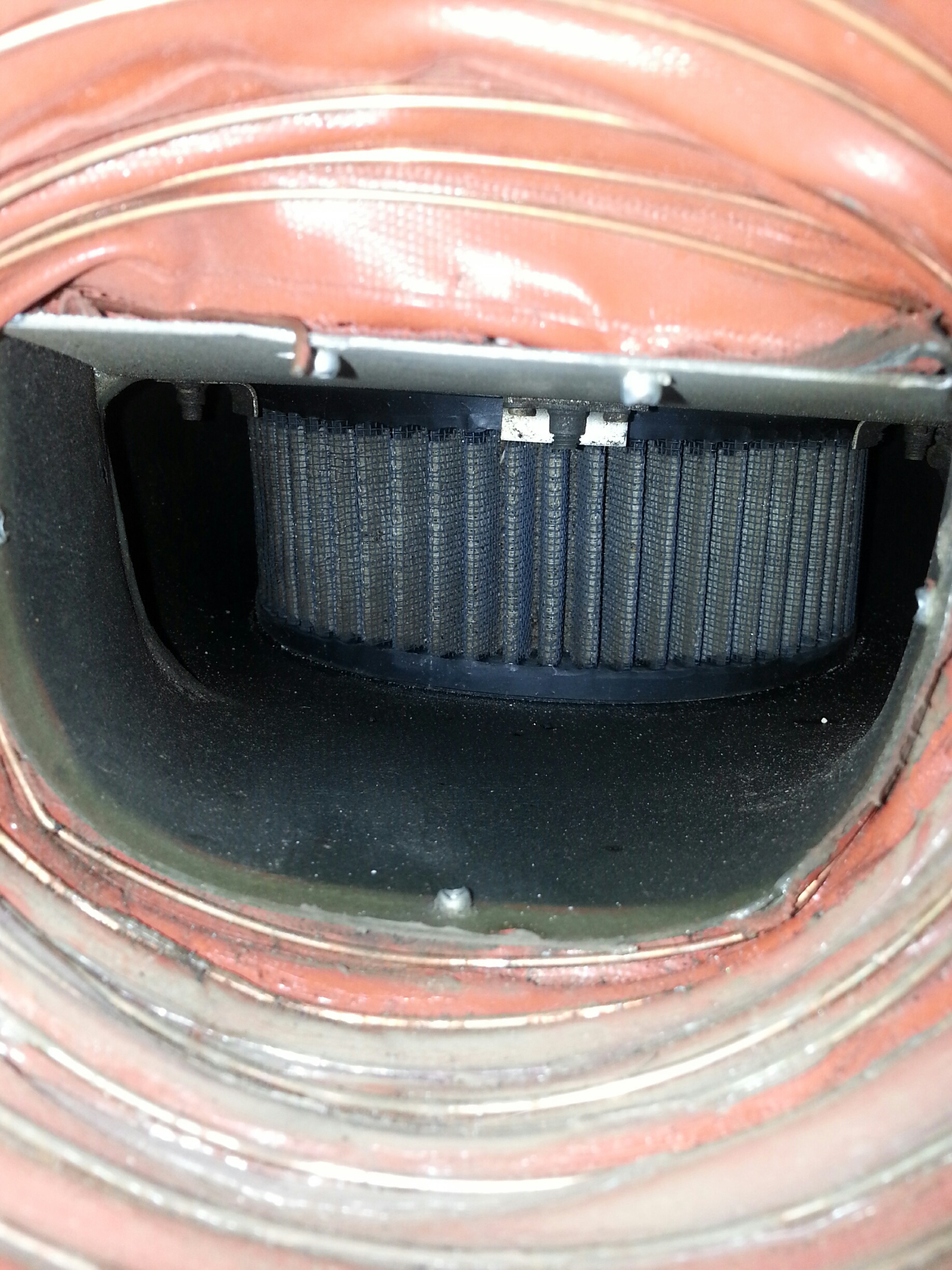

I used 4" scat ducting.
Attach it with pop rivets to the air cleaner.
I Compress it with some tie wire against the air cleaner when the lower cowling is off.
Just need one wire to hold it back while installing the lower cowling.
Install lower cowling, cut the tie wire, release the scat hose.
It compresses great against the lower cowling flange.
Air tight and easy.
402 hours RV 10 no problems.
Thanks, Jim Villani
