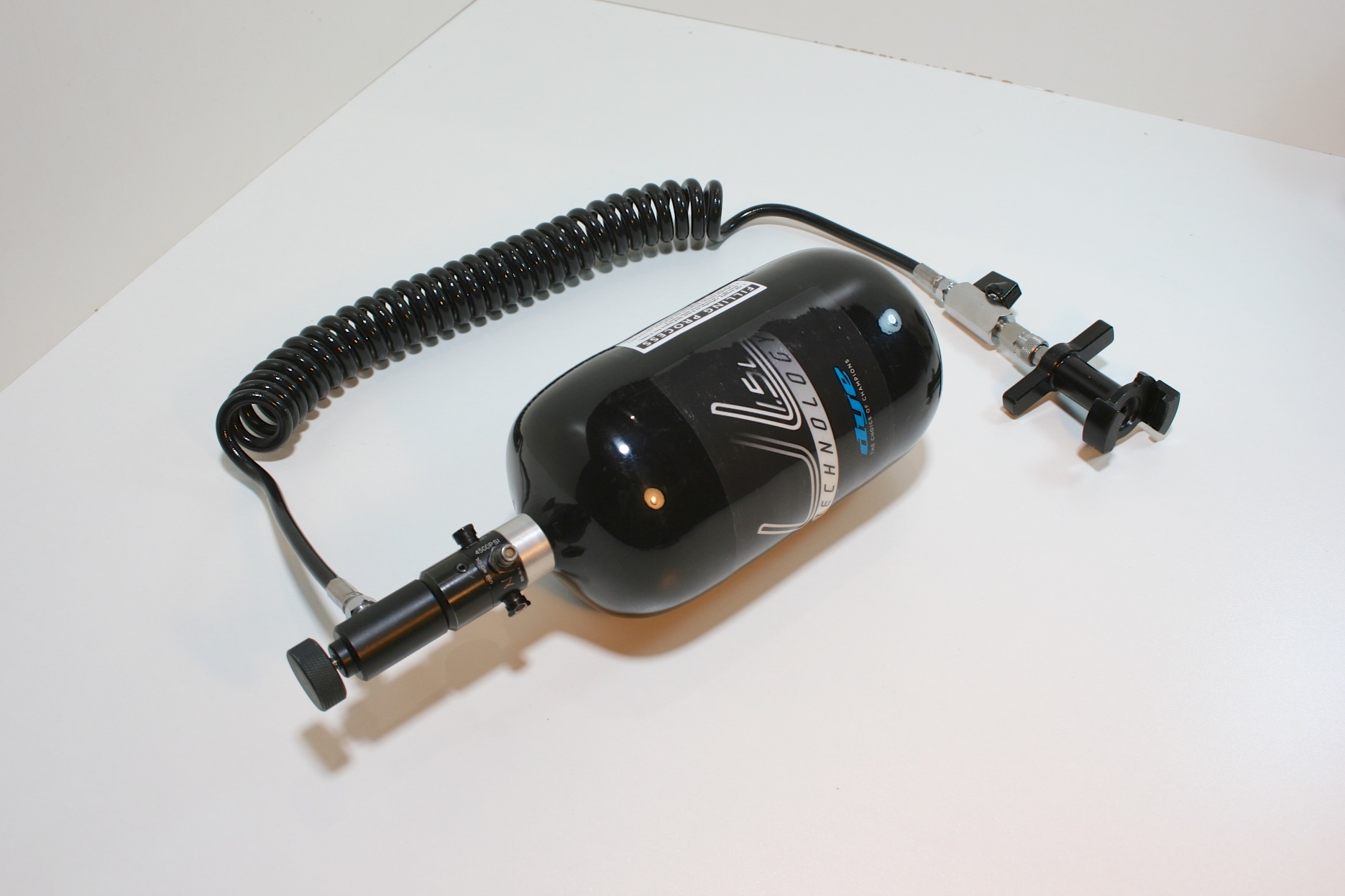

Scuba bottles and classic valves and hoses are big and bulky.
I have a 1.6l paintball carbon bottle, 300bar, it has a regulator with 55bar, perfect for the Yak. And a light flexible hose. Wheighs less than 2kg alltogether , fills my Yak weekly.
If I need more air I use a 6.8l 300bar cfk bottle with that 55bar regulator. Bottle is 3.6kg plus 1kg of air and hose.
No bulky equipment, has enough air even for the annual (gear up/down...)
And the small bottle fits into a bagback and can go on weekend flights.
I also have a small 300bar compressor to fill the tanks by myself, so I do not have to carry a steel bottle to a scuba shop.
If you are in the EU, contact me if you cannot get these parts, I have some brand new spares and compressors.

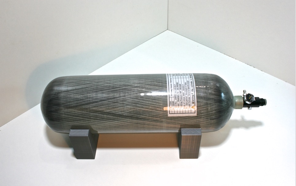

Bigger bottles and the Yak air adapter are specials parts.
I use a 6.8l composite (only 3.6kg) and a std 200bar steel scuba bottle, but the steel bottles are too heavy. Only advantage: they are cheap.
The regulator not only saves weight and space compared to a scuba valve, it fits perfectly to the light hose and 750psi for the Yak.
Even the 6.8l bottle with hose and all parts fit into a bag.
Picture shows 6.8l CFK bottle
