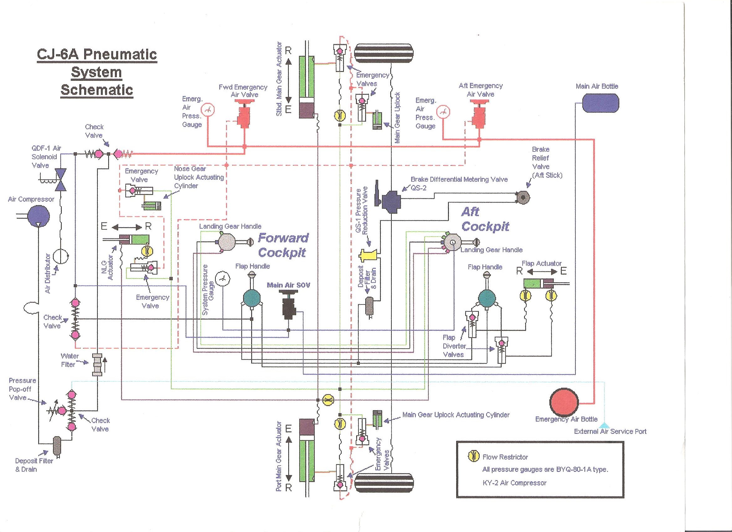

PostPosted: Sat May 06, 2017 8:38 pm    Post subject: Emergency air leaks down Reply with quote
Hi Jon;
A few years back one of our more industrious members (whose name, I'm sorry
to say, escapes me) drew up a really excellent schematic of the CJ pneumatic
system.
I will attach a copy in case you do not have it.
Note there are two distinct parts of the emergency system: 1. Charging /
Storage (solid red) and 2. Operation (dashed red). From your description
I would suspect the problem is in part 1.
If you have not converted the control valves to Doug's stainless steel cones
one (or both) valves could be leaking internally to the operation side.
Other possibilities
are:----- Pin hole in tank wall or pipeline due to corrosion: Poor
connection to either pressure guage; Charge line check valve leak (the one
described by Ernie) also possibly internal.
If you have access to an ultrasonic leak detector that is probably the best
way to pin it down.
Walt
