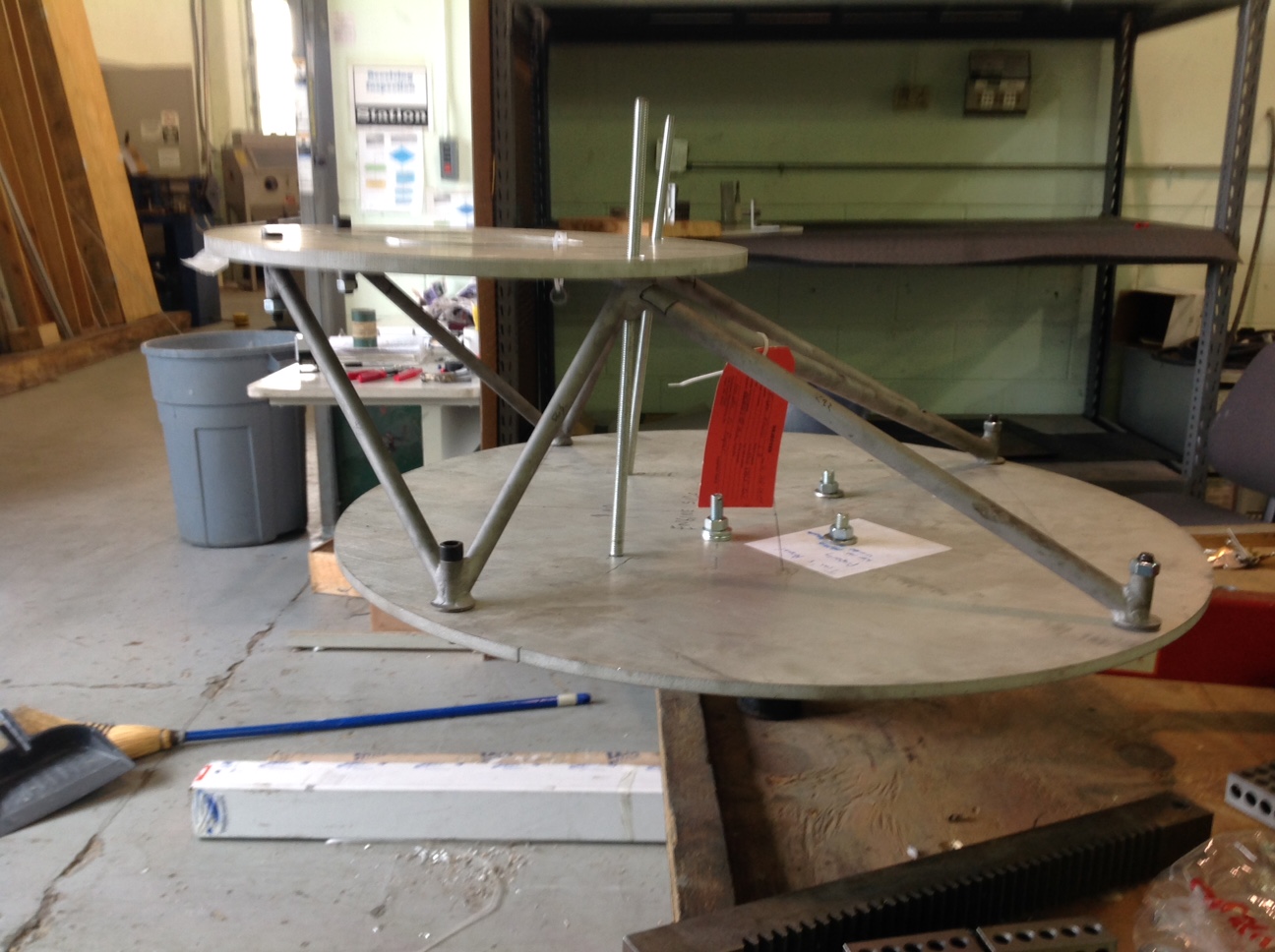

2. What we did, (and what you could do) is to take a good TR-1 mount and transfer drill it into tooling plate (see the attachment photo). You will have to fixture the distance from the firewall to each engine mount (X,Y and Z dimensions). Then using ultrasound (or destroy the mount by cutting the tubes) find the diameter and wall thickness of the 4130 tube.

Here is the weld tool for the motor mount. The round base plate is the aircraft firewall and the top part is the engine mounts. All thread sets each mount location and in turn the thrust angle.
