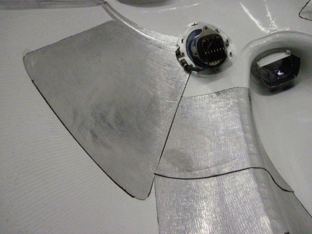

I used the adhesive reflective stuff you can purchase from ACS. 600 hours and no issues. Photo below
