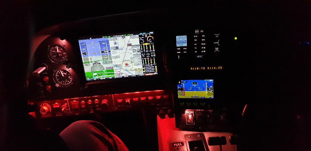

I had to add a flap position indicator that I could see at night too, so I added the one in the attached picture. It works like a dream and drives the flap input on the Skyview system.

Here's the night view of the cockpit.

I fitted a flap sensor as I need to be able to tell their position at night. You'll probably not require that for a monowheel.
