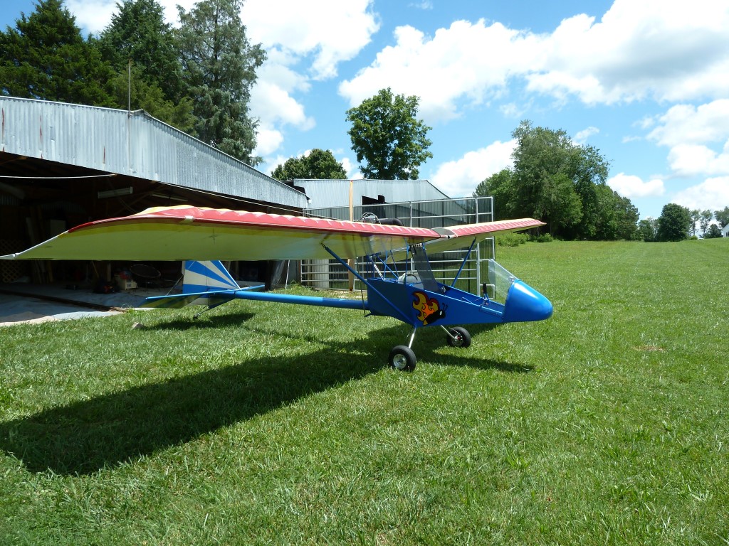

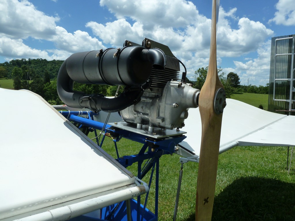

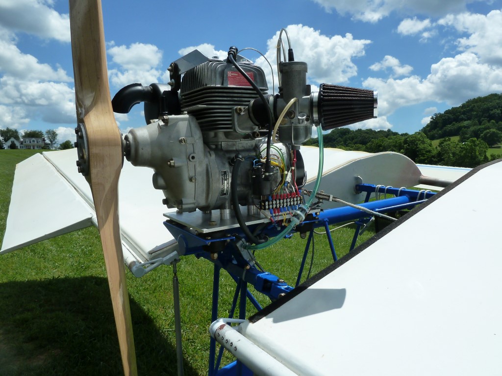

I am pretty familiar with the Rotax 277, I used to have a Maxair Hummer with a 277, I put 750 hours on it, and it was smoother than this one is. Also, we have two props, and we balanced both of them before running the engine. We broke the engine in with the tractor, it was a 60 x 28 Tennessee prop, then took it off and switched to a 60 x 30 Arrowprop pusher, but it vibrated a lot worse and also over revved to 7,000. Go figure. I guess one man's 28" pitch and another man's 30" pitch don't necessarily have anything in common.
Anyway, we put it together today and measured for the gap seal and a few other details, here are some pictures. Ordered a 20' endoscope that will fit the usb port on the laptop, next week we inspect the inside of the wings and if all looks good we repaint them. If it doesn't look good we recover them.

I don't think the props are the problem. We have two props, and we balanced both of them before running the engine. We broke the engine in with the tractor, it was a 60 x 28 Tennessee prop, then took it off and switched to a 60 x 30 Arrowprop pusher, but it vibrated a lot worse and also over revved to 7,000. Go figure. I guess one man's 28" pitch and another man's 30" pitch don't necessarily have anything in common.

[quote] ="gdhelton(at)gmail.com" Nice pictures. And I know this may sound like less then intelligent question but, you said the props were both balanced so you might check the prop tracking tip to tip and you might put a dial indicator on the actual gearbox hub and check how much runout you have? <snip>
George H.
Firestar, #FS100
14GDH
Mesick, Michigan
Have a great day! [quote]
Very true. And the Arrowprop did have too much runout, it would have needed to be shimmed. So yes, very much a factor in the vibration. But it has become a moot point; The Arrowprop revved to 7,000 (And it was sold with a 503 as part of a 2 seat Drifter kit ?!?!?) so we couldn't use it anyway. I ordered a new two blade 62" Ivoprop this afternoon. They said it will show up in 5 weeks, which gives us time to do a meticulous job of inspecting inside the wings and repainting them, and for me to spend some time riding the back roads on my NX 250. (Best ride I've ever had, and I've had quite a few)
