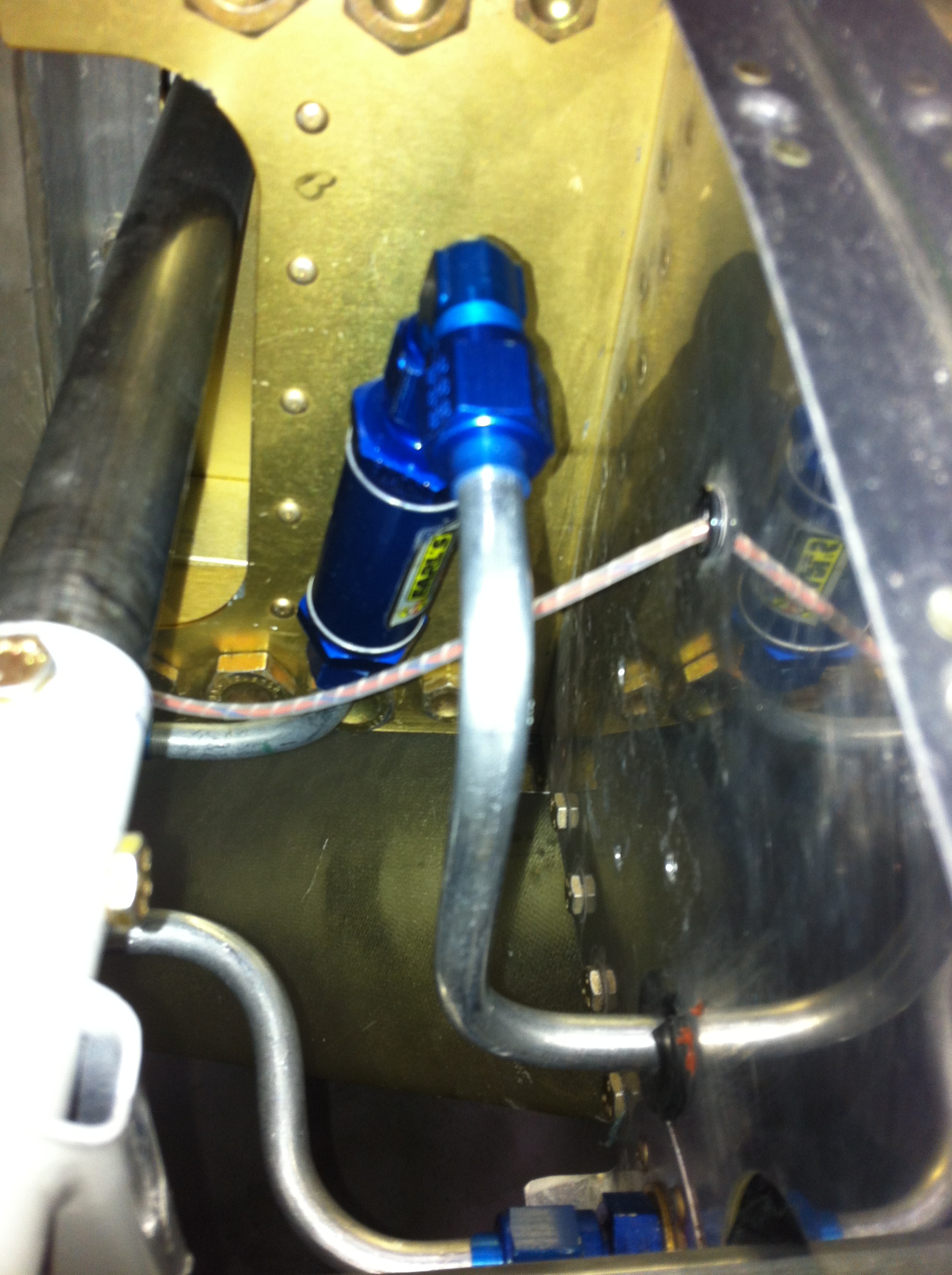

Hi
I have had a few PMs asking for pix of my wing root fuel filters. See the pix below.
Also, here is a link to the filters I used: https://www.summitracing.com/int/parts/ear-230206erl/overview/
There is one in each wing root so that there is redundancy. Also, as the filters are light, I didn't tie them off to anything else. They seem quite happy inline with the -6 al tubing.
Cheers
Les
C-GCWZ flying
C-GROK some assembly required.

PostPosted: Mon Jun 12, 2017 10:19 am    Post subject: Wing Root Fuel Filters Reply with quote
Thank you Les
Nice spot, as you said much easier to access.
I'm wondering to change mine
Dilson

PostPosted: Mon Jun 12, 2017 11:26 am    Post subject: Wing Root Fuel Filters Reply with quote
I would just be worried of vibrations over long term.
My thoughts

PostPosted: Mon Jun 12, 2017 12:43 pm    Post subject: Re: Wing Root Fuel Filters Reply with quote
Hi
The vibration question is one that I considered. The filter is very light and so weight is not really a factor. The bends in the tubing allow movement so that should be okay. Between the B-Nut / filter / B-Nut there is nothing for vibration to affect.
I don't really see how the filter is that much different from an install without the filter. At least from a vibration perspective.

PostPosted: Mon Jun 12, 2017 12:50 pm    Post subject: Wing Root Fuel Filters Reply with quote
My filter is in the tunnel, plumbed and sealed.  There hasn't been any fuel or contamination in it (still building).  I don't think it's wise to remove it and possibly alter the integrity of the system.  I'll just add the filters in the wing root and know I have a second filter for fuel to pass through.
Linn

PostPosted: Mon Jun 12, 2017 1:01 pm    Post subject: Wing Root Fuel Filters Reply with quote
I think I'm going to do this exact thing during my condition inspection in September.

PostPosted: Mon Jun 12, 2017 1:04 pm    Post subject: Wing Root Fuel Filters Reply with quote
Les,what was the reasoning for going with the 85 micron vs the 35 micron?

PostPosted: Mon Jun 12, 2017 1:22 pm    Post subject: Wing Root Fuel Filters Reply with quote
Did you weigh the fuel filters empty or with fuel in them?

PostPosted: Mon Jun 12, 2017 4:40 pm    Post subject: Wing Root Fuel Filters Reply with quote
The original installation has the filter clamped to the floor.

PostPosted: Mon Jun 12, 2017 6:07 pm    Post subject: Re: Wing Root Fuel Filters Reply with quote
Shannon
I used the wrong ling link in my earlier post. I do use the 35 micron filters. The correct link is:
https://www.summitracing.com/int/parts/ear-230106erl/overview/

PostPosted: Mon Jun 12, 2017 6:13 pm    Post subject: Re: Wing Root Fuel Filters Reply with quote
Albert
You are quite right about the original location and the filters being attached to the floor.
All I can say is the filters / location / setup works for me. The tunnel location is difficult to access while the roots are easy to access. That makes more frequent checks / cleaning easier and therefore (IMHO) more likely.
Obviously I like my setup, otherwise I wouldn't do it this way. Others may not.
