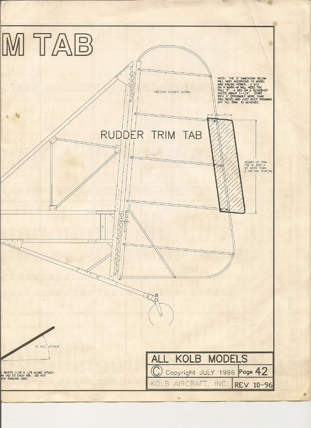

Kolbers,,,,,,  I remember a few years back that someone mentioned that they trimmed a Kolb by adjusting the thrust line of the engine by raising or lowering the front or back of the motor mounts.   I haven't found the correct search term to find it in the archives..  Is there anyone that is still on the list  who can shed some light?
Boyd   mkiii Utah

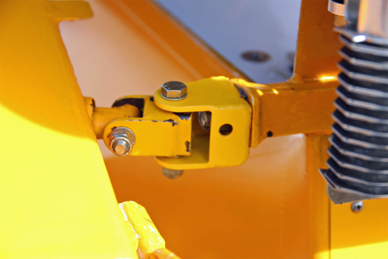

Here are pictures of the Kolbra U-joint adjust for roll control. Put washers in on top or bottom for whichever the way you want to correct the roll.
Ralph B

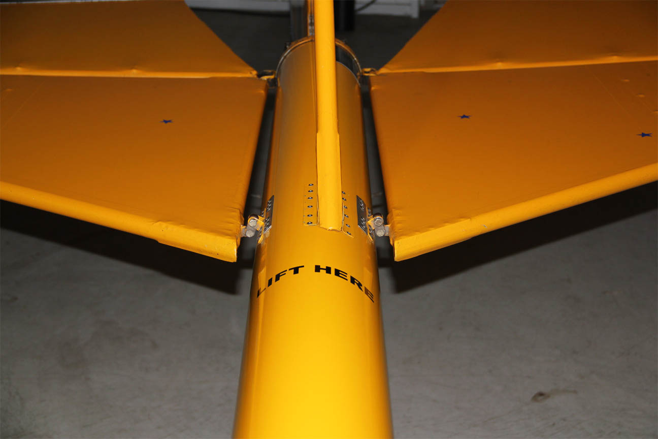

Along with the U-joints, there is also the offset fin. This was installed by the builder and I don't see how I would do without it. I've also included a picture of the adjustable rudder trim tab. Between the U-joints, offset fin, and rudder trim tab, the Kolbra can fly hands off in calm air. For pitch trim, the builder installed a motorized bungee windup to move the stick forward or aft. It is controlled with a toggle switch for nose up or down trim.

I failed to mention the Kolbra fin offset was built that way due to the powerful 912 engine that spins in the opposite direction of a 2-stroke engine. From the rear of the airplane, it spins in a counterclockwise direction whereas a 2-stroke will spin in a clockwise direction. This makes a difference in how the airplane is trimmed out. When I upgraded to the 912uls 100hp engine, I was very happy to have that offset built in as the rudder trim tab would not have been able to hold it without using constant rudder on the pedals. Even then, the airplane would have been flying in a constant yawed condition which I didn't like. On takeoff, I use right rudder to counteract P-factor. If the Kolbra had a 2-stroke engine, it would be the opposite left rudder like in a Firestar. May I also say that wind conditions can fool you when making adjustments. On the ground, a crosswind or heavy tailwind can make the airplane difficult to maneuver. Even in the air, a good crosswind will make you hold right or left stick sometimes, so I would say to make all your trim adjustments in calm air conditions.
The original post said his airplane rolled to the left and needed right stick to counteract the roll. If the airplane is rigged properly, this happens due to the torque of the 912 engine and why the fin offset was built into my Kolbra. The same will happen for a Mark III with a 912 engine. This problem has been discussed before and a rudder trim tab will correct some of the problem, but I think the real solution is the offset fin as seen in the above pictures.

finally discovered solved the yaw problem.
The reason I didn't want to experiment on my MKIII was because I didn't want
to drill a bunch of holes and screw up my airplane. I had already made a
17,200 mile flight with the slip/skid ball yawed a half ball out, and got
tired of looking at it. My MKIII flew great this way, but it just wasn't
right.
I started out by offsetting the leading edge by 1/2". No observable change.
Drilled out the SS rivets and tried 1". Very slight change. Finally I got
it pushed over to 1.5" with hardly any difference. Not worth all the
effort. On the down side, doing it my way was actually twisting the tail
post and bending the leading edge tube of the upper vertical stabilizer
which eventually failed. Big job repairing this. When I did I went back to
centering the upper vertical stabilizer the way it should be.
Then I decided to experiment with the rudder trim tab. I chose to go big
and built the first one three rib bays long. Wow! That was an overkill.
Since I had attached with duct tape, I snatched it off, cut off a third (one
rib bay), stuck it back on and discovered it was perfect. Slip/skid ball
centered with my feet on the deck. Wink
I think Mark German modified the tail post on his Kolbra after he saw mine
and talked with me. Cannot remember for sure.
There is no need to offset the upper vertical stabilizer because an adequate
rudder trim tab solves the yaw problem. A much simpler and effective
solution.
Direction of prop rotation and HP did not make much difference to the yaw
problem. I had it with 65, 80, and 100 hp on my MKIII.
John h
