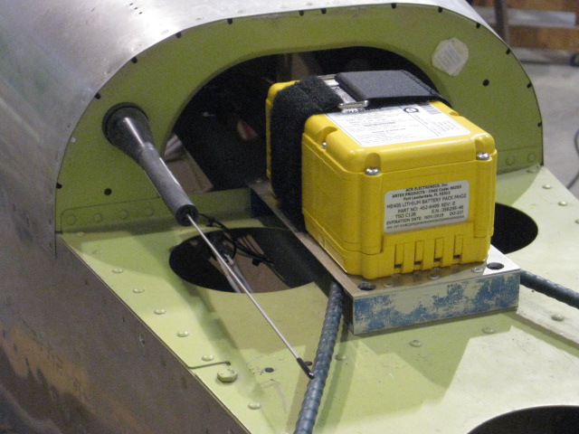

I mounted my ELT on a raised floor over the trim cables, just aft of the bulkhead.  The antenna is mounted on that bulkhead pointing aft so it's under the fiberglass fairing.
Linn
[img]cid:part1.99089C49.8700FF18(at)cfl.rr.com[/img]

The real reason I put it there was aesthetics.
I didn't want the antenna on the exterior and it seemed like a good place.

flying-nut(at)cfl.rr.com
PostPosted: Wed Jun 14, 2017 7:20 am    Post subject: ELT and ELT antenna placement Reply with quote
See below .....
On 6/14/2017 10:56 AM, Patrick Thyssen wrote:
My question is, aren't elt antennas a transmitting antenna, just like your com antenna?
Other than the fact that they are vertically polarized their function is
different. You hope to never use the ELT antenna but you hope to use
you com antennas a lot. Since the new 406 Mhz. ELTs are using
satellites for receptions ..... vastly different for the ground-based
121.5 ELTs .... mounting the antenna on it's side (if it stays that way
after impact) provides a much better signal for the satellite.
If so why are you not putting your com antennas inside of plane, tail cone, engine compartment.
Some do. Search for Archer antennas. Mostly mounted inside fiberglass
wingtips.
Most elt antenna are flexible not rigid have not seen them torn off unless flipped and since we have vertical stab chances are slim that happening.
The FAA has come out with a SB (I think) on ELTs that are mounted with a
velcro strap to prevent them from coming loose in severe deceleration
.... because the have become disconnected from the antenna.
I'm still asking these questions and no one has answered them for me.
I hope this helps. Remember that a round rod has more drag than most
other shapes like airfoils. Also, in my mind the crashes severe enough
to cause concern over antenna orientation/connection only need the
antenna for searchers to find the remains. My 406 ELT only came with a
whip so I velcro'd a rubber ducky antenna to to ELT to use it as a
portable. I also plan on carrying a PLB. Many options are available to
help rescuers find you.
