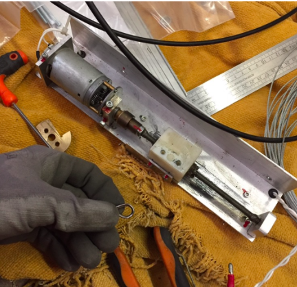

Yes in respons to pilot input.
Little input didn't run the motor, a bit large input pass through the value desired. (no possible to adjust it precisely) but maybe it's not the fault of the relay. More in the trim system made with a spring, which can increase the imprecision, taking into account your response.
If all system are made with this kind of relay or close to, I will think about all system before looking on the electrical part so.
(photo not very important helpful but a least we can see the motor)

If I understand correctly, it is difficult to adjust the desired trim position because pressing the switch either does not run the motor long enough or else it runs too long and overshoots.
More precise control can be achieved by using a lower voltage to run the motor. But the motor may fail to start if operated with a lower voltage. The solution may be to operate the motor with a PWM (pulse width modulated) voltage. The type of relay used has little affect on the trim speed or travel.
