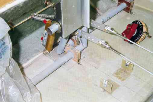

PostPosted: Mon Jul 10, 2017 3:54 am    Post subject: Matco Brake assembly for KIS TR1 Reply with quote
On the subject of access to the brake master cylinders , I installed an
access panel in the underside of the fuselage , makes getting to the various
bolts and tubes , much easier
(See attached file: Dscf0225.jpg)

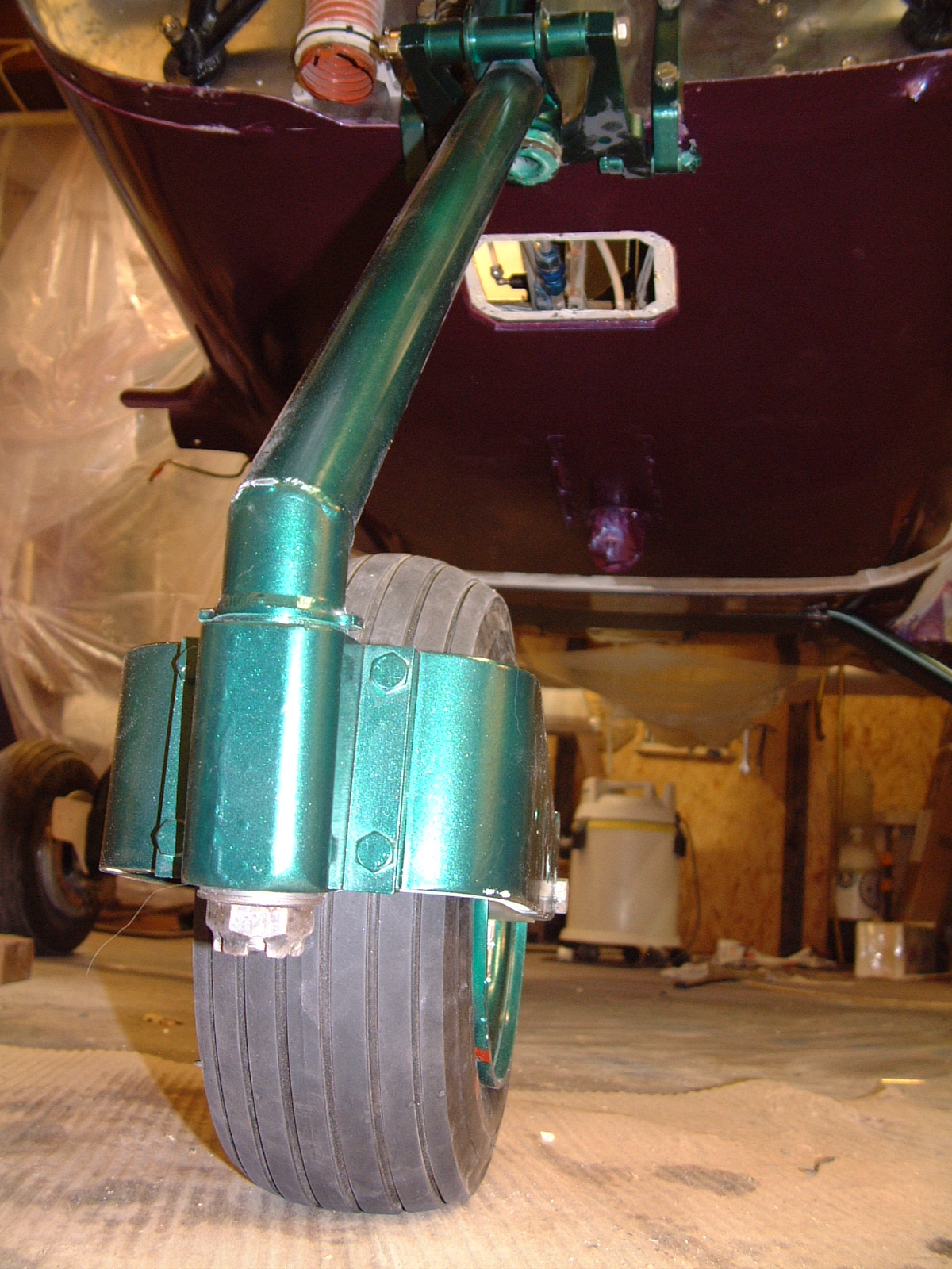

Installing Grove parts will require extensive removal of metal from KIS
landing gear legs at the bottom.
      Would Grove wheels, calipers, brake pads and rotors work with the
      existing Matco master cylinders?
Yes, but see immediately above.

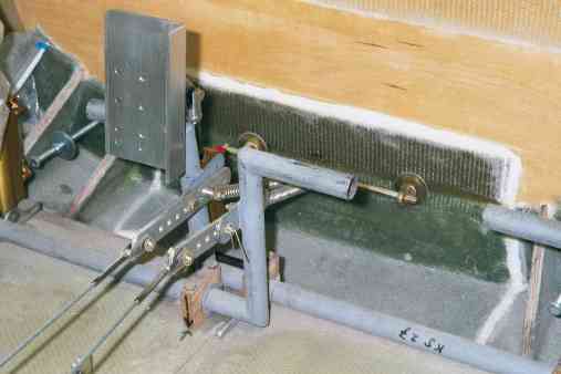

Hello Rob, You wrote: “I know that the geometry etc is a problem, but I can
handle that ok.”
And I wrote: “If you still have the original kit provided pedals I don't
agree.”
See the two attached pictures to see how I solved the pedal problem. I
riveted two rather large pieces of aluminum angel to the front of the
original pedals. This provides a significant improvement in pedal leverage
and the resulting higher brake fluid pressure at the wheels.
The side angles make a perfect place to keep the outside edge of both shoes
against so that you know where your feet are with regard to the brake /
rudder pedals at all times.
OC
PS: I have had people in the left seat of my plane (only side that has
brakes) and when the engine started the plane just spun around like a top
with all left brake and no right brake. They had made the mistaken
assumption the pedals had to be straight ahead of the seat and just plunked
their feet down accordingly. The KIS TR-1 pedals however are not directly in
front of the seats, but instead are offset a bit toward the airplane center
line. This offset is caused by the cross rudder pedal bars being too short.
