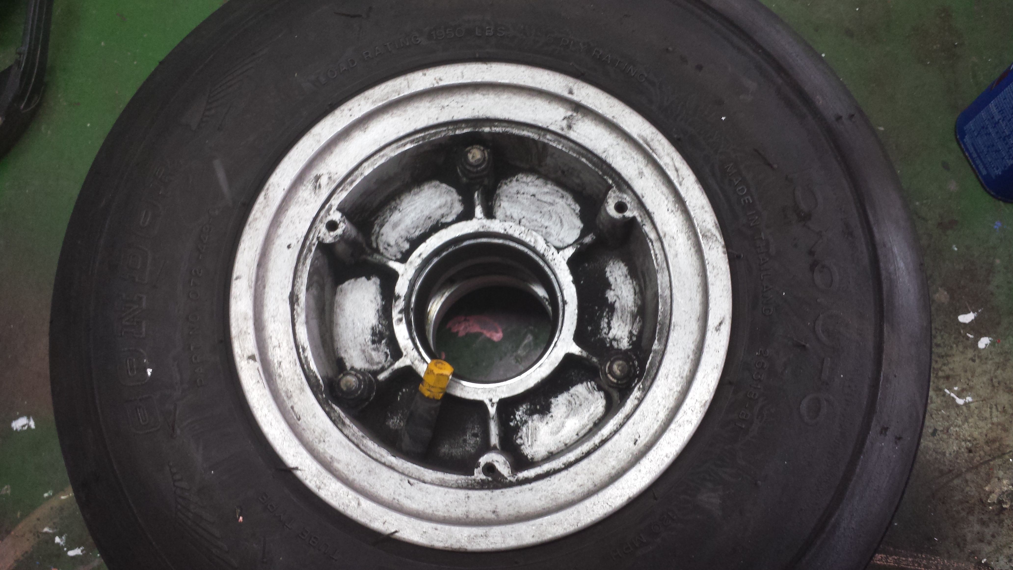

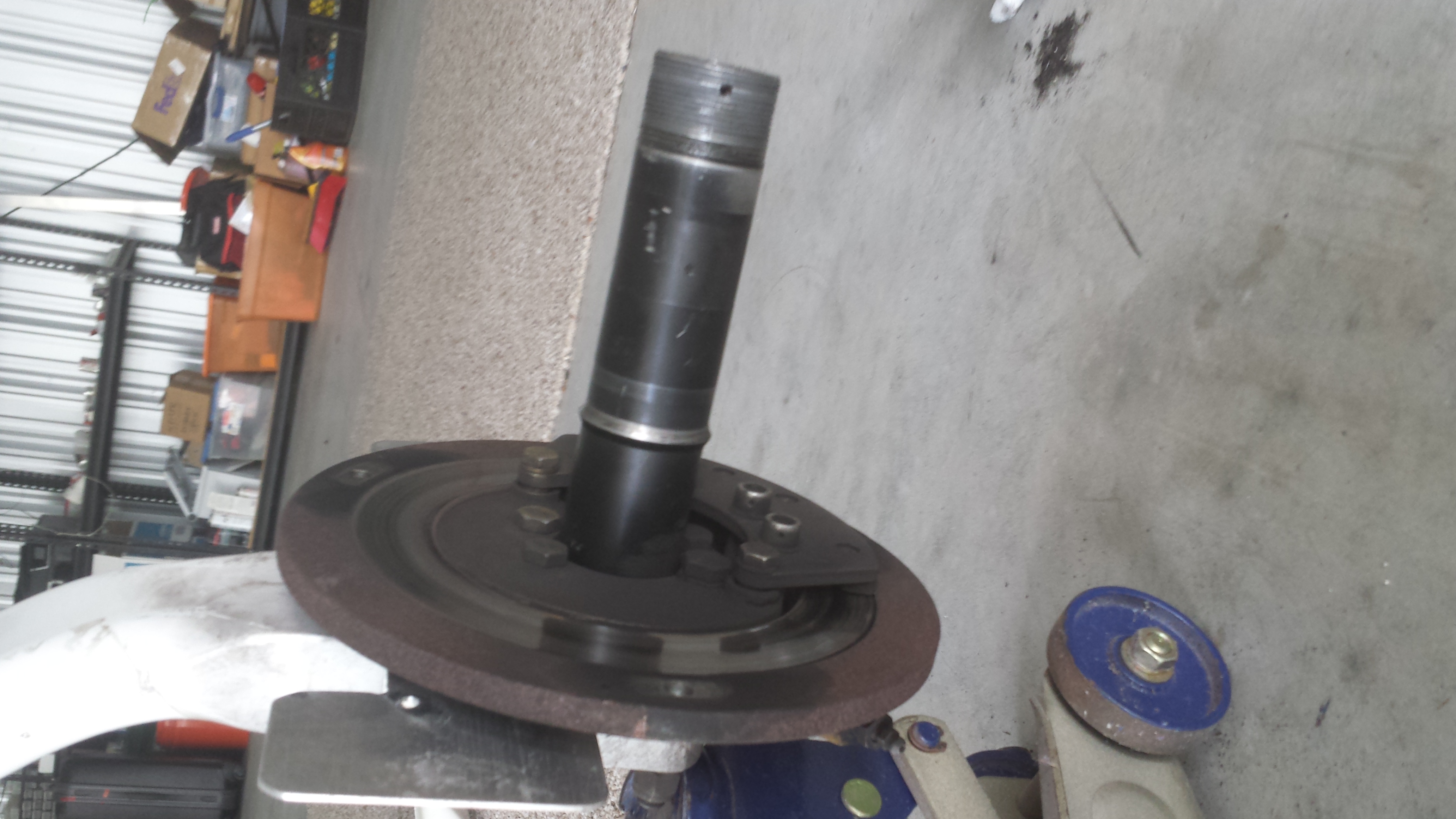

Who manufactured (and model number) the main landing gear wheel assembly for the TR4? It is for a 15X6.00-6 tire. I think it was MATCO but not sure. One of my bearing race is turning on mine and I have some wear on the axle so I may want to replace it.
THANKS!

PostPosted: Sat Jul 01, 2017 11:28 am    Post subject: TR-4 Main Landing Gear Wheel Assembly Reply with quote
Galin
The specifications indicate Marco wheels and brakes. Pretty sure that is what are on mine.

PostPosted: Sat Jul 01, 2017 12:28 pm    Post subject: TR-4 Main Landing Gear Wheel Assembly Reply with quote
It was Matco, I am away from my documentation , but I think it was there 6” wheel, the number W-600 sticks in my mind.

PostPosted: Sat Jul 01, 2017 12:41 pm    Post subject: TR-4 Main Landing Gear Wheel Assembly Reply with quote
Found a folder, it is the W600 wheel assembly, so get the axle for that

PostPosted: Sat Jul 01, 2017 1:45 pm    Post subject: TR-4 Main Landing Gear Wheel Assembly Reply with quote
That is what I thought but wanted to make sure others had the same wheels.

PostPosted: Sat Jul 01, 2017 8:26 pm    Post subject: TR-4 Main Landing Gear Wheel Assembly Reply with quote
Galin
When I first started taxi tests, I had ‘severe’ lack of stopping power. Couldn’t taxi and steer the airplane. We ‘wore in’ the pads by pulling the plane and riding the brakes, and it became somewhat better but not good enough.
I eventually contacted Matco, when one of my rotors developed a crack, and they had a new owner, and had made some changes from the hardware supplied by KIS. They changed the rotor from a cast material to a machined tool steel. The cast iron has graphite inclusions, which don’t lead to great breaking. I think by your photo that you have the original, since the machined rotors have some surface grooves in them. Might want to talk to them.

PostPosted: Sun Jul 02, 2017 5:49 am    Post subject: TR-4 Main Landing Gear Wheel Assembly Reply with quote
The replacement rotor was tool steel, and they had different pads too, I suggest calling them directly.
