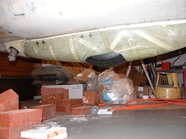

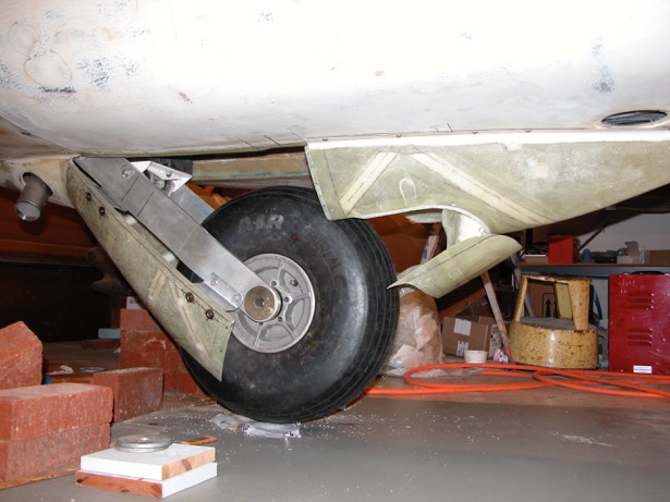

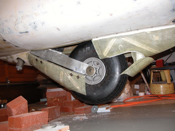

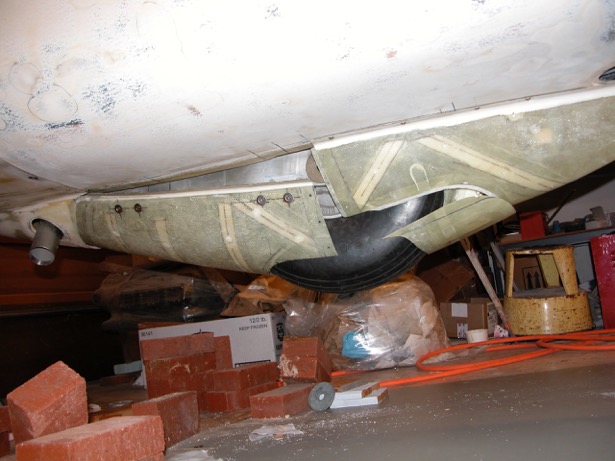

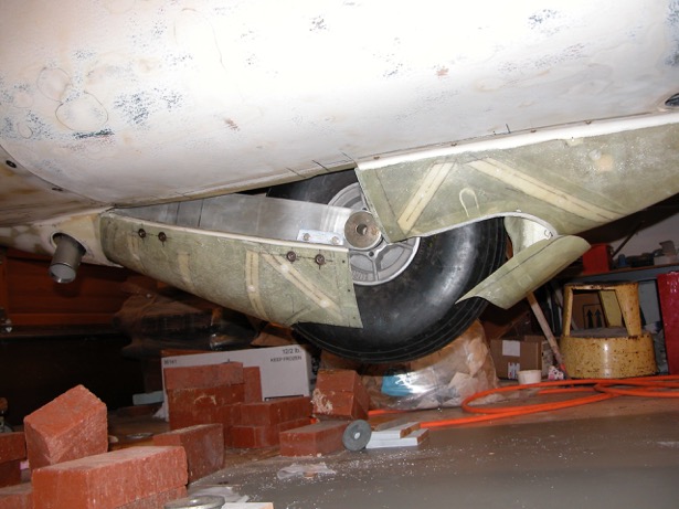

Ross…try this on for size:
[img]cid:0BB7BA4E-0AEF-4D11-9D27-51ED26E70F16(at)Home[/img][img]cid:A3C4AF95-91E1-4210-A51E-F145EE5FD873(at)Home[/img][img]cid:6B9CE273-A366-46D7-9347-6E9B482BC455(at)Home[/img][img]cid:4A446CB5-C19E-4576-9151-D93D66489C9D(at)Home[/img][img]cid:FBF1A410-4001-499C-B0E3-DAB156EED864(at)Home[/img]

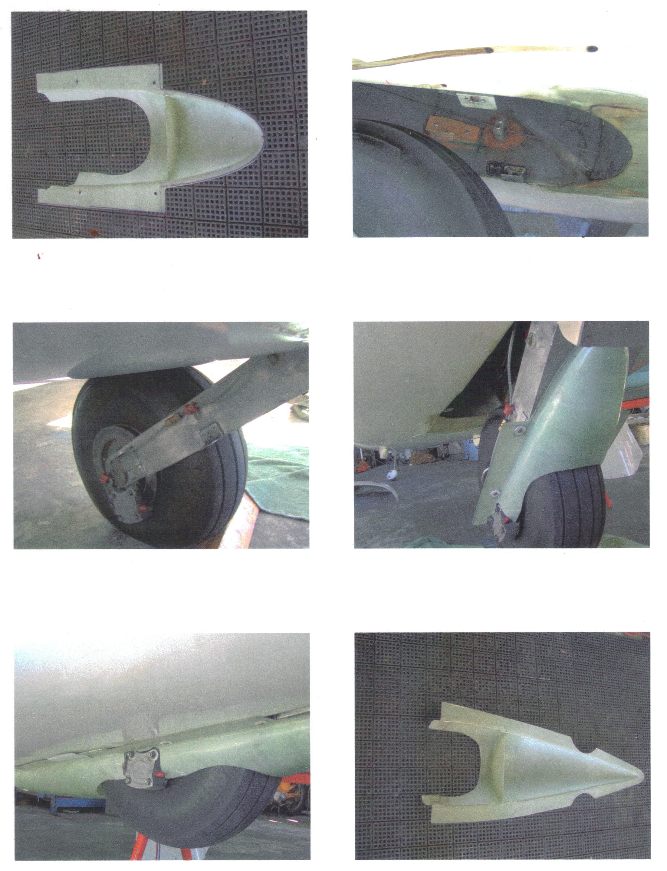

Here are a set of photos of Kim Prout's fairing that we have on our XS mono wheel.
Jim & Heather
